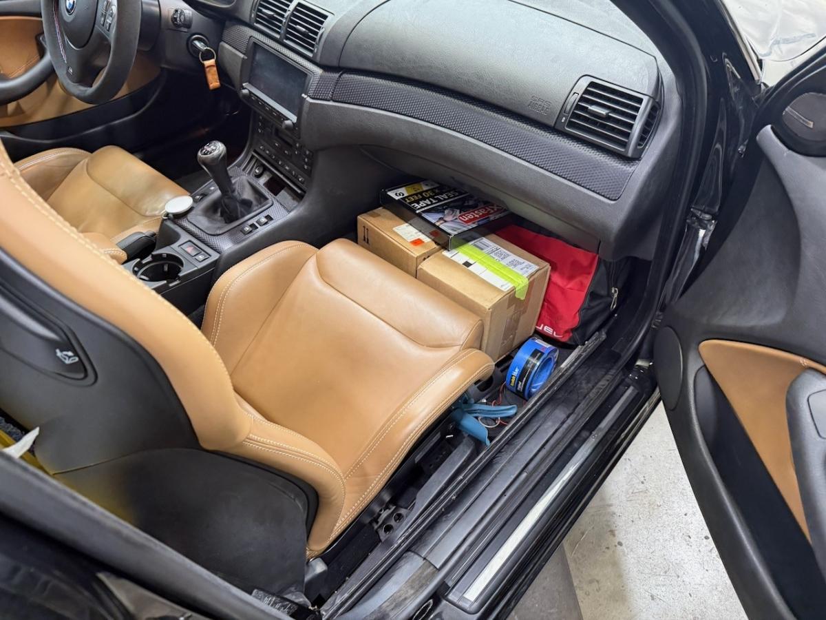

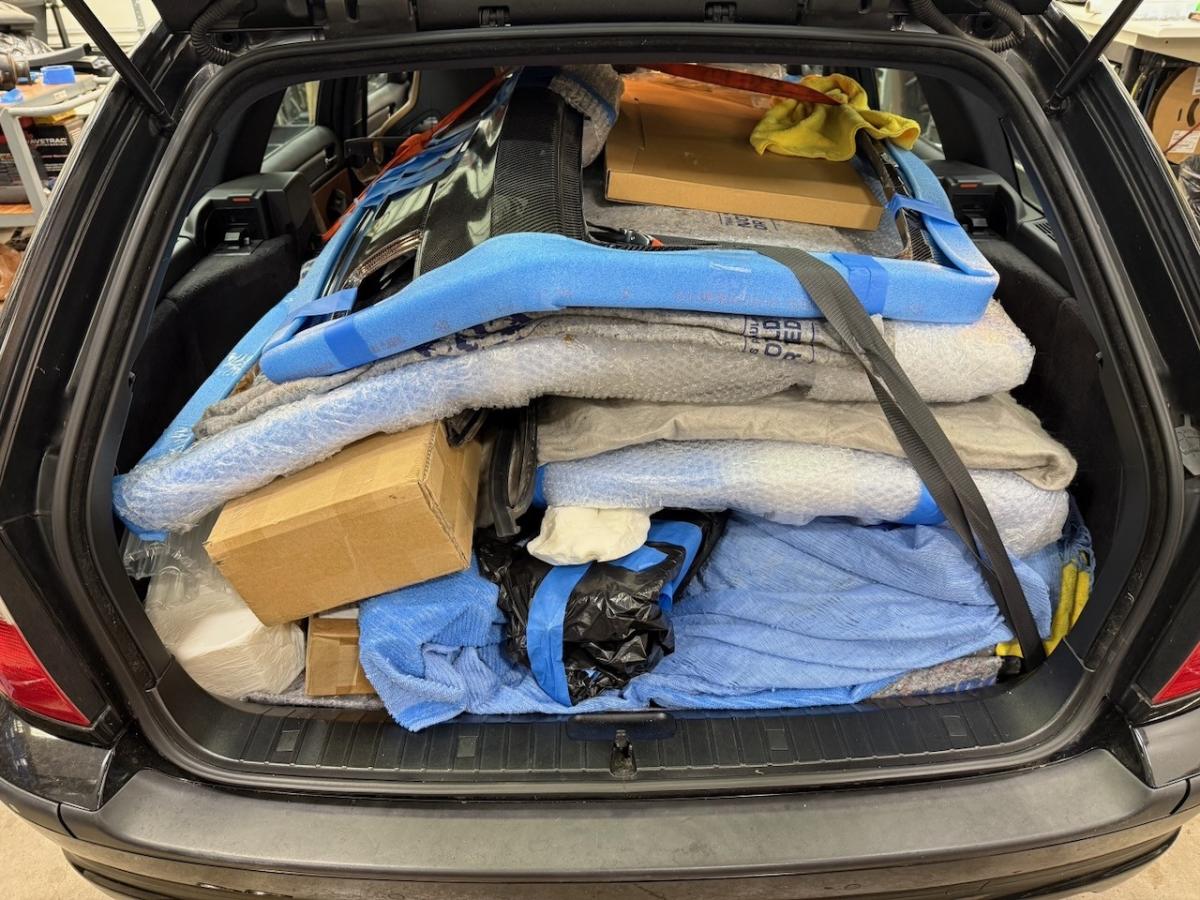

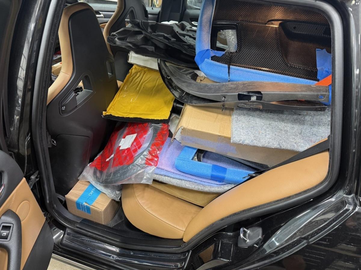

                    Alright, here we go! George has given me notes (mostly on the AC - Texas and all) and managed to pack up the car with a stock muffler, section 2, pair of front doors, rear hatch and various tools and parts while still leaving the front two seats free and clear.

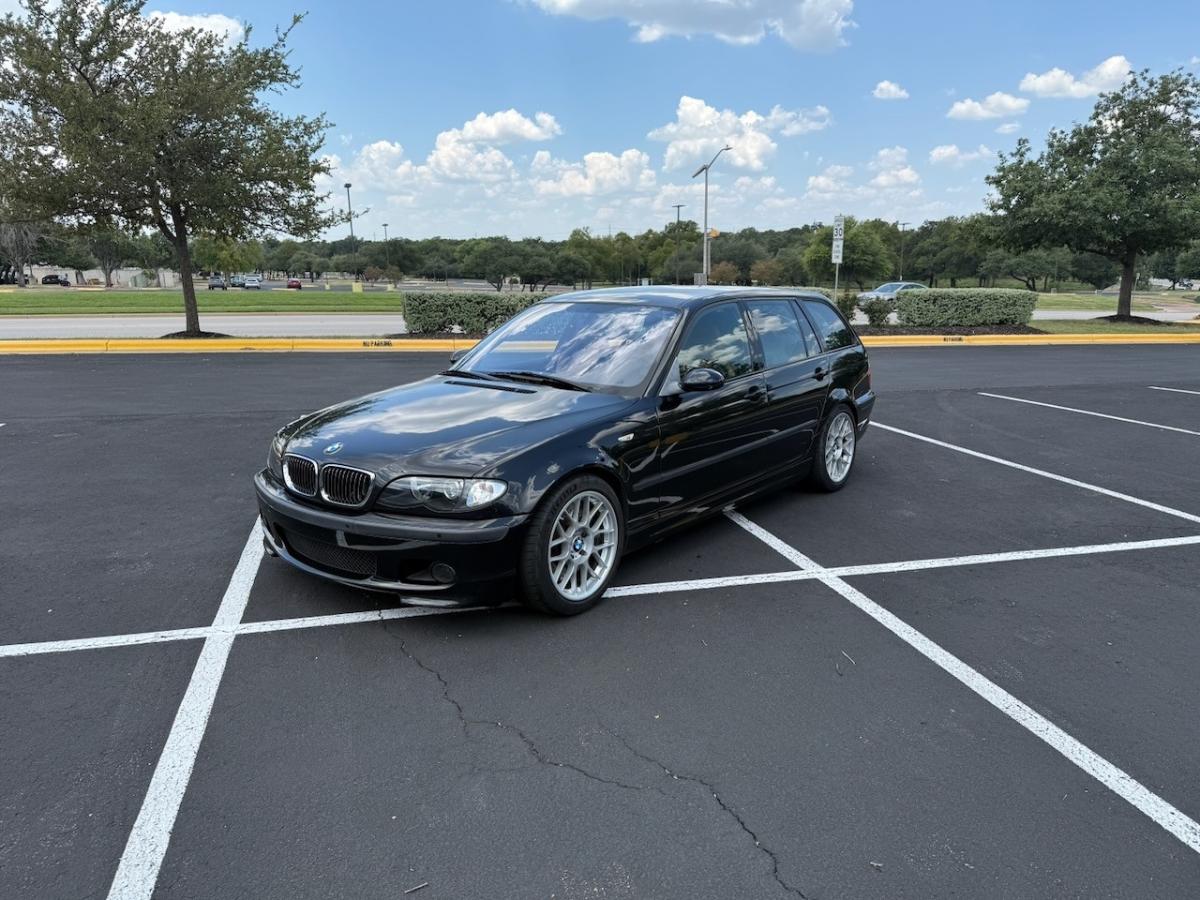

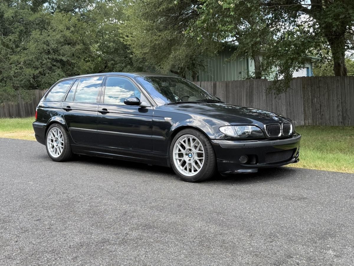

                    And after a nice wash it looks surprisingly good in the Texas sun/clouds

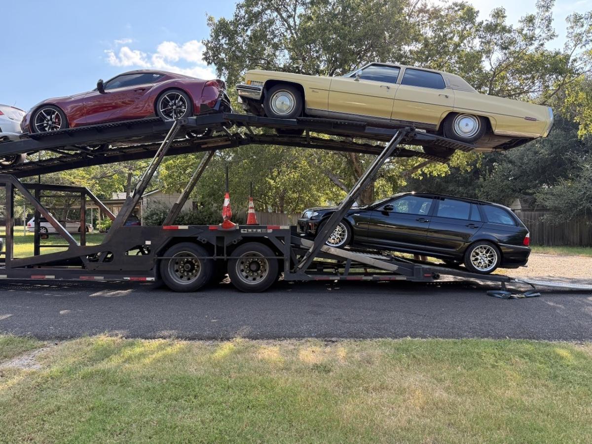

                    And last, after some fun back and forth with shippers, we got the car loaded up and it's now on its way back home. Thanks again to George, can't wait to put it through its paces once again!

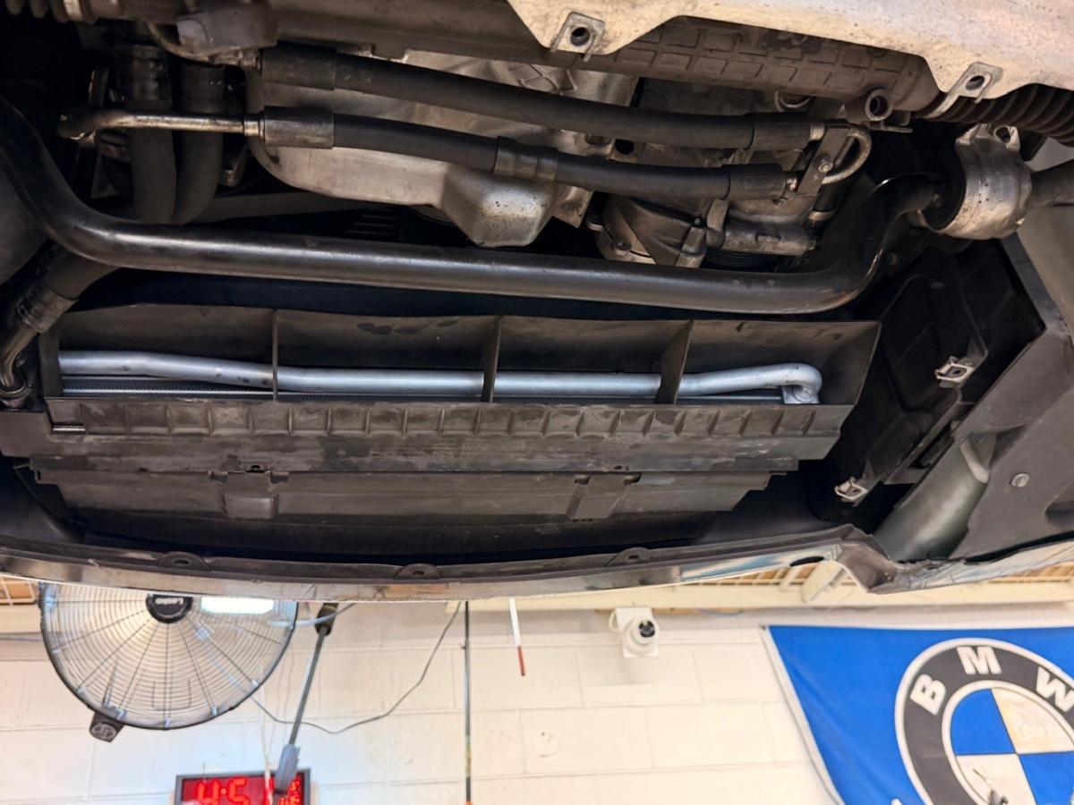

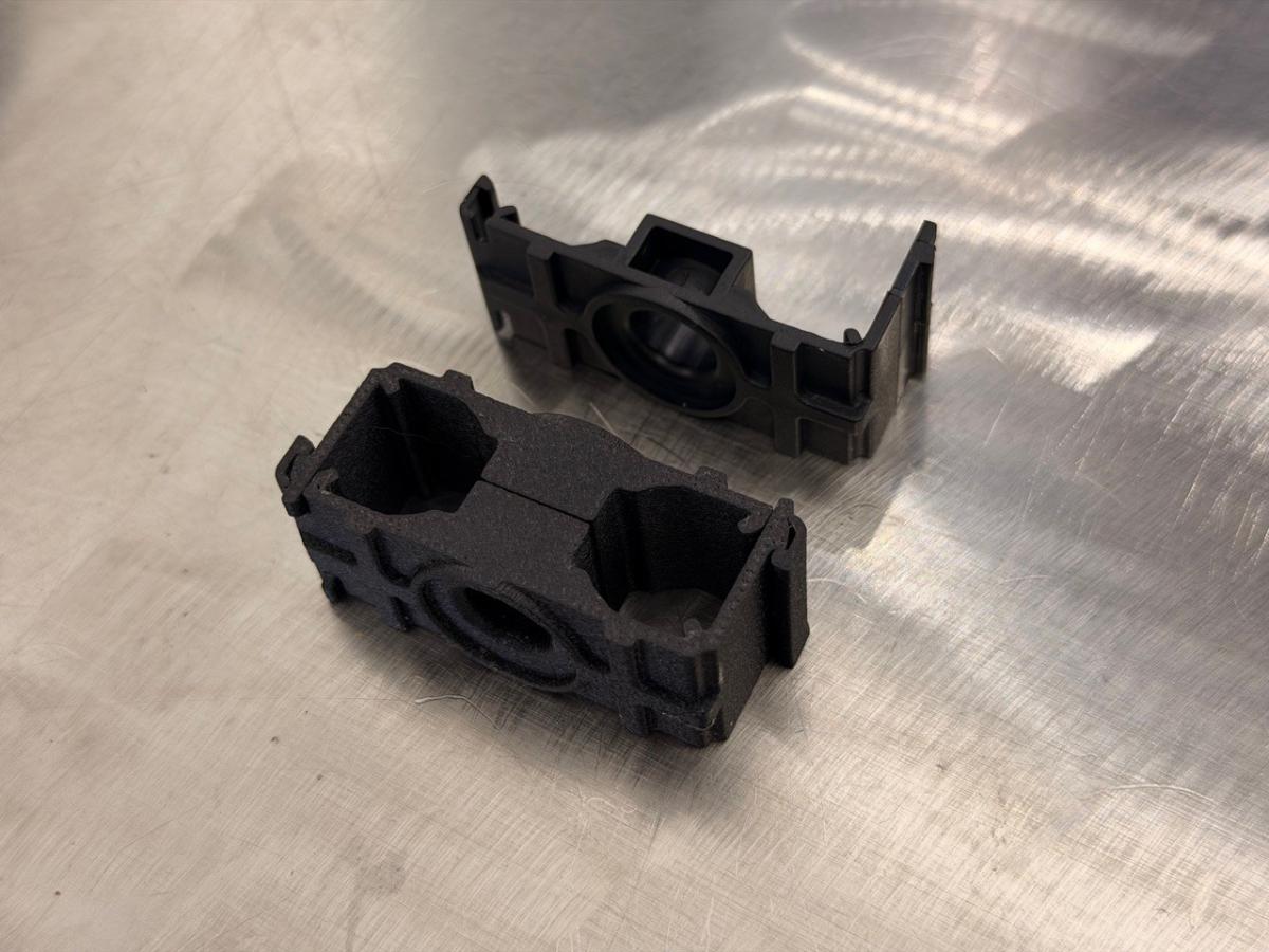

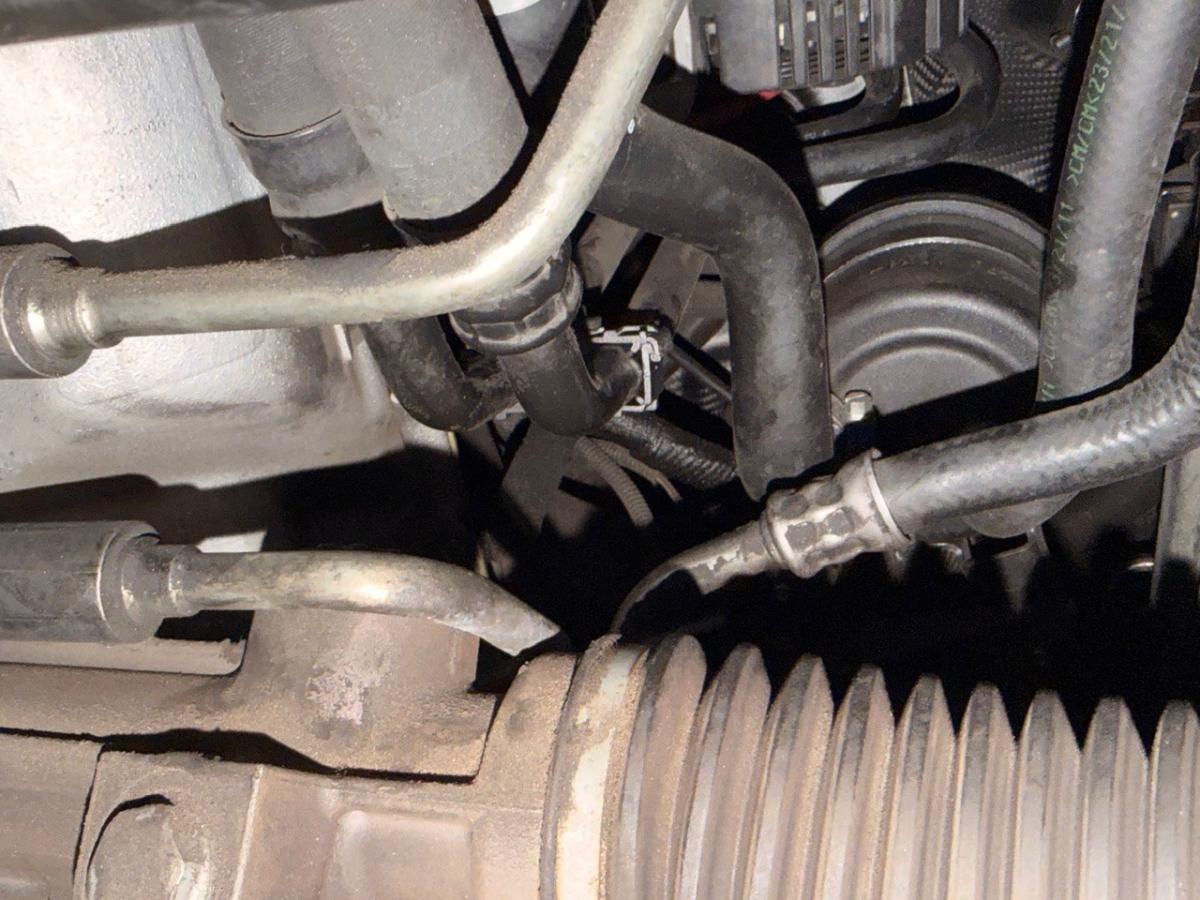

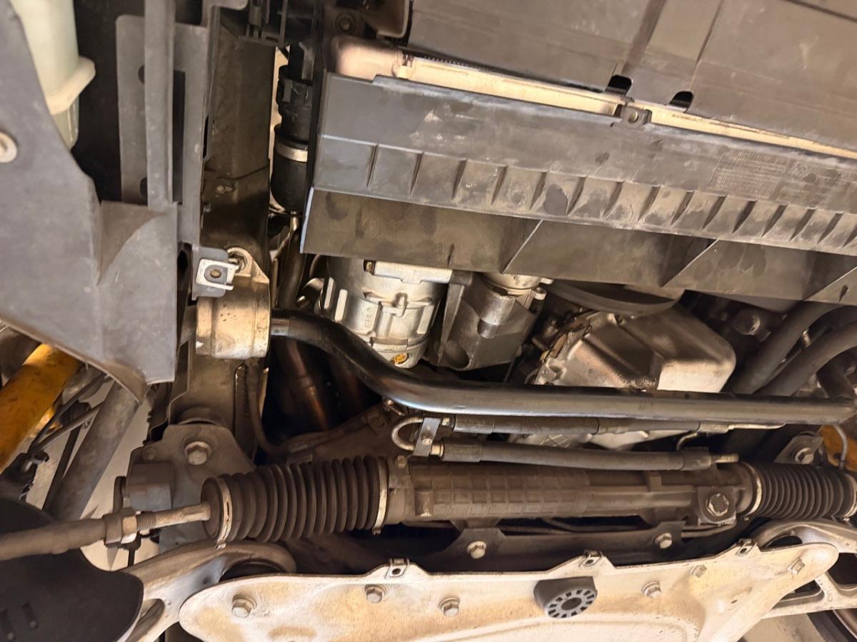

                            Alright, new AC compressor and oil cooler ($$$) are in and …drumroll… no difference. Still chasing the issues running hot in warm weather under load with AC on. I still see <10C across the radiator and coolant heats up with load. You can also see the 3D printed clips I designed for the oil cooler lines got used, and they fit great.​
                            Click image for larger version  Name:	IMG_9870.jpg Views:	0 Size:	130.0 KB ID:	363884 Click image for larger version  Name:	IMG_9867.jpg Views:	0 Size:	120.5 KB ID:	363882 Click image for larger version  Name:	IMG_9865.jpg Views:	0 Size:	145.8 KB ID:	363887 Click image for larger version  Name:	IMG_9855.jpg Views:	0 Size:	114.4 KB ID:	363886

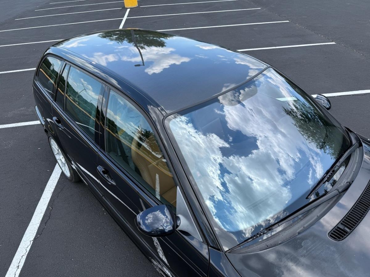

                            Stuck a prism onto the windshield and now I’ve got auto headlights and wipers again too. Odd that you can’t order the sedan comfort glass windshield with the RLS sensor, but the sensors do work through the filter at least. The windshield makes a surprisingly strong difference. I can really feel the heat coming through my driver glass but not the windshield glass.

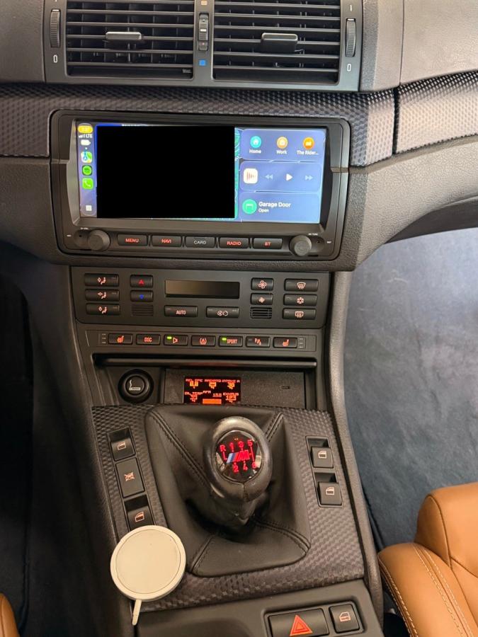

                            Also, looks like the Texas heat was too much for the XTRONS head unit. It wigs out and crashes when the headlights turn on, acting like a cold solder joint or a failed via. I never use the lighted buttons so I just cut the wire that controls the dimming/buttons in the jumper harness. Good times.

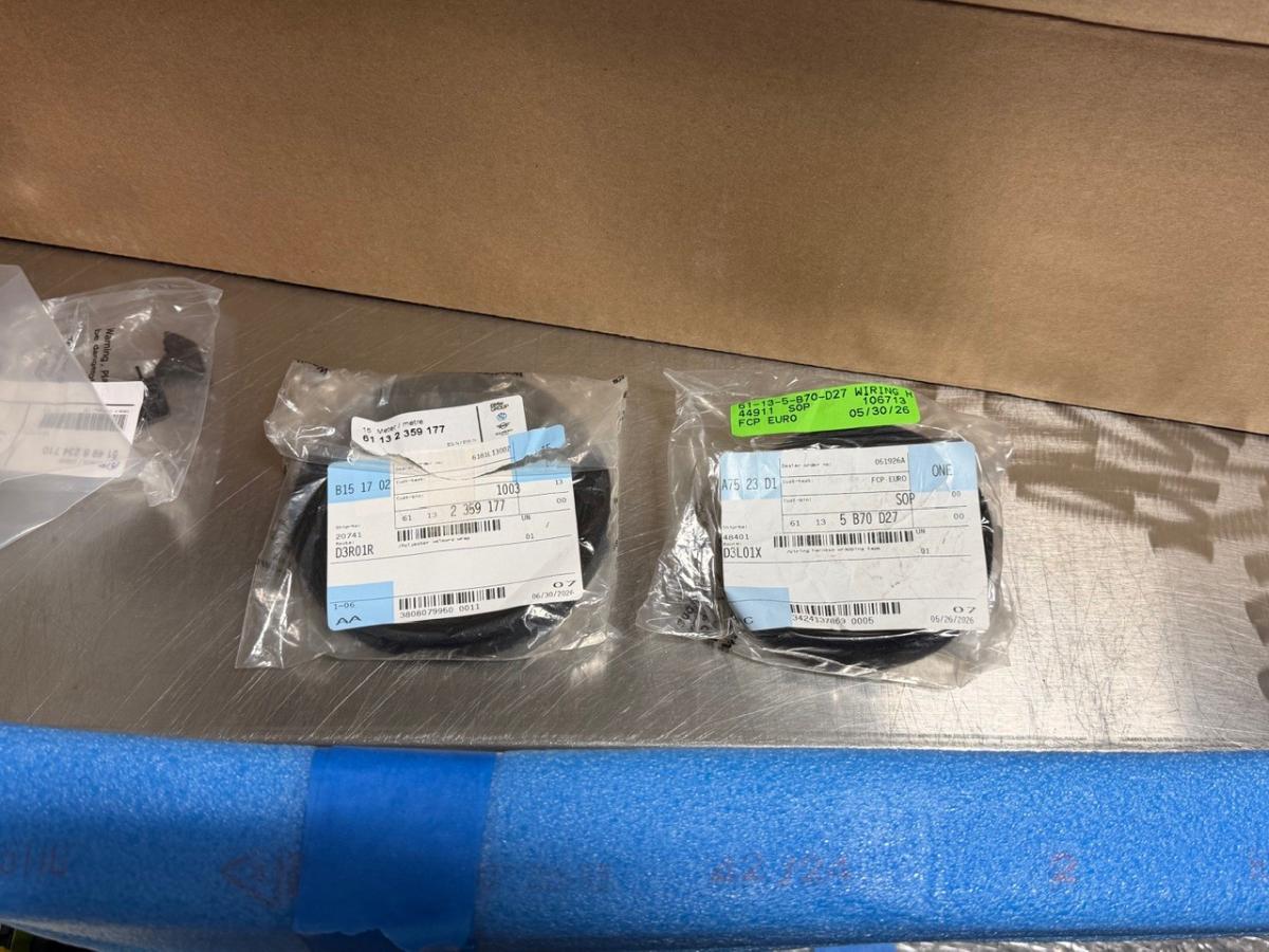

                            Figured out the part numbers for the thick polyester harness tapes:​
                            Click image for larger version  Name:	IMG_9804.jpg Views:	0 Size:	149.6 KB ID:	363883

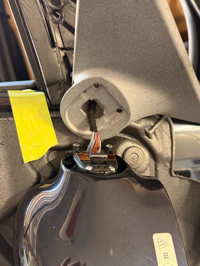

                            Shimmed the m3projekts mirror bases with some layers of kapton tape to eliminate some vibration:

                              XTRONS is absolved, had a wire short in the lighted shifter. All good now!

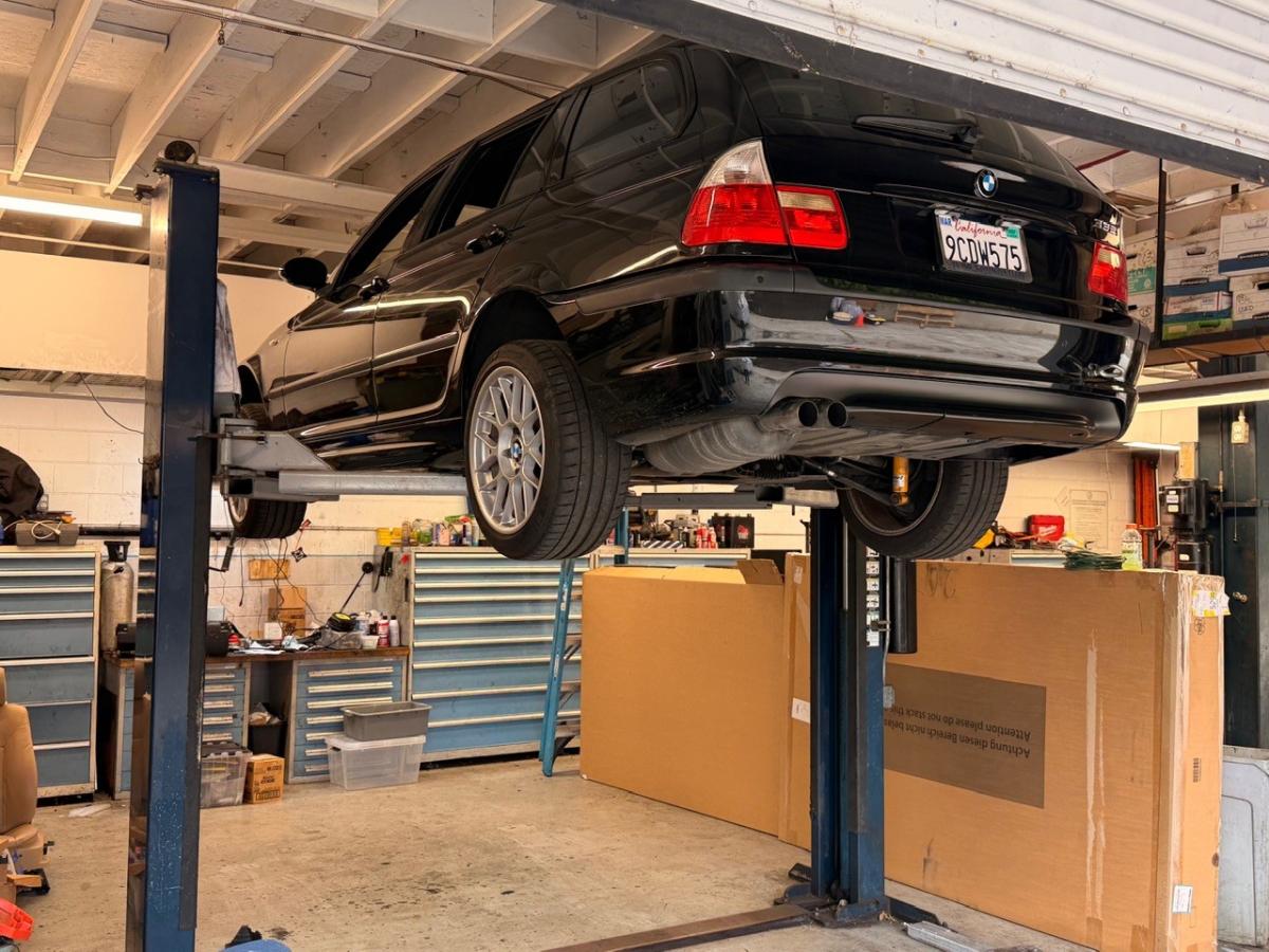

                                Well the car left me stranded for the first time today on the way home from having the roof wrapped. 1-2-crunched the gearbox to death. From its home position, the shifter only moves right (toward 5-6 gates) and won’t go into any gears. Detent springs and GPS all came out looking normal and it’s a factory manual without any riff raffing in the bell housing.
                                It will be resting on the lift until I summon the energy to deal with this one.​
