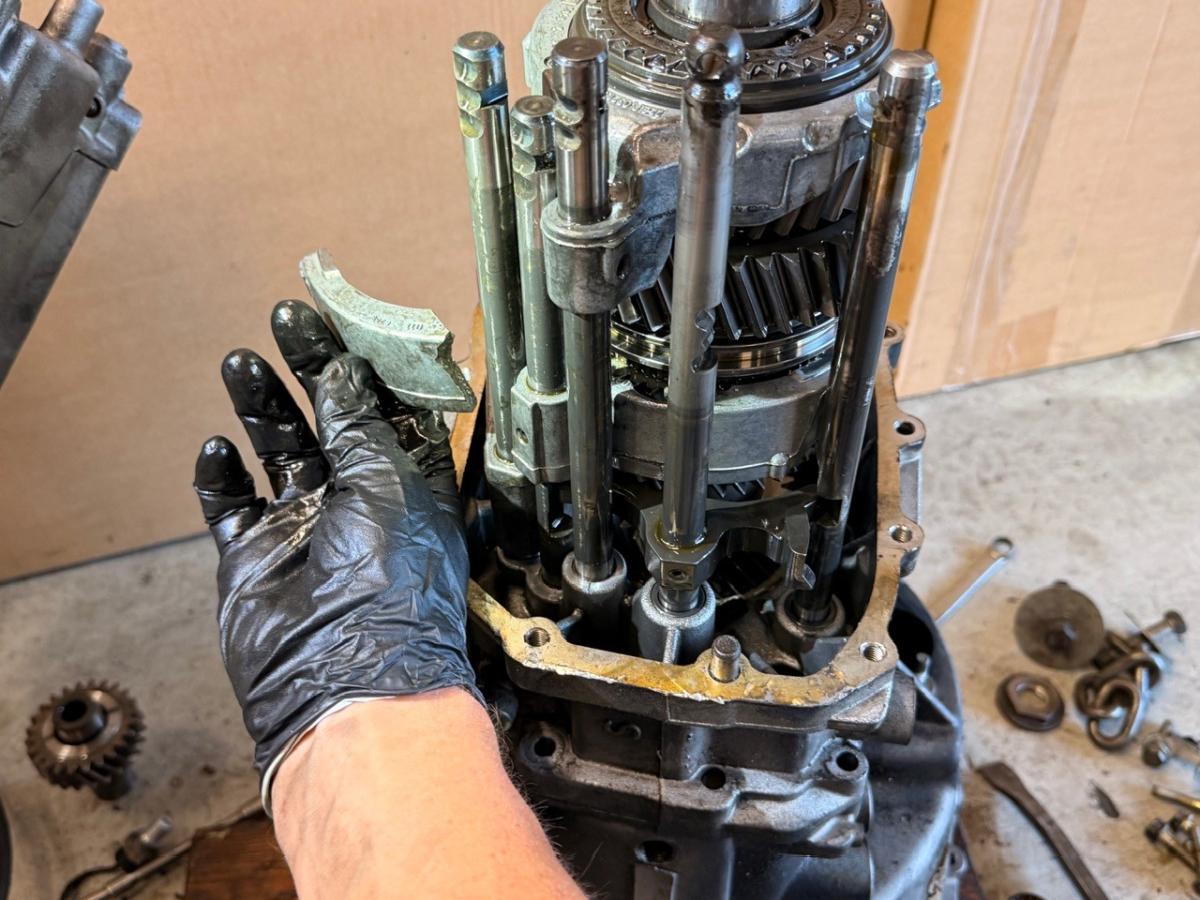

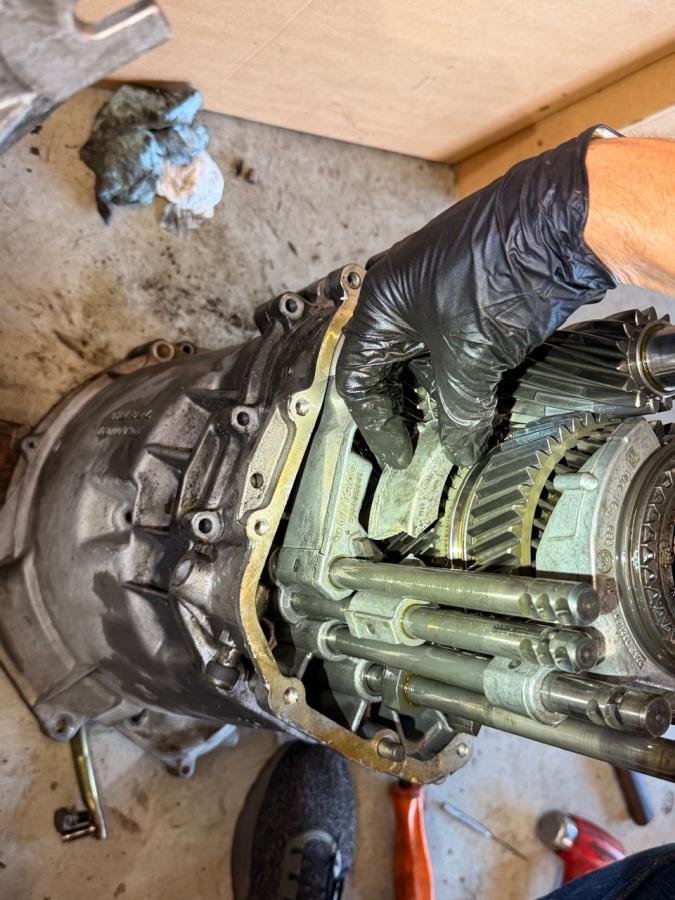

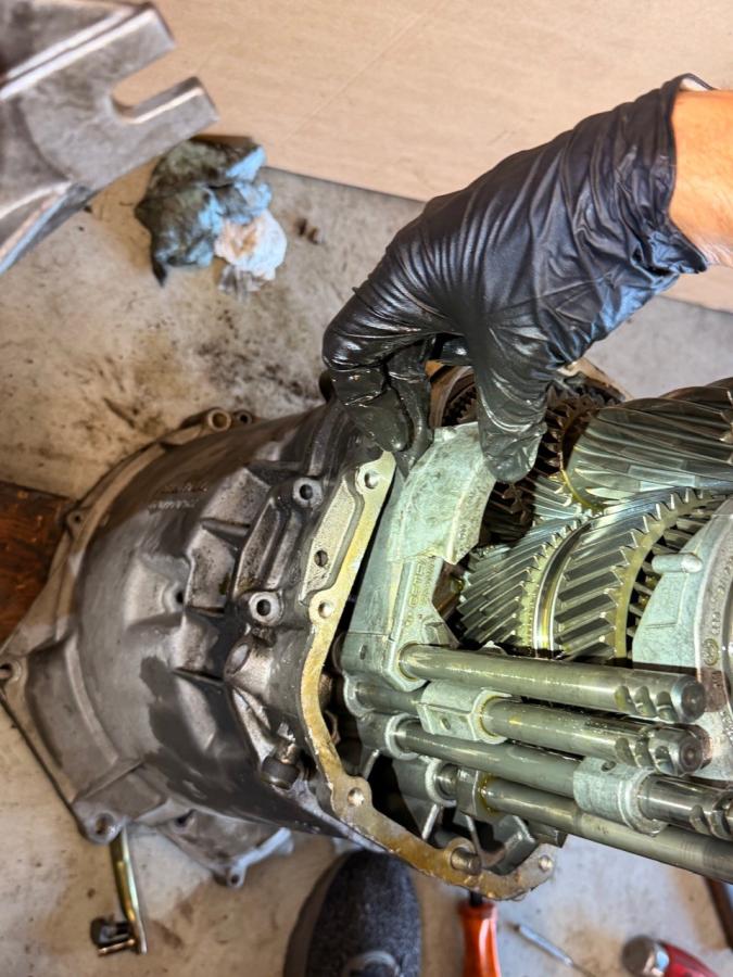

              Well, as suspected, broke a shift fork 💪
              Looking for a new gearbox now - factory one is $15k 😑​

                Seems like these 420g gearboxes have a lot of issues. More than other gearboxes. This is a feeling, no data. Its hard to tell since fewer and fewer non-Ms are manuals. I think the E46 was the last gen to have a decent number of manual cars.

                        I have a combined ~500,000 miles (including 20,000+ track miles) on 420G’s and have had… zero issues of any sort. Meanwhile, never had a BMW 5 speed that didn’t develop lean and need seals replaced.
                        I feel like they’re generally pretty solid!

                          Most people that claim they can drive a manual...can't. I think you take really good care of the car and know how to drive a manual. Yes, that makes you weird. Maybe borderline ice cream truck driver weird. lol
                          So I'm sure a maintained 420g in capable hands will last forever but 99.99% of manual M3s have been grinded and beaten on with the original fill from the break in service...if it got one. It is hard to find a good shifting used 420g, not hard to find a ZF320 that shifts well. The lean is an easy fix if you can find parts and afford them.
                            This is just prior life error.
