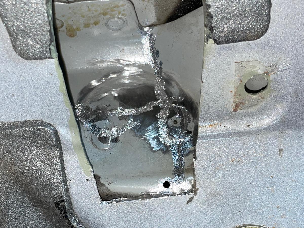

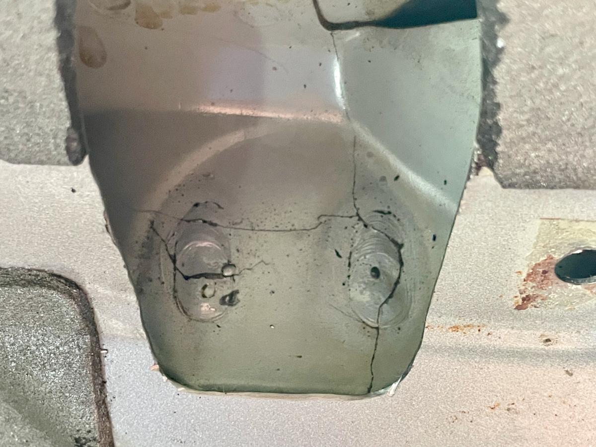

            On Saturday morning dad and I welded up the cracks in the top of the front right RACP mount. As usual I did a bad job of taking photos as we went, but I did get a couple here and there.
            As a recap, this is what the front right looks like from the top:
            As you can see in the photo above the crack coming down towards the bottom of the photo is hidden behind the rear seat sheet layer. So that we could see how far this crack went we inspected the bottom side of the top layer of the RACP with my boroscope.
            Click image for larger version  Name:	IMG_0248.jpg Views:	0 Size:	56.6 KB ID:	285677
            As can be seen the crack extends just to the point that the RACP bends down to layer up with the rear seat sheet. For reference the threaded insert visible on the right hand side of the image is for the seatbelt buckle.
            Knowing how far down the crack extended meant that I was easily able to cut the small section of the seat layer out so that we could access the end of the crack to drill and weld. We found that a rounded nose carbide burr in the die grinder was the best way to clean up the surface around the cracks.
            Click image for larger version  Name:	IMG_0250.jpg Views:	0 Size:	246.2 KB ID:	285678
            Dad then MIG welded the cracks up - I unfortunately didn't get any photos of this as I was running extraction and lighting while dad welded. A couple of comments though:
            - We used some ceramic fibre insulation segments to pack the RACP cavity to prevent sparks, grindings, etc. from traveling inside the cavity. the ceramic fiber insulation is good in that it's non-flammable.
            - I had previously measured the thickness of the RACP layers to be welded and dad had obtained some equivalent sheet metal to run some trials on and dial in the settings on the MIG.
            - We went slow to avoid heating everything up too much, even so the cavity wax on the underside of the top RACP layer tends to melt and smoke along where you've welded, good extraction is advised.
            - We used the boroscope again to check the other side of the welds (where they are on a single layer of sheet) and confirm good penetration of the weld.

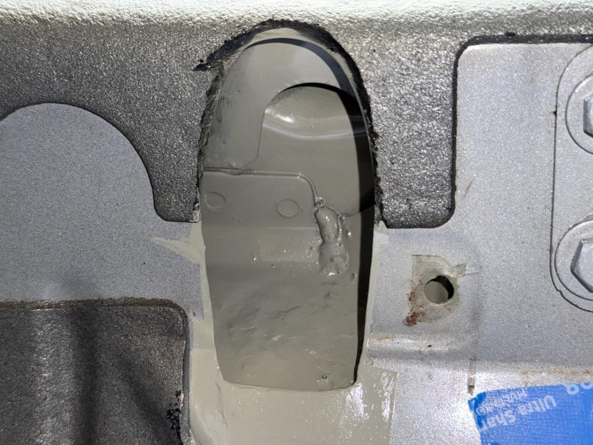

            With the welding done I then cleaned up the top surface with the carbide burr to level out the welds and leave an, as flat as possible, surface for the brace to mount to.
            I unfortunately didn't get any photos of the welds prior to cleaning up and putting a protective layer of undercoat on.
            Click image for larger version  Name:	IMG_0254.jpg Views:	0 Size:	121.4 KB ID:	285679
            As you can see the surface is not perfectly smooth (the flash from the phone actually makes it look more pronounced than it is in reality - it is less than 1mm, which will be perfectly fine for this situation. The OE welds stick up a couple of mm anyway. I didn't want to take away too much material at any point with the burr, so played it safe and left a small amount of extra material in place.
            You may also notice that we welded the little cutout that we made to access the end of the crack back in place and smoothed it out with a little body filler. Not really necessary given it's going to spend the rest of its life under the seat again, but for the sake of an extra 20 minutes work it's worth it in my opinion.
            I hand painted on the under coat as I wanted to make sure I could get it into all of the corners well, there's not a lot of room in there to rotate a spray can. I'll do another layer of undercoat, and then sand it back a little, mask up, build myself a little spray booth inside the car and do a couple of coats with the e-coat matched enamel I have. I'll then dust on some A08 on the seat bench (when I can finally get some, whole other story) to replicate the original surface as much as possible.

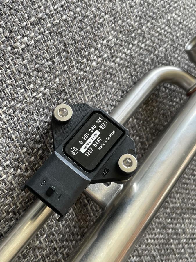

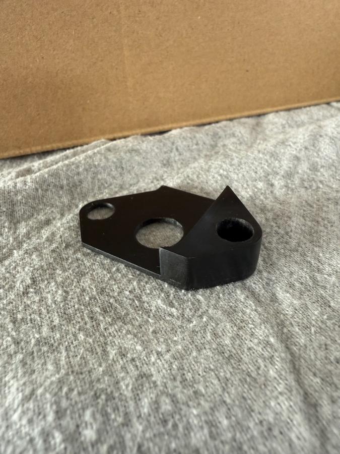

            Secondly the DIN7984 hex head bolts for the MAP sensor arrived, they're identical to the original items except 18mm long to address the greater thickness of the 101 sensor mounting point, plus they're stainless rather than the zinc-coated original bolts. I'm happy with how these have turned out:
            Click image for larger version  Name:	IMG_0225.jpg Views:	0 Size:	141.4 KB ID:	285682
            Click image for larger version  Name:	IMG_0226.jpg Views:	0 Size:	121.7 KB ID:	285681

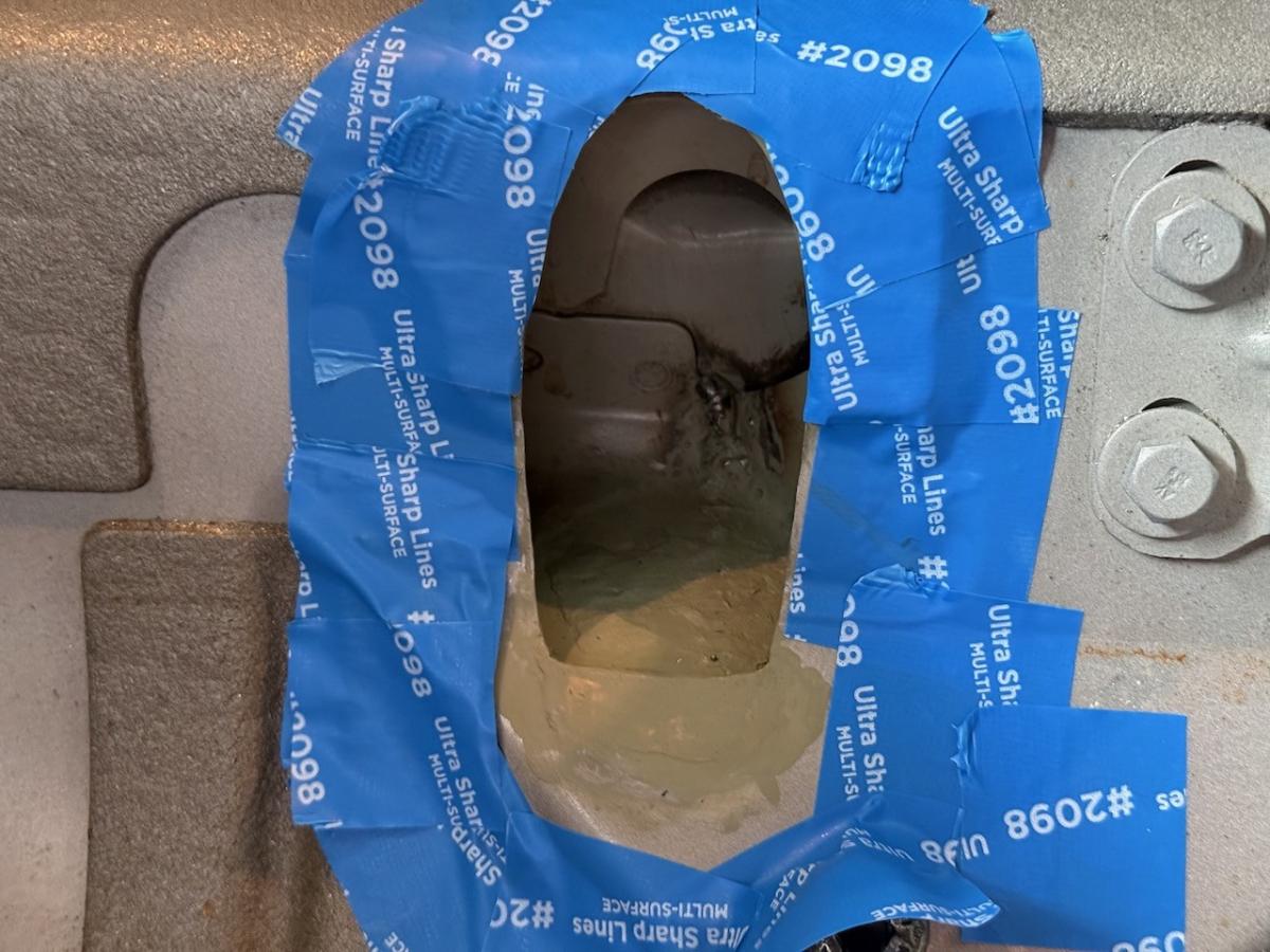

              Today I cleaned up the top front RACP points and sprayed with the e-coat matched enamel I have.
              First up I masked the area around the mount (photo taken prior to clean up).
              Click image for larger version  Name:	IMG_0040 (1).jpg Views:	0 Size:	139.9 KB ID:	286393
              Then I used a ziploc bag as a miniature spray booth by taping it to both the RACP and the spray can. I also made sure to cover/block every other hole/exit point in the RACP so I didn't get any over spray wafting out anywhere.
              Click image for larger version  Name:	IMG_0041 (1).jpg Views:	0 Size:	179.7 KB ID:	286395
              And the end result (paint is still wet here):
              Click image for larger version  Name:	IMG_0050 (1).jpg Views:	0 Size:	183.3 KB ID:	286394

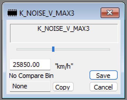

                I've been going through the public XDF for the 0401 binary and sorting out some of the incorrect references. They're usually pretty easy to confirm by looking at whether the data makes sense. This one made me chuckle 😛
Name:	Screenshot 2024-12-12 at 7.13.19 PM.png
                  I've spun up a thread (https://nam3forum.com/forums/forum/s...assembly-notes) in the Coding section which I will keep updated as I work through the disassembly. Aim is to make the info easy to find and also splits it out from this build thread.

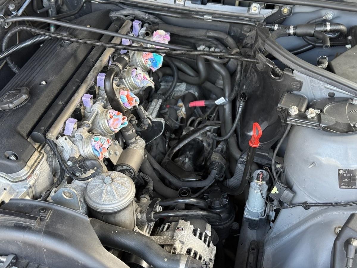

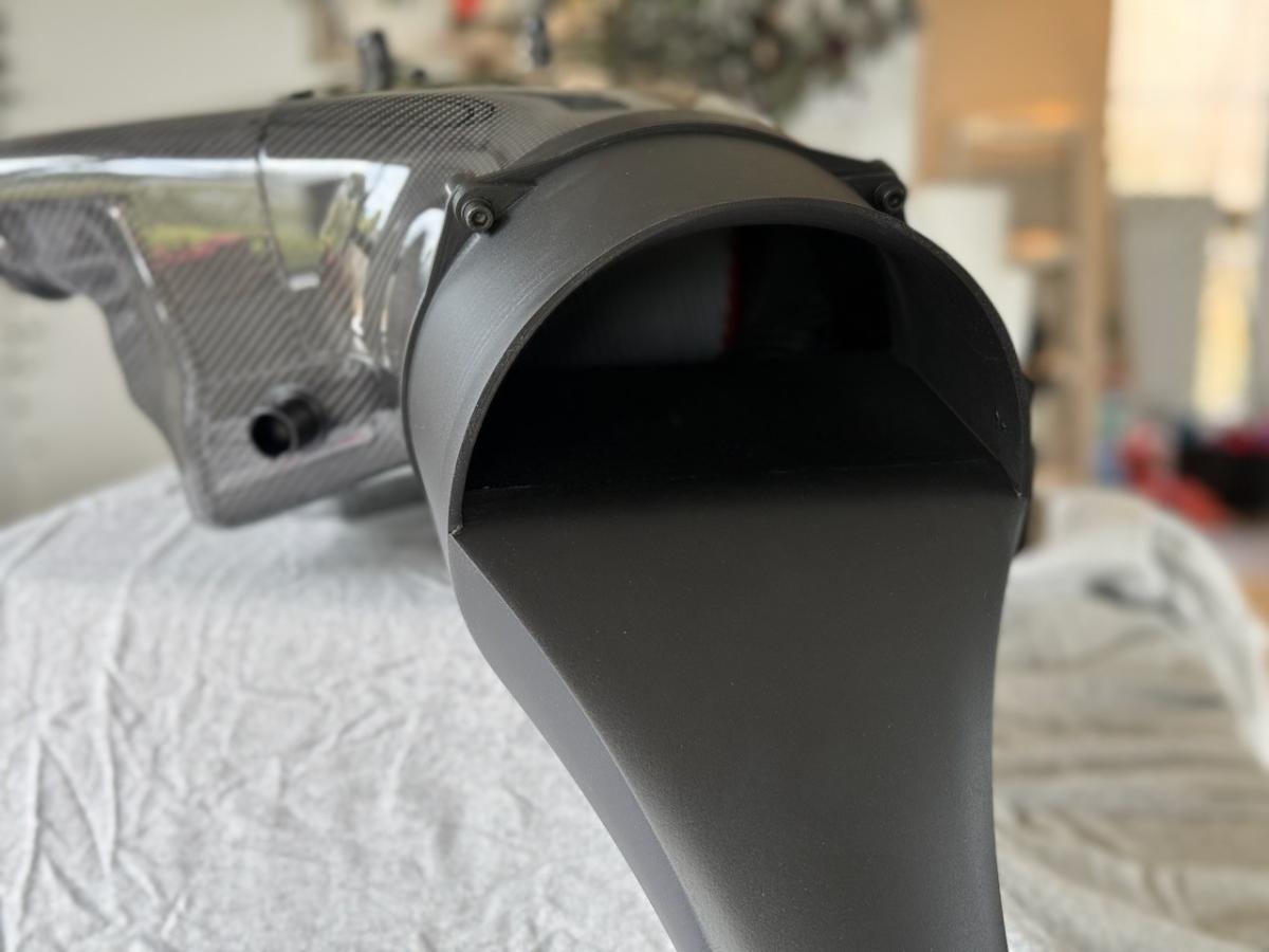

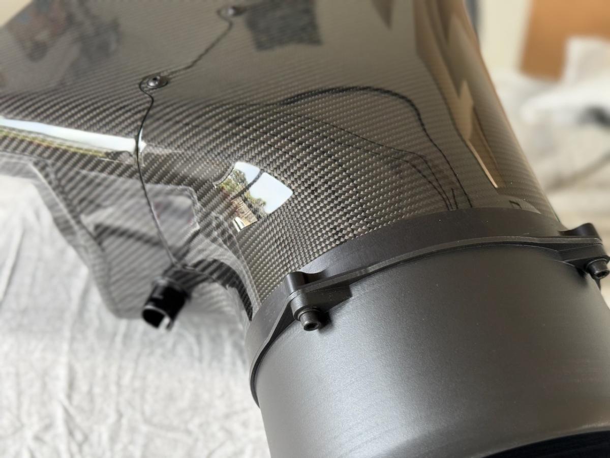

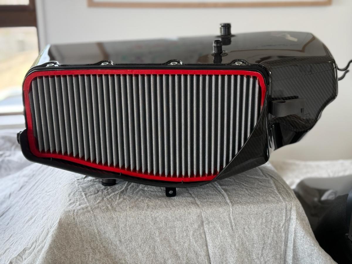

                    Finally made it to my summer break! Did a quick fitment check of the airbox, filter and Haimus snorkel to make sure I don't get any surprises during install. I've noted others have found the hose attachments to be tight so am prepared that I might need to do some adjustments there like heinzboehmer did to get them to click in correctly.

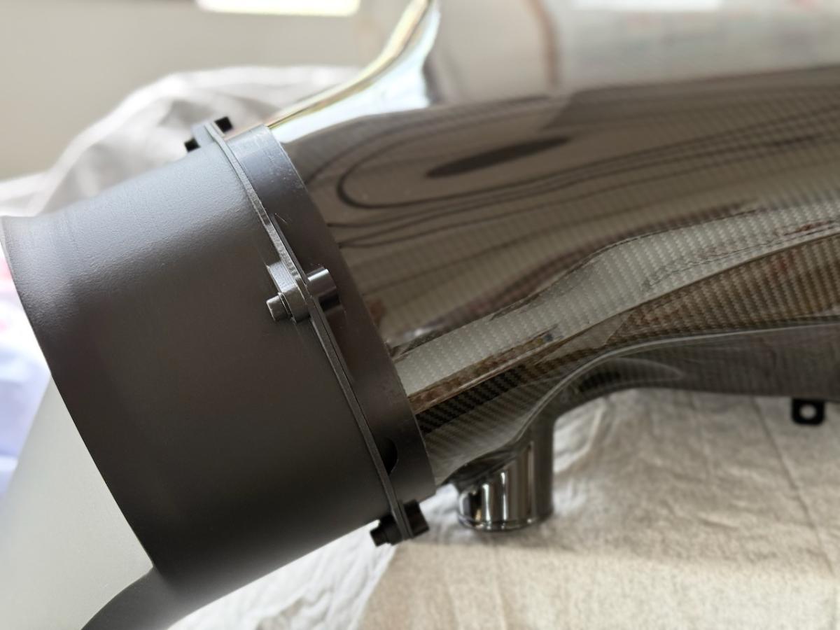

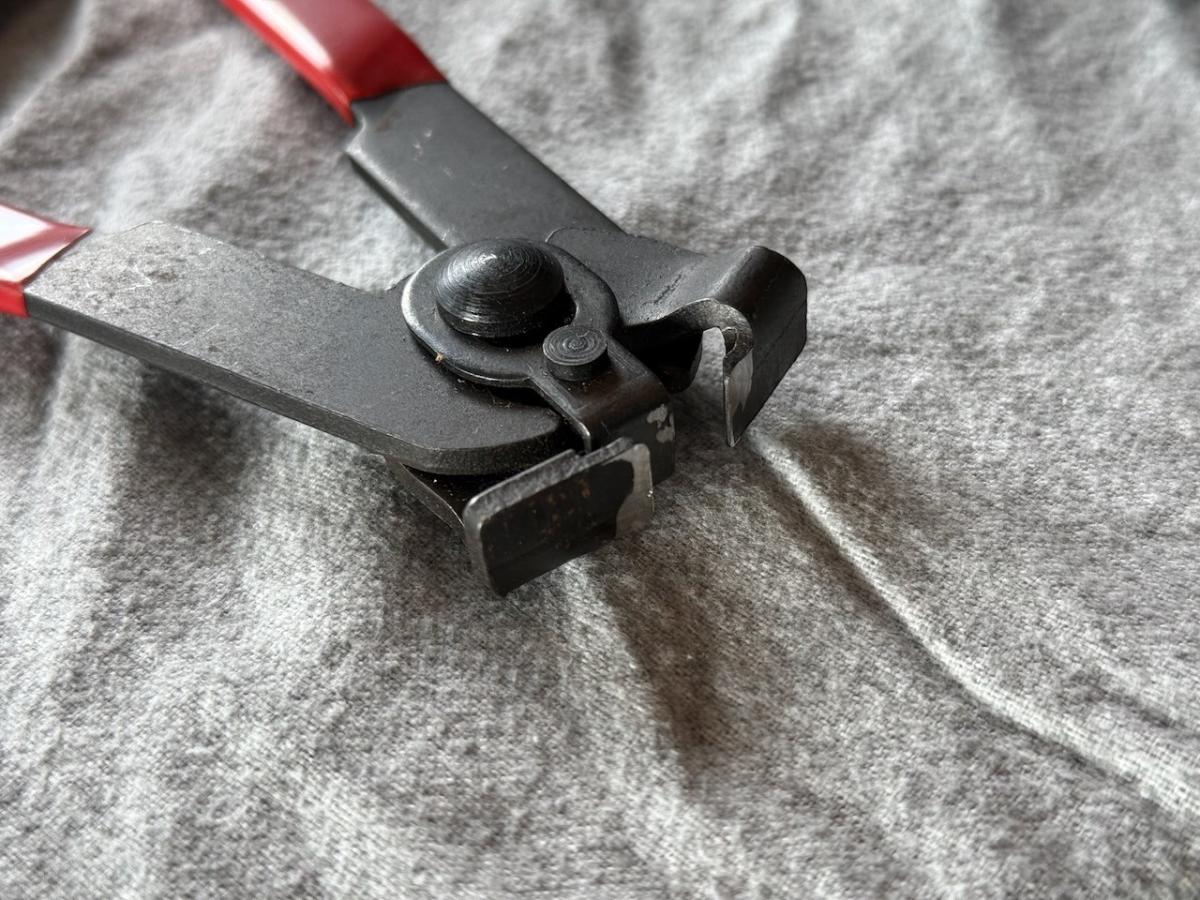

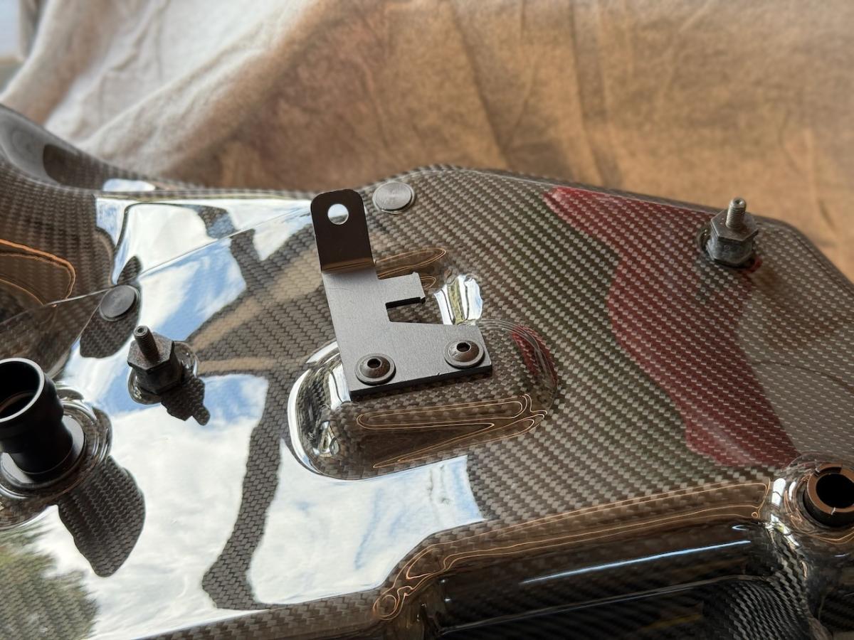

                      Yesterday afternoon I conditioned the intake boots and clamped them to the airbox. The tool for the Oetiker clamps works out at about $100NZD however you approach it so I saved $85 dollars by using the dremel to modify some standard $15 SuperCheapAuto clamp pliers.
                      Click image for larger version  Name:	IMG_0237.jpg Views:	0 Size:	182.4 KB ID:	287923
                      This worked very nicely - I'll paint the pliers so they don't rust and they can go in the toolbox for next time.
                      Click image for larger version  Name:	IMG_0235.jpg Views:	0 Size:	155.3 KB ID:	287926
                      Click image for larger version  Name:	IMG_0236.jpg Views:	0 Size:	130.0 KB ID:	287925
                      I also installed 2x new rubber isolators - Being 20 years old the rubber in the current ones is probably soft and perishing.
                      Click image for larger version  Name:	IMG_0234.jpg Views:	0 Size:	152.7 KB ID:	287924
                      Plans for between now and whenever the dipstick tube turns up is to remove the LHS radiator cowl shield in preparation for installing the airbox.
                      Yesterday I also took the car for a drive and logged the relevant variables with TestO to get a baseline capture before I go making any changes to the car. I want to make sure I'm as prepared as I can be for moving across to the 0401 program. To that end I will also be doing another full review of each change I've made to the partial as part of v1 of my tune. It's been long enough now since I did it that I should be able to do a good review of it and make sure I haven't made any mistakes.

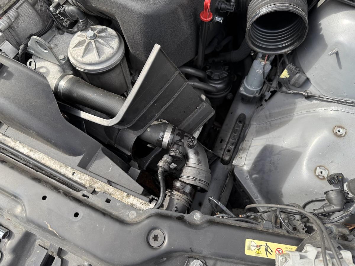

                        This morning I removed the LHS radiator cowl. My objective with these modifications remember is that I retain the ability to return the car to stock. I therefore didn't want to cut-down or cut off the cowling. It was a quick job to detach the top radiator pipe and slide the cowling out.

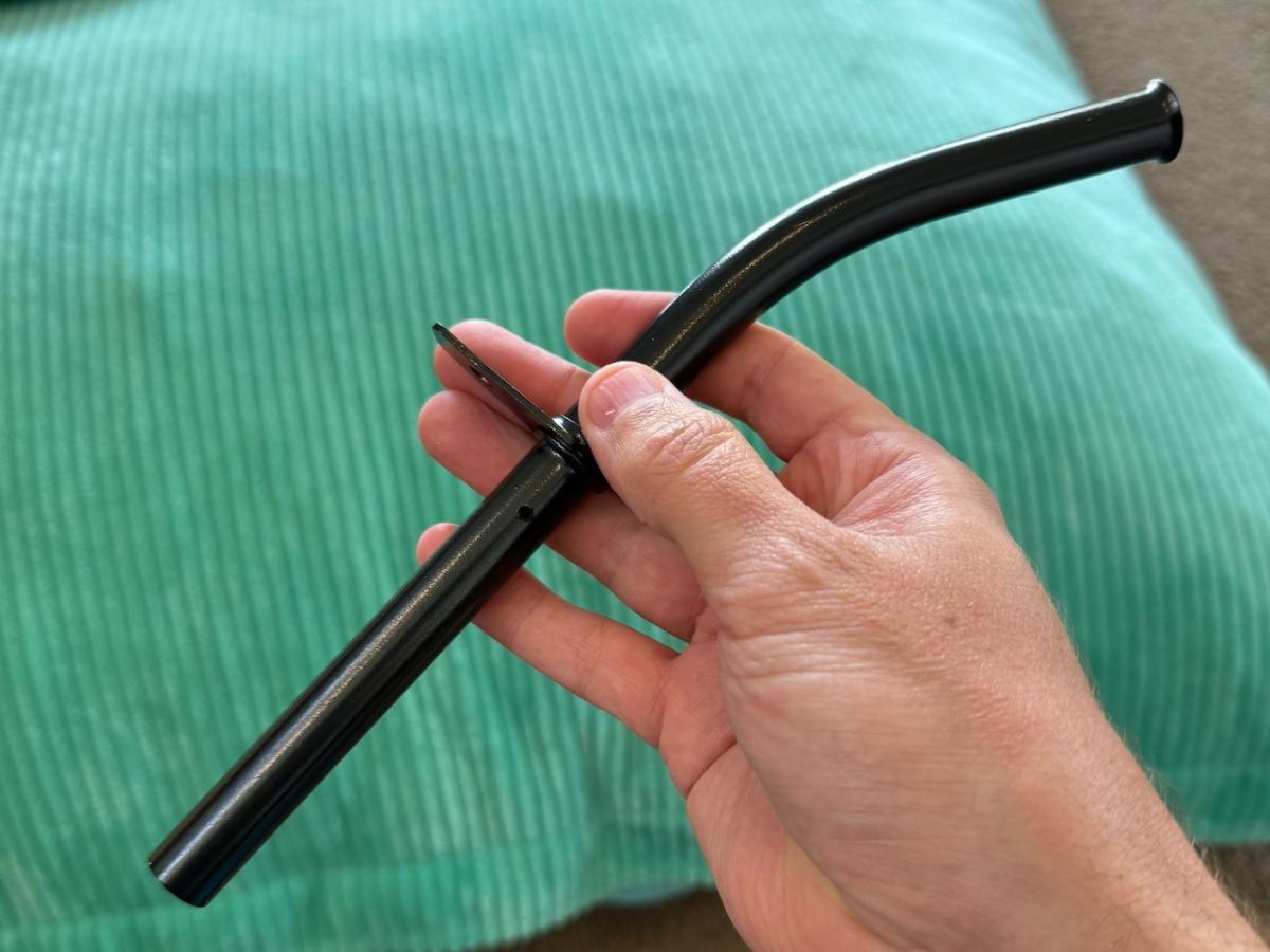

                        Then right on cue the CSL oil dipstick tube showed up (along with the silver-coloured hardware I was waiting on for the airbox as well).
                        So I carried on going...

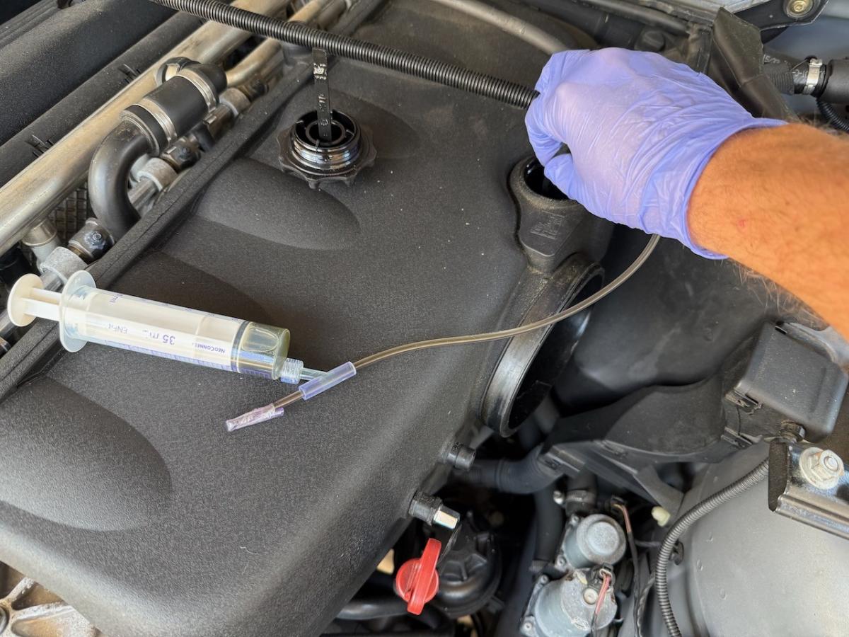

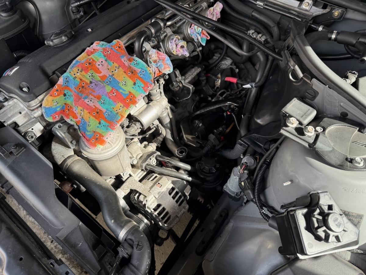

                        I didn't have a turkey baster for removing the SMG fluid from the reservoir, but I do have an abundance of my son's old enteral syringes and feed pump tubing :-)
                        All pretty straightforward - the little connector on the bottom at the back is a bit of a pain, but all done without too much fuss.

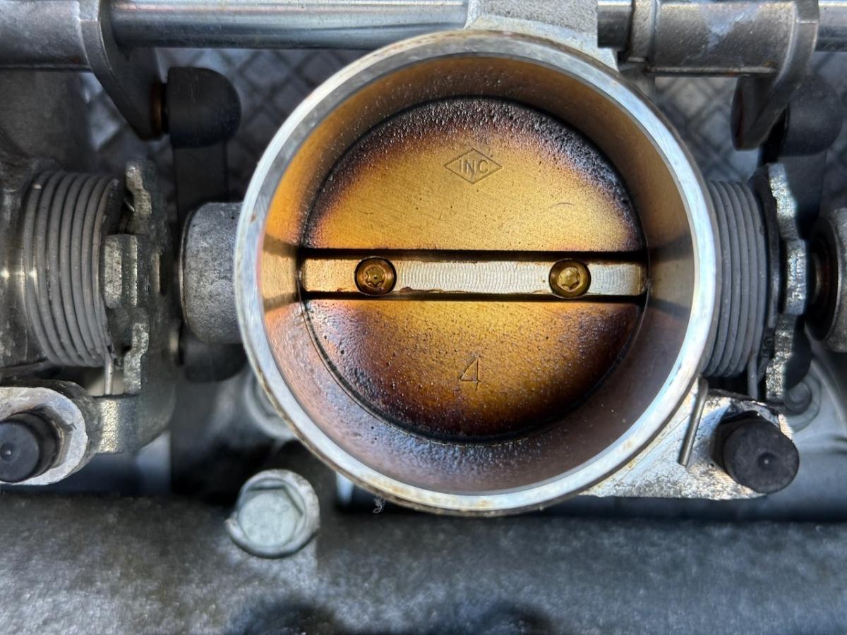

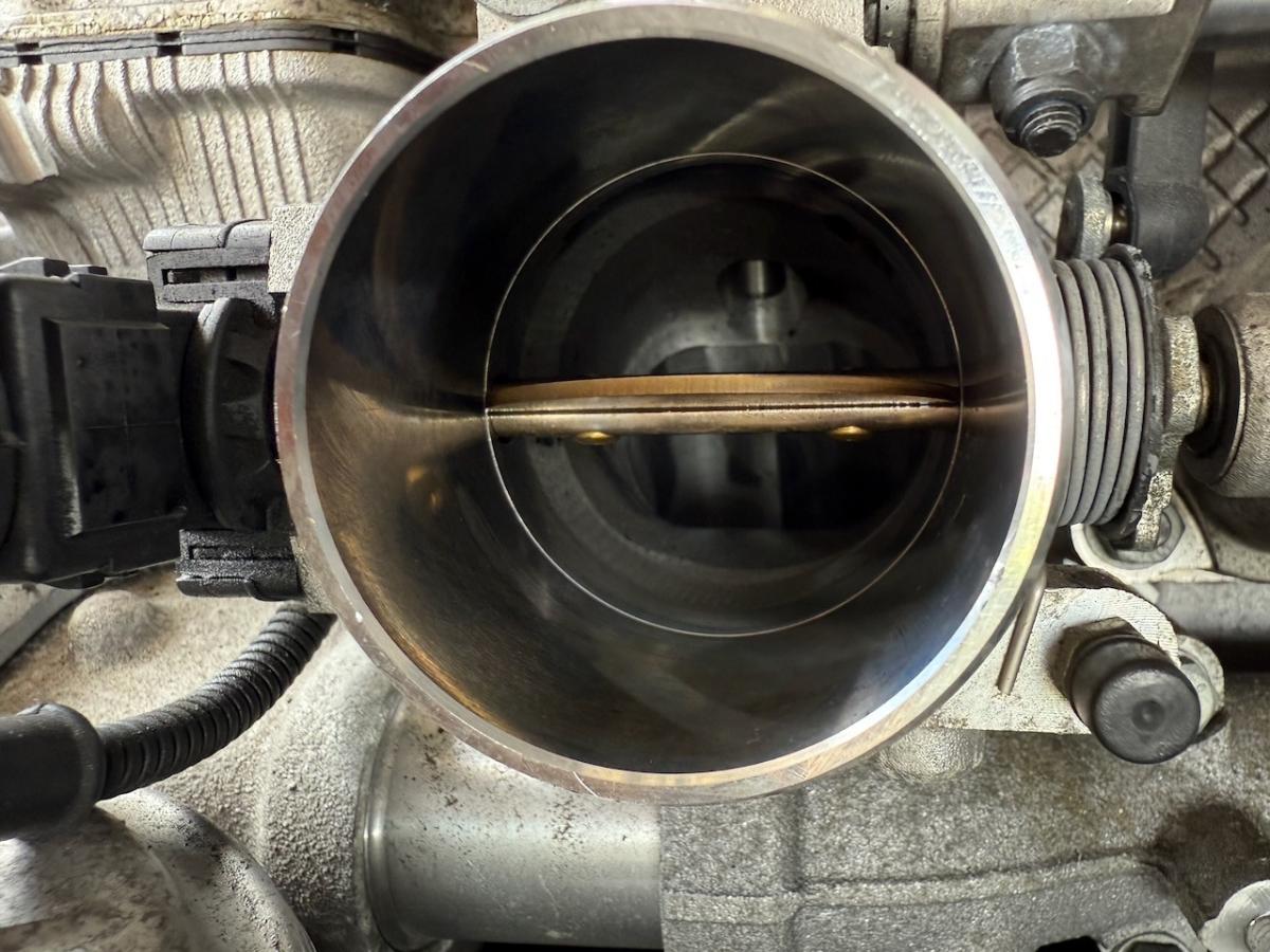

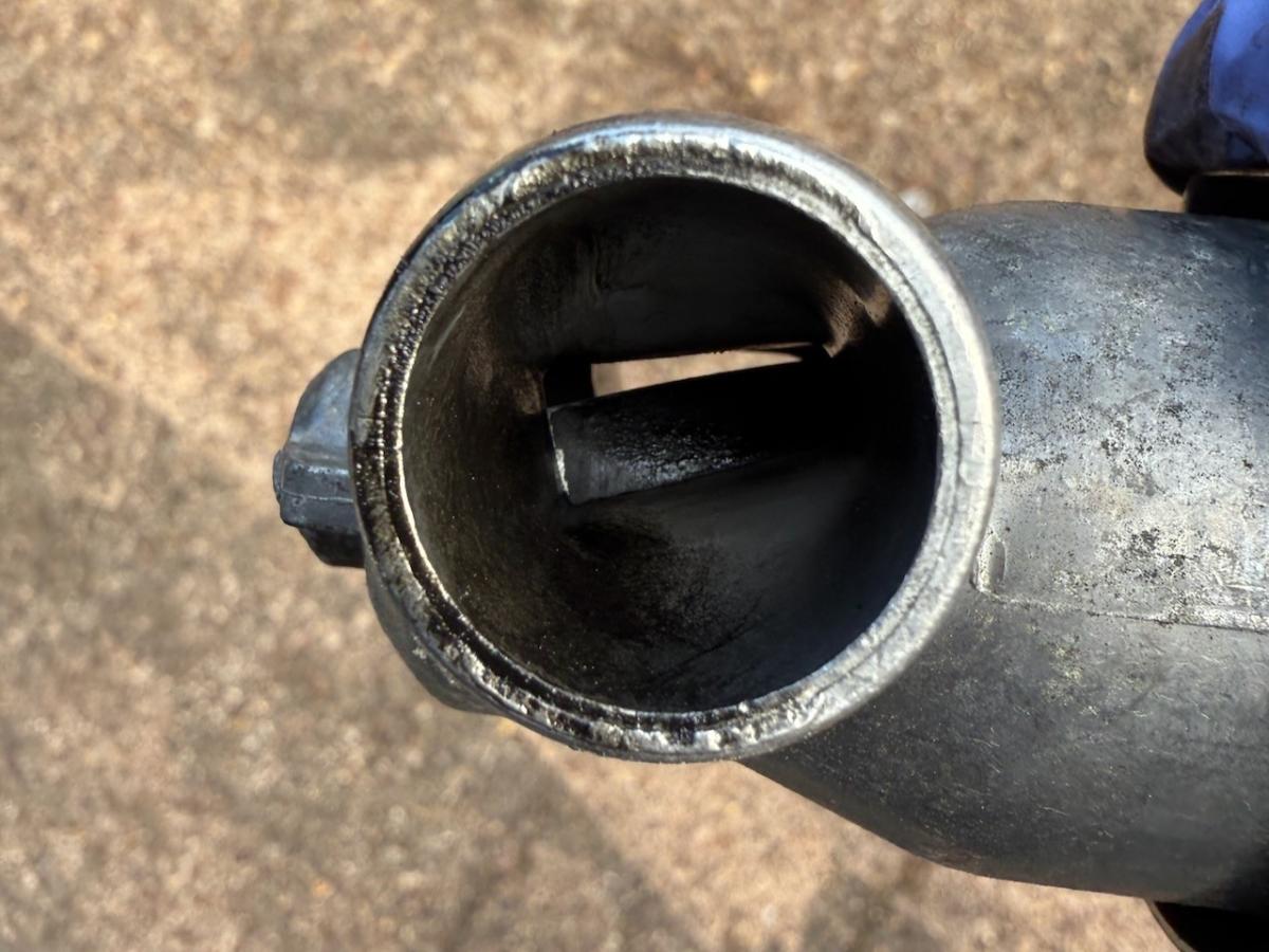

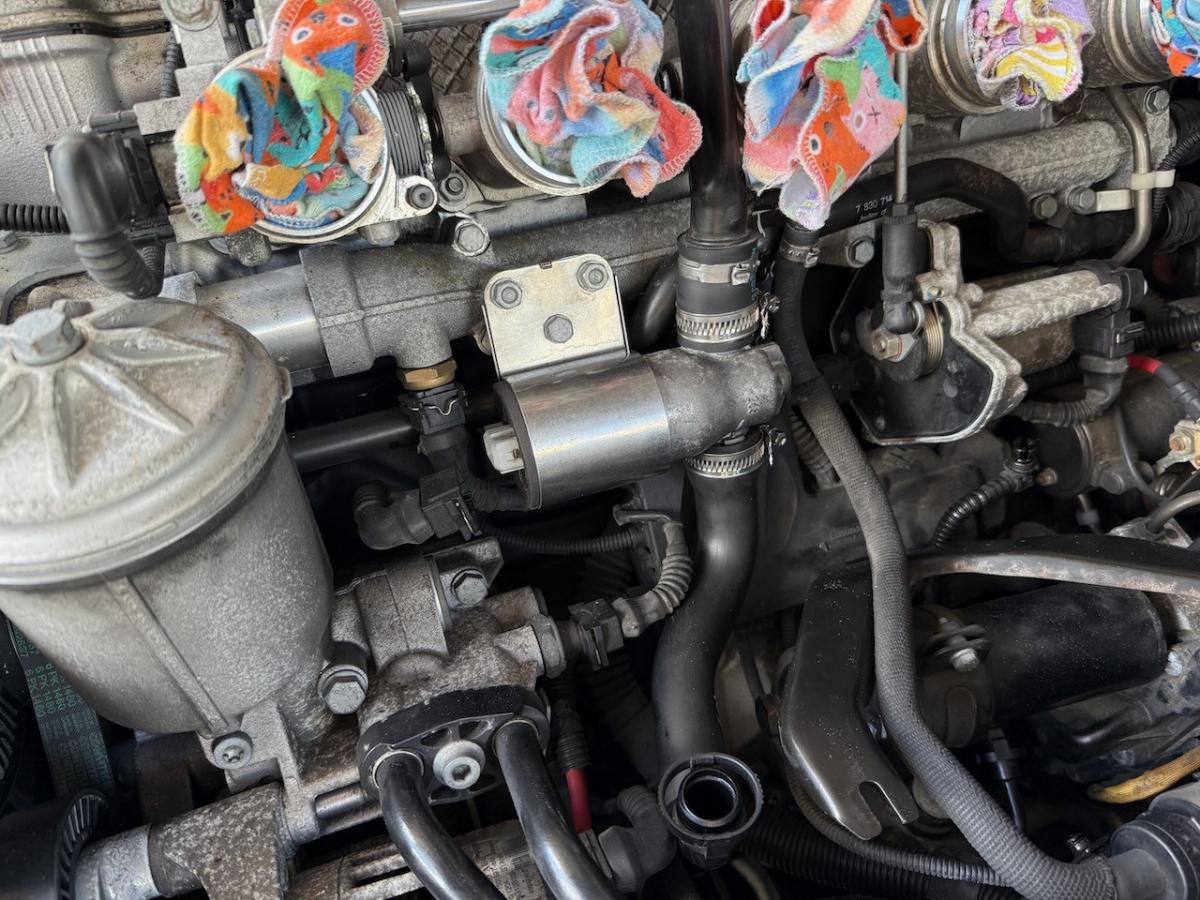

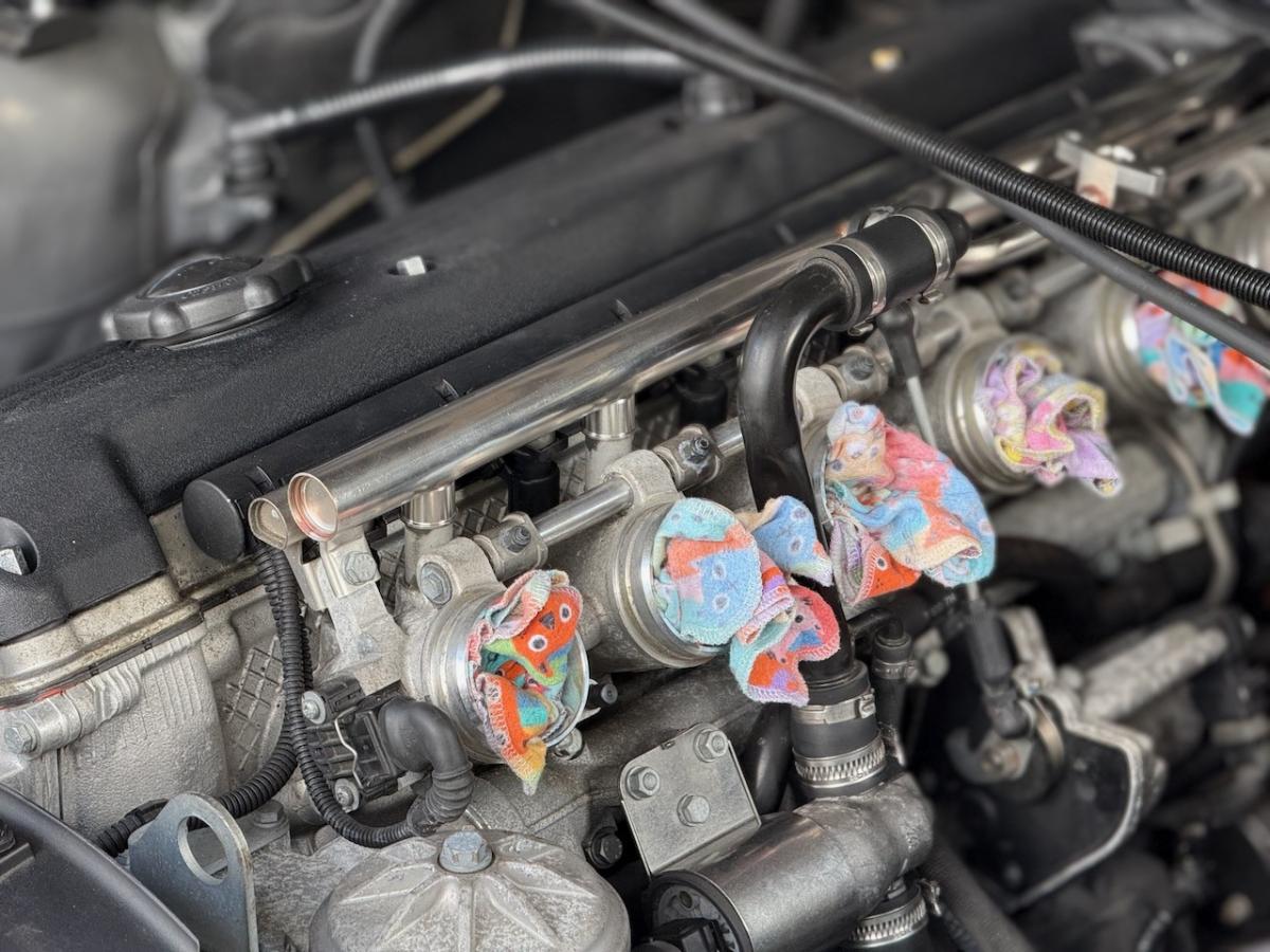

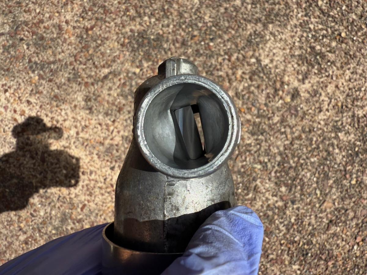

                                First up - I cleaned the ICV and throttle bodies with CRC throttle body cleaner. I hate to think what's in it, but it works very well. The ICV wasn't as gunked up as I was expecting, and the throttle bodies were worse than I was expecting.
                                Click image for larger version  Name:	IMG_0375.jpg Views:	0 Size:	123.2 KB ID:	288316
                                Click image for larger version  Name:	IMG_0380.jpg Views:	0 Size:	182.7 KB ID:	288320
                                Click image for larger version  Name:	IMG_0376.jpg Views:	0 Size:	153.2 KB ID:	288318
                                Click image for larger version  Name:	IMG_0379.jpg Views:	0 Size:	151.8 KB ID:	288321
                                Of note is that I decided to use reusable screw-type hose clamps on the ICV - I intend to make cleaning it a semi regular exercise so decided screw clamps made sense given they are hidden anyway.
                                Click image for larger version  Name:	IMG_0382.jpg Views:	0 Size:	178.3 KB ID:	288325

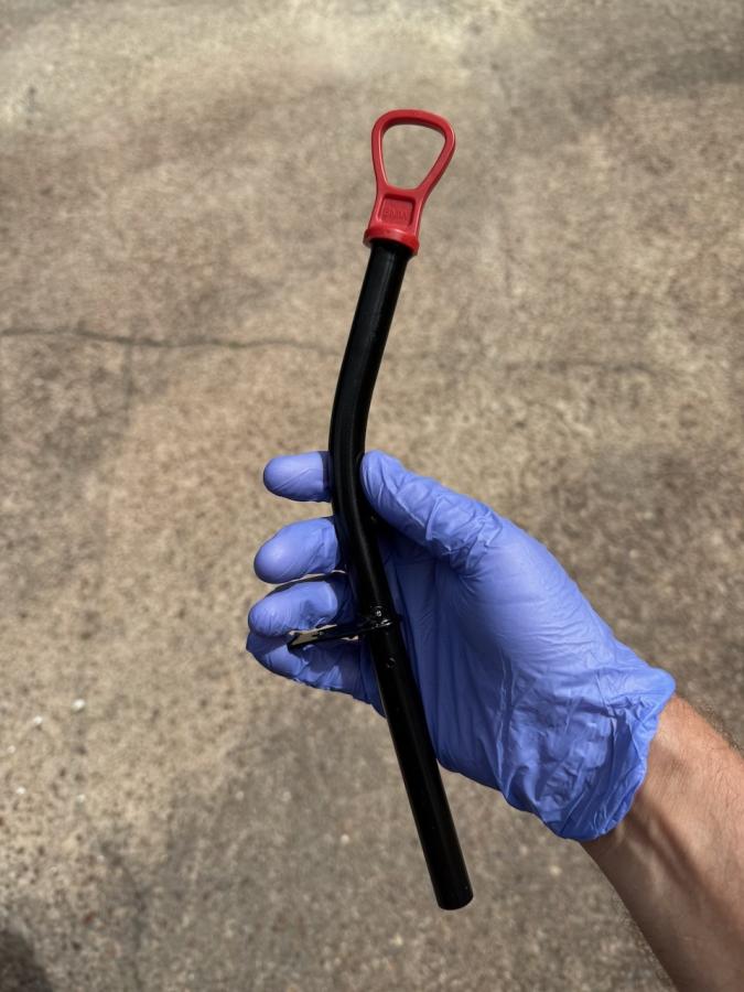

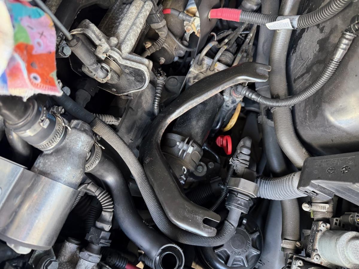

                                I swapped the oil dipstick tube out for the CSL one.
                                Click image for larger version  Name:	IMG_0384.jpg Views:	0 Size:	170.0 KB ID:	288324

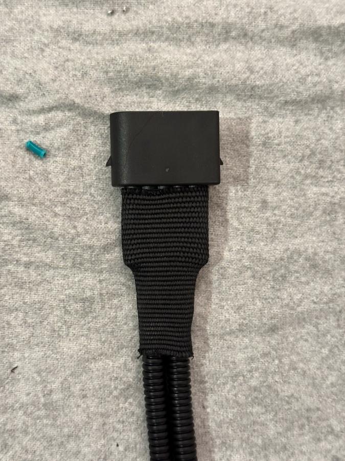

                                Lastly I spent some time this afternoon getting the MAF connector end of my extension wiring loom done. Because I don't want to hack up my wiring loom, etc. and want to retain the ability to return to stock I'm taking the approach with the wiring for the MAP and IAT sensors of making an extension from the MAF sensor connector which splits out and runs to the IAT and MAP sensor respectively. I'll follow the trunk that goes from the distro box by the ECU box across to the distro box underneath the ICV, and from there to the sensor locations.
                                In terms of the pinouts - all I need to do is to de-pin X6003 pin 1 (MAF signal) and re-pin it to X6003 pin 18 (MAP signal). I'll put a warning label in the ECU bay to note this so that I don't forget in the future and have an easy reference to return to using the MAF sensor if so desired.
