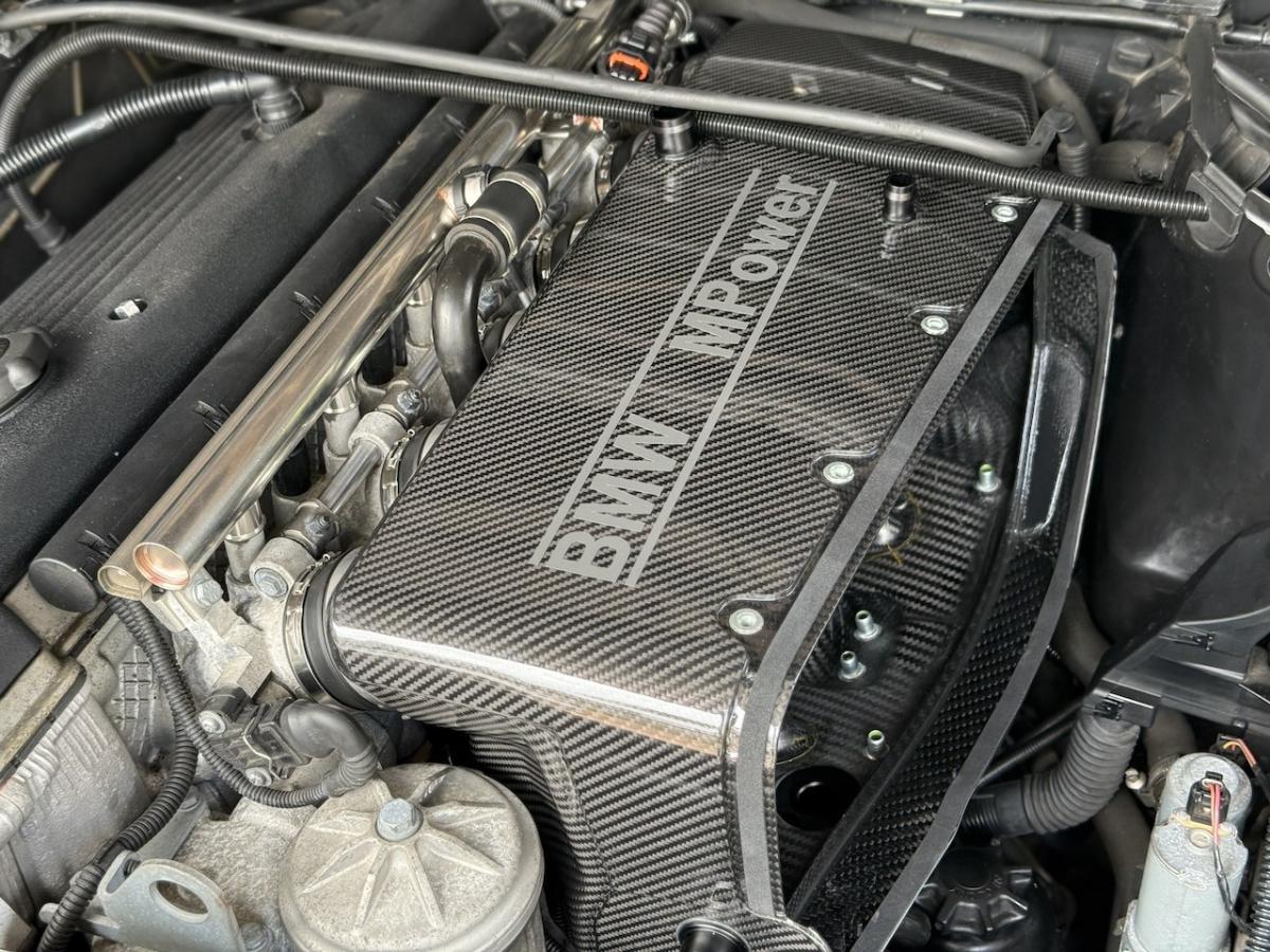

      Yesterday morning I completed the install of the airbox.
      First up I took the wiring loom and laid it out in the engine bay to work out the best way to route everything (note the red ties temporarily holding it in place).

      Once I'd done that I then temporarily installed the TB half of the airbox to get the position and orientation of the IAT sensor just right. I made sure to mark on the loom the orientation of the loom to the connector so that it sat just right. Then I uninstalled the airbox, removed the loom and attached the connectors for the MAP sensor and IAT.

      Then it was back in with the first half of the airbox for reals this time. All of the hoses and connectors fitted perfectly - I didn't run into any of the issues heinzboehmer did - maybe Karbonius have refined since? The only annoying thing was installing the 10mm nut for the rear vibration isolator - there's not much room to get in there.
      I clamped up the throttle body boots and moved on to installing the MAP sensor. I'm super happy with how the MAP sensor adapter has turned out - it's worked out exactly how I envisioned it would (I've got more to say about this which I'll do as a separate post).

      Then it was a quick job to install the front half of the airbox and the snorkel:

      And finally with the rest of the engine bay back together (you'll have to excuse the dirty car - I'm in the middle of significant landscaping and renovations at the moment at home and it simply isn't worth me spending much time cleaning anything up as the clay dust gets everywhere:
