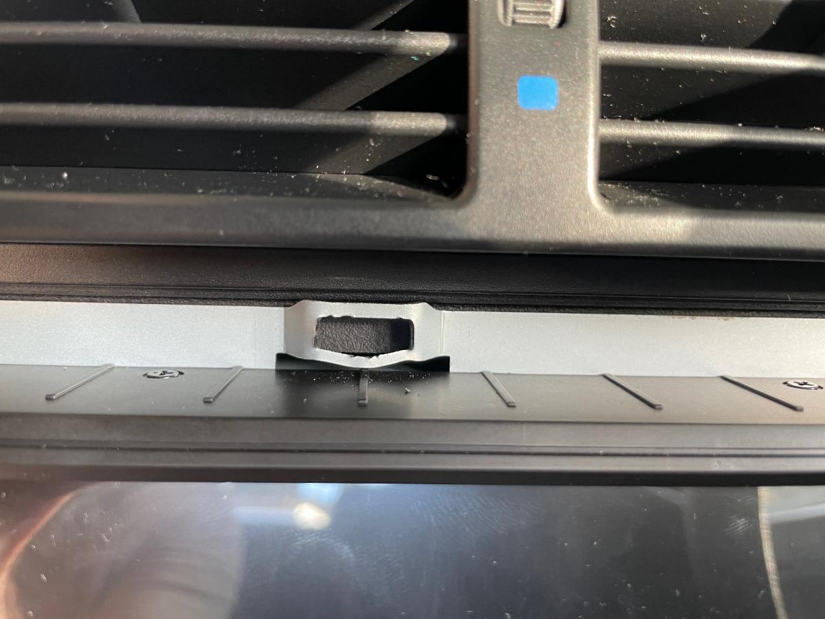

      Also realised I didn't update on adjusting the xtrons headunit to fit the dash trim properly. It turned out it needed to be adjusted a lot - more than could be achieved with a file - photo shows how far out it is:

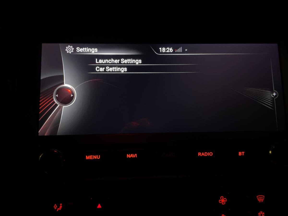

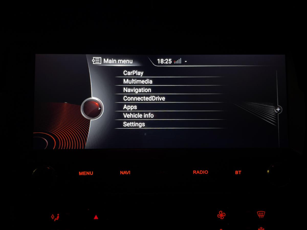

        I almost exclusively use the Xtrons headunit for CarPlay, however on the occasions that I have a need to do something else I find the default Xtrons launcher to be a pretty jarring experience. I've been having a bit of a look around at options, and have had a play around with iDrive Launcher (https://idrive.ibus-app.de/index_en.html). I know that NBT iDrive didn't come on the E46, however it certainly feels a lot less flashy and feels like it fits much better in the E46 than the standard Xtrons launcher. I think it's an acceptable compromise, given I've already compromised by putting newer technology in the E46 anyway.
        I have to say I'm super-impressed with the software. It's very nicely built, fast, reliable, configurable. It's a pretty nice experience to get in the car, turn it on and see the BMW boot logo, then the iDrive launcher home menu, then have CarPlay auto-connect.
        I've got more work to do to sort out the menus (I don't need the Multimedia, Navigation or ConnectedDrive items for example) but will get that sorted once I've got everything figured out and optimised.
        I'm also working on mapping the second (right hand) control knob on the Xtrons unit to the navigation controls for the launcher, if I can get this figured out it means the interface can be controlled with the control knob/SWCs which would be a nice added touch.
        Here's a few average iPhone photos - doesn't really do justice to the super-smooth animations/transitions, but you get the idea.
        Click image for larger version  Name:	IMG_9001.jpg Views:	0 Size:	49.6 KB ID:	265851
        Click image for larger version  Name:	IMG_9002.jpg Views:	0 Size:	50.1 KB ID:	265852
        Click image for larger version  Name:	IMG_9003.jpg Views:	0 Size:	40.8 KB ID:	265853
        Interestingly these photos also show that I haven't quite got the RGB/luminosity of the head unit illuminated buttons right. I 100% can't tell in person, but the photos clearly show it up - will have a play to get it closer.

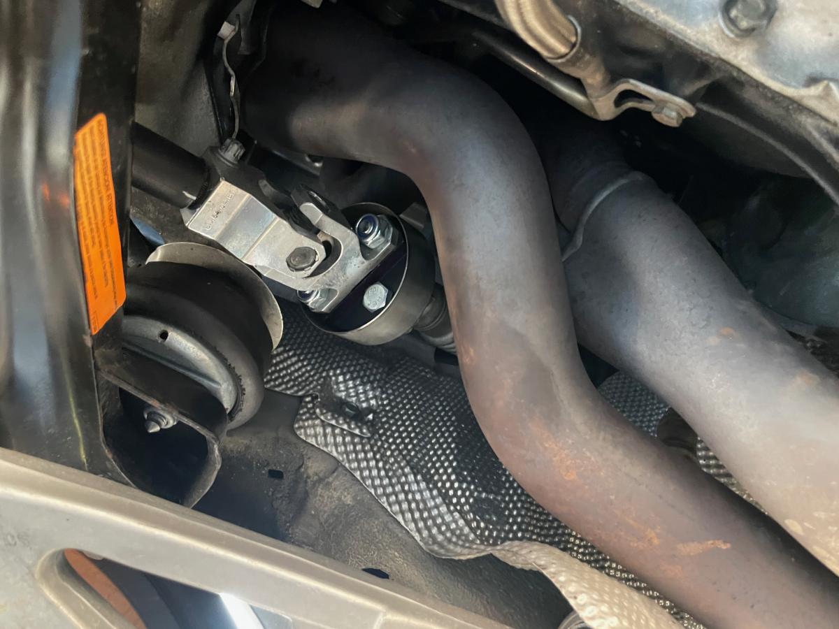

          Quick project today to replace the rubber steering giubo with a solid coupler from CMP. In the last little while I've had noticeable deadness around centre. The car tracks fine on the road, but small steering inputs are annoying as you have to steer through the deadness before you can make adjustments. I thought it was likely this was the giubo, but can never tell until you try it.
          Note: For those of you with LHD please note that you cannot use this item in your LHD car. LHD cars rely on the rubber giubo to account for the slight off-axis play needed in the LHD column. The RHD coupler is different and includes a universal joint, so a solid coupler like this is just fine for RHD, but a no-go for LHD. I recently saw a very sad thread on Facebook where someone asked for peoples' experience with the CMP solid coupler and it was roundly rubbished by a number of people who had used it on their LHD car. Shame for CMP as they make it clear it is an RHD part and sucks to see uninformed customers rubbish a product when they're the ones who have used it incorrectly.
          Anyhow - this was a pretty quick project. I'd painted the coupler with matte black enamel as I'm not keen on the flashy purple for my build. The removal of the coupler is trivial, dismantling it and rebuilding is likewise simple so long as you take your time and make sure you prepare the mating surfaces well. All up the project took me about 3 hours to do.
          Click image for larger version  Name:	IMG_9034.jpg Views:	0 Size:	115.8 KB ID:	266395
          From reading about others experiences of before and after with a solid coupler I was expecting a mild improvement and no additional NVH.
          Mine must have been very worn as the difference between before and after was not mild. I could tell as soon as I started manoeuvring the car in the driveway. The rubber was not broken or degraded in any way, but was soft, so the solid coupler has made a massive difference. Steering play is gone and the steering feels more direct and is less spongy. As expected I don't get any unpleasant NVH - just more precise steering control.
          $100 well spent.
            Did you notice any change to the granularity of steering feel? When I went to a double u-joint solid shaft on my LHD car I got additional ‘micro’ feedback. I replaced a brand new guibo and even mine was a big difference!
              To be honest I only got to take it for a very quick test after I finished (before shipping wife off to a hotel for the weekend to relax) so I haven't driven it enough to fully appreciate the improvement yet. I'm hoping to take it for a longer drive later today and will report back after I have. If I do notice the same as you describe I'll be very pleased indeed!

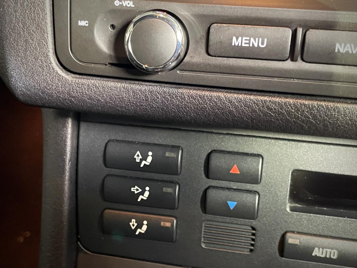

                The buttons are okay, at first glance they match the rest of the E46 buttons but there's a couple of things that aren't quite right. Firstly the typeface is not correct :-( It would have been really great to see Xtrons matching this properly. Secondly the white parts of the buttons which illuminate seem to have a slight translucency to them compared to the genuine buttons, which gives them a slightly different look especially under brighter light. These things aside the buttons feel pretty good, although if you press hard on the outer buttons you can see the adjustment knobs flex slightly, presumably the board the buttons and knobs are attached to isn't supported as well as it could be. The centre button is in fact not a button, but a is a removable cover for the micro SD card. This is a pretty good solution, but of course means that the centre button doesn't illuminate, again a slight annoyance.
                The control knobs actually fit the interior pretty well. The chrome seems off in isolation, but particularly in my SMG it helps tie everything together, matching the chrome on the lighter cover and the SMG shifter/ring. I'm counting this as a win. The knobs themselves aren't anything to write home about (not compared to the items on the OE stereo), but they're not awful, and they work well enough.
                Other things to note. The headunit body is black plastic, that in texture matches well. In colour, if you look closely (it's more apparent in the photos than in real life) the black has a different base to the rest of the car. The Xtrons black is warmer/yellower than the OE black (which is cooler/more cyan). In practice this isn't really noticeable, but worth calling out to be aware of.
                I mentioned above that the unit is well dimensioned and fits well. This is true in all regards with one exception. The clip receptacle for the dash trim that runs above the radio is simply not right. I had to significantly modify this downwards in order to fit the trim correctly without it being pushed up. Photo below shows how much it's off by.

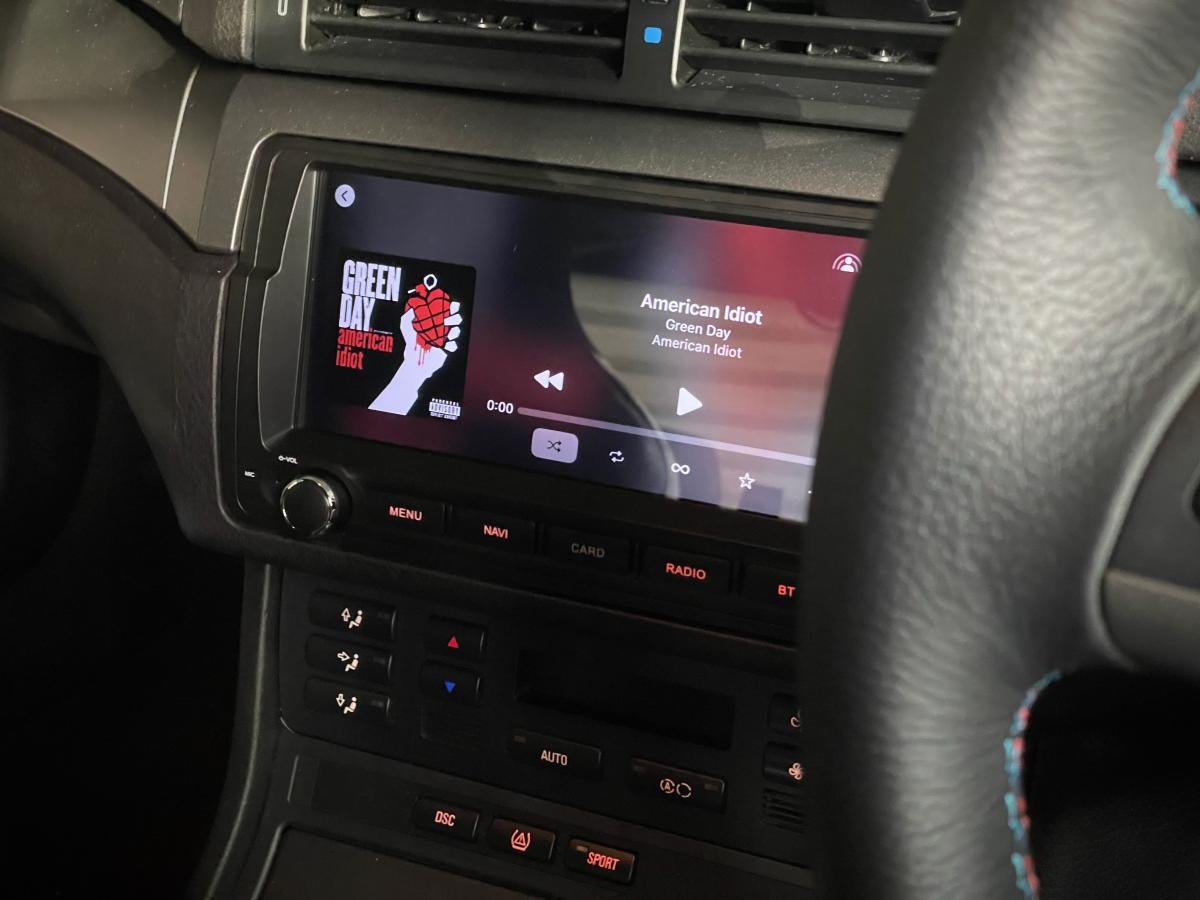

                Performance
                The headunit is blindingly fast. Navigating the OS/apps is seamless, every transition is smooth, I have zero complaints about performance.

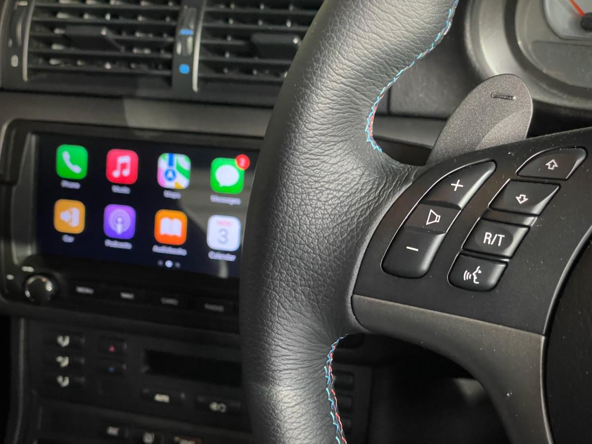

                CarPlay
                CarPlay support was the key reason for me making this upgrade, if it didn't work reliably then the unit would be a no-go for me. First-time I turned the unit on and connected my phone to bluetooth CarPlay (actually the ZLink app) fired up. It's so satisfying to get into the car with your phone in your pocket, and by the time you're reversing out of the garage CarPlay has fired up and you're listening to your music.
                And how has the reliability been? To begin with, from time to time (every couple of weeks) I'd encounter an issue where I'd get into the car and CarPlay simply wouldn't connect. The headunit would show my phone was connected, and my phone would show that it was connected to the headunit, but no dice. Seems like not a very good start, however at the same time I was having trouble with my phone connecting to the wired CarPlay in our MG ZS EV (exactly the same symptoms). Secondly the way to resolve the issue was to reboot my phone (nothing needed to be done on the headunit side in either car). These two things made me suspect the issue lay with iOS/my phone, and indeed this was subsequently proven true when an iOS update (can't remember what version) was released in March, and the occasional issue simultaneously stopped happening with both vehicles.
                Since then CarPlay has been perfect - it works exactly as I hoped it would.

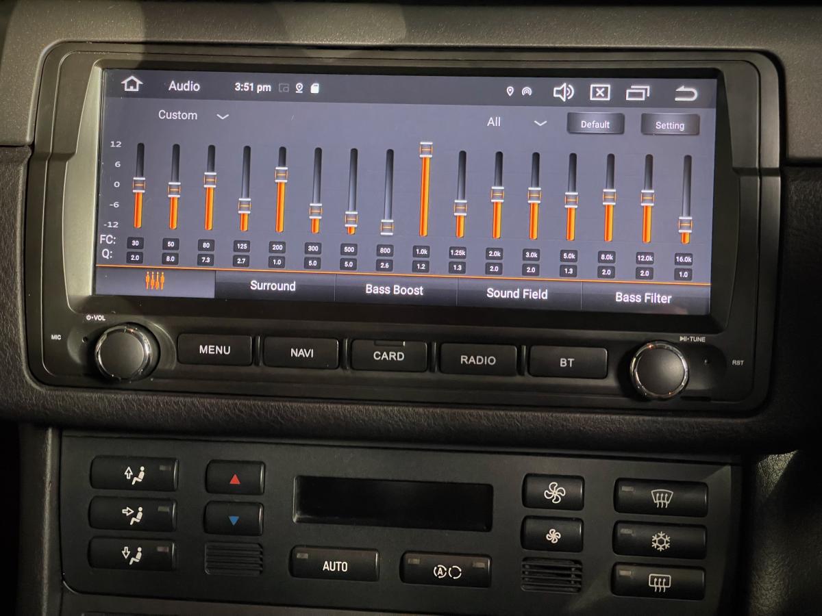

                Audio Quality
                I will caution my comments here by saying I am in no way an audiophile.
                Audio quality, to be honest I cannot tell any particular difference between the Xtrons and the OE radio the sound that the Xtrons produces is entirely acceptable to me and I have no complaints. Noise is very low and is not noticeable. There is an issue with some IX units whereby the difference between volume level 4 and volume level 5 is larger than it should be. Xtrons are supposedly working on a fix for this, but it hasn't bothered me as this is outside of my normal range of use anyway, so isn't affecting me. I'll patch the unit when the patch is available and report back on this.
                In one of my earlier posts I describe how I used HouseCurve and REW to generate DSP settings for the built-in DSP in the Xtrons unit. This resulted in a significant (as in even I could tell the improvement) improvement and I'm very pleased I went to the trouble of doing this (this isn't about the headunit so much as tuning it to the car's speakers and soundstage.

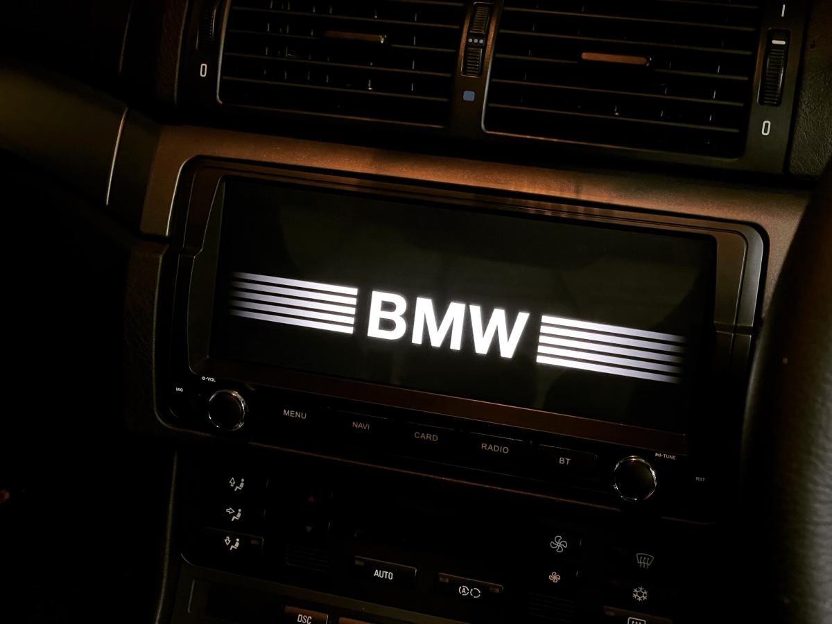

                1: I loaded a custom boot logo to the unit. This boot logo is a high-res reproduction of the original boot logo on the E46 nav. I feel it's a nice additional touch to make the unit feel more OE. It's worth noting that others report seeing a "Powered by Android" logo as well. I only ever see this if I do a hard reboot of the unit, I never ever see this in day to day use. I don't know why, or what setting I might/might not have that impacts this, but worth calling out.

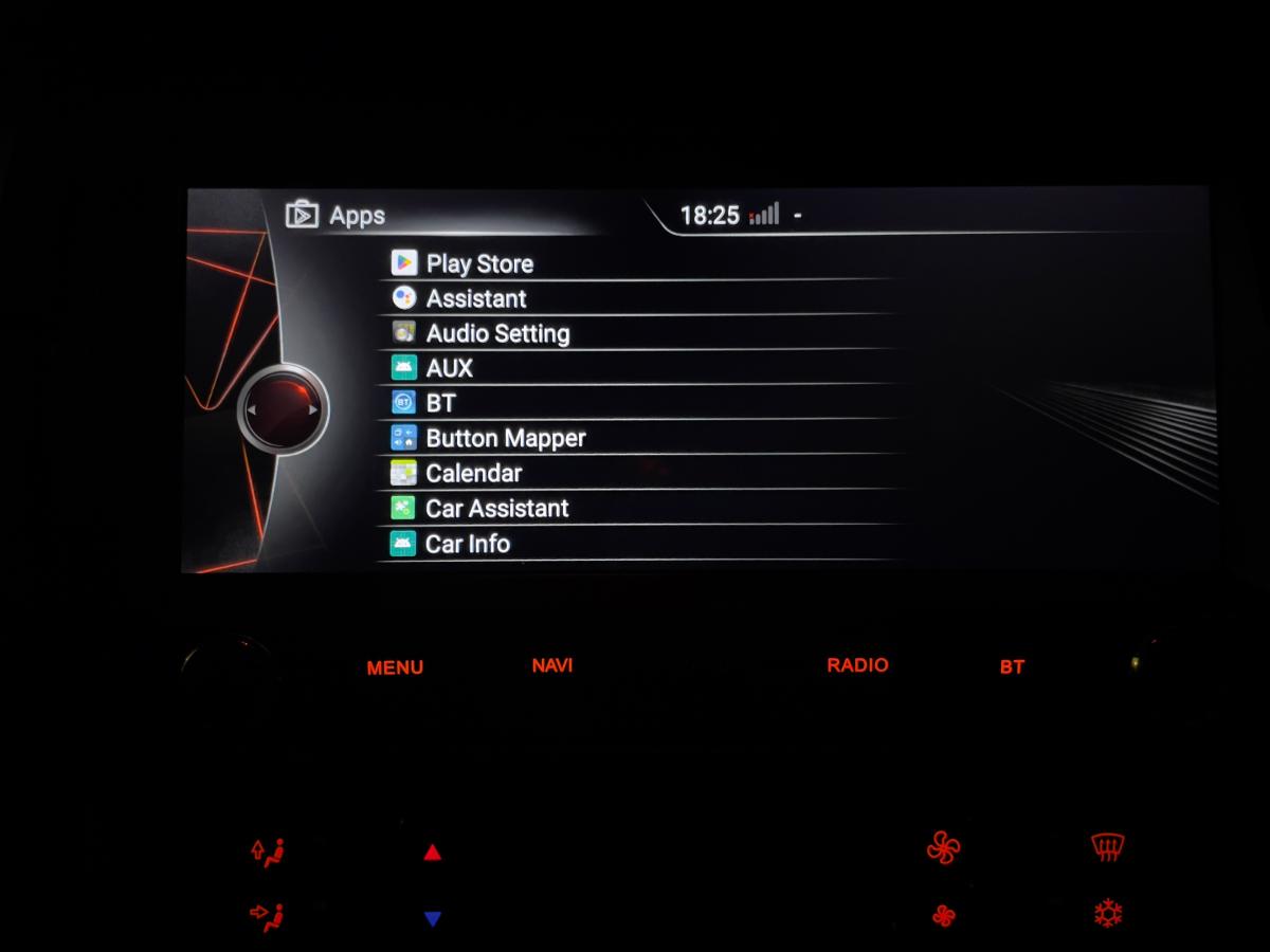

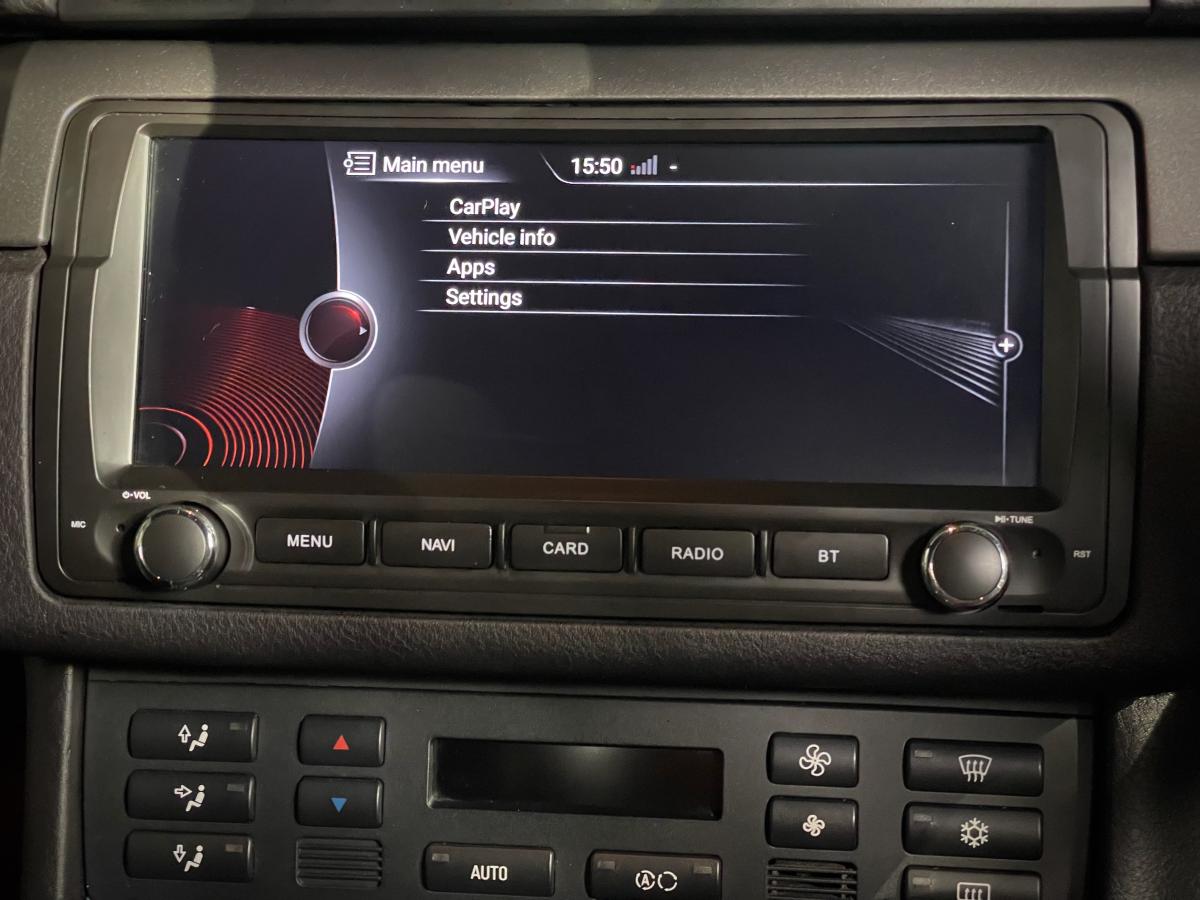

                2: I've replaced the Xtrons launcher with iDrive Launcher which is a fantastic, well put together, piece of software which further does wonders to make the unit feel like it fits in the E46 interior.

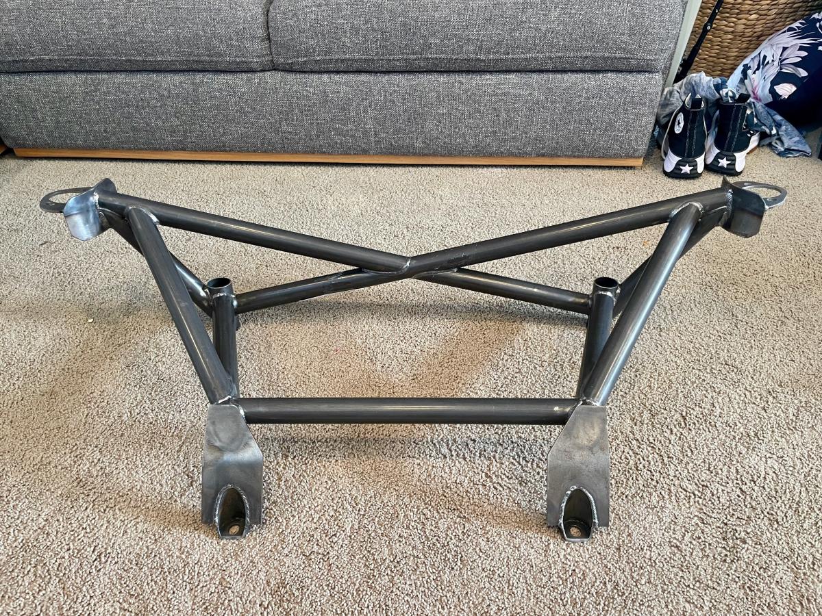

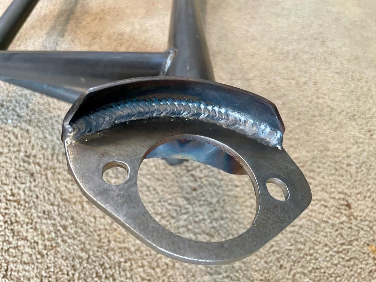

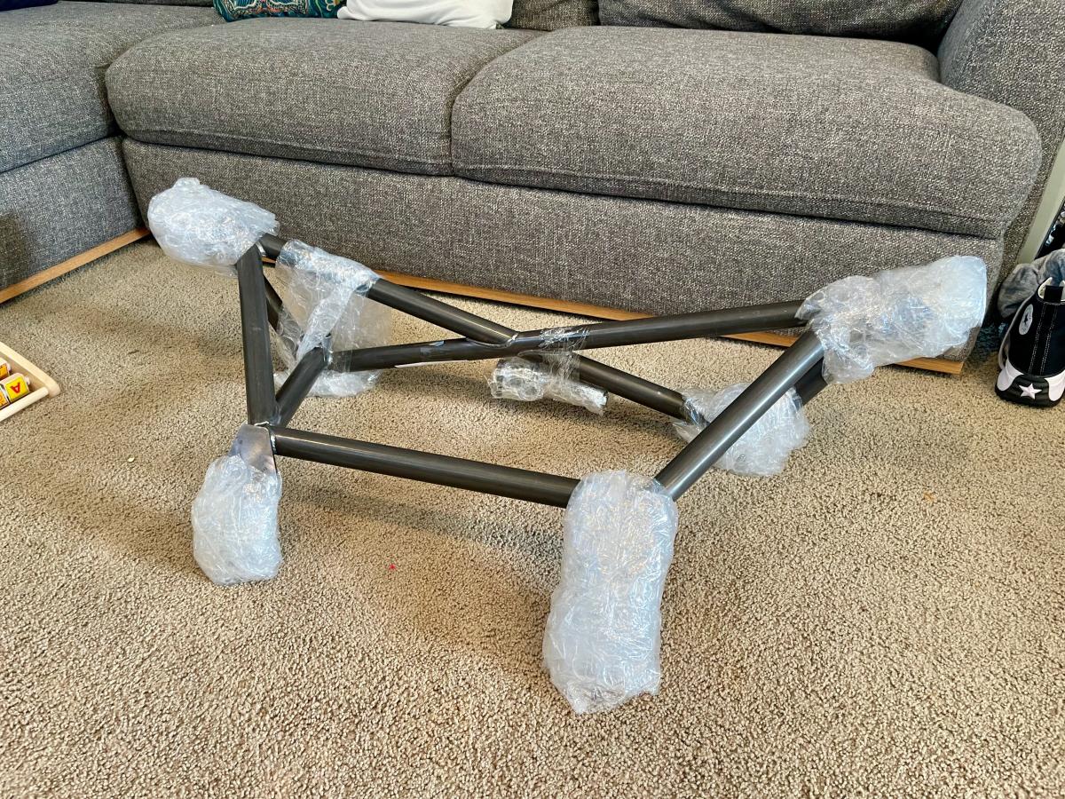

                    Pleasant surprise this morning - look what arrived!

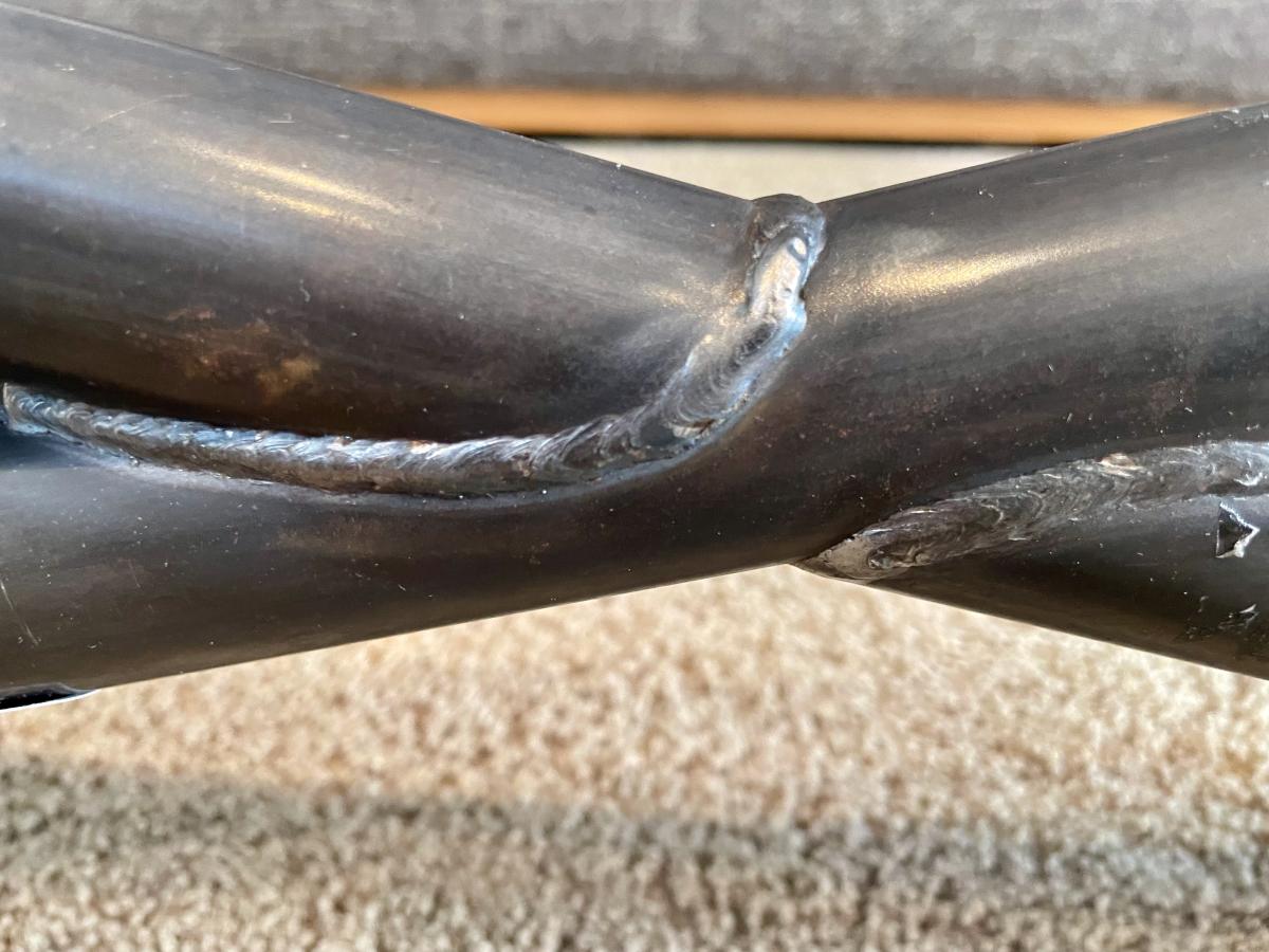

                    The box it arrived in was a bit beaten up, but when opening up you can see that the sharp corners are well-wrapped in bubble wrap to protect whatever else it comes into contact with 😂
                    Marin offers powder-coating as well, but after discussing with him I opted to get it unfinished and powder-coat locally, as a painted item requires much more packaging to protect it and pushes it into a more expensive shipping category.
                    I was a bit surprised when I first opened it to see that the brace doesn't have the extra cross member between the strut towers, but looking back on my comms with Marin when I actually placed the order I was not clear on the matter. Secondly, now that I've seen this in person I can say that that additional cross member would be entirely unnecessary anyway. The photos (especially the ones online) really do not give a good sense of just how solid this thing is. I'm glad that it turned out this way as not having that cross member means more available boot space for any odd-shaped objects.
                    I'm very happy with the build quality of this and just how solid it is in person. I'm looking forward to getting it powder coated and ordering the other bits and pieces I need to get this installed.

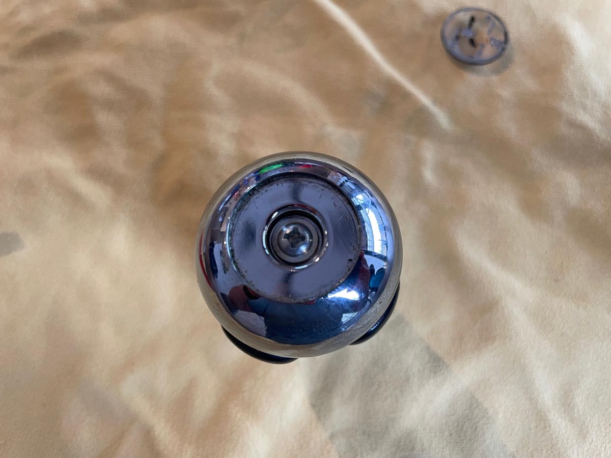

                      Embarked on a bit of an experiment this afternoon.

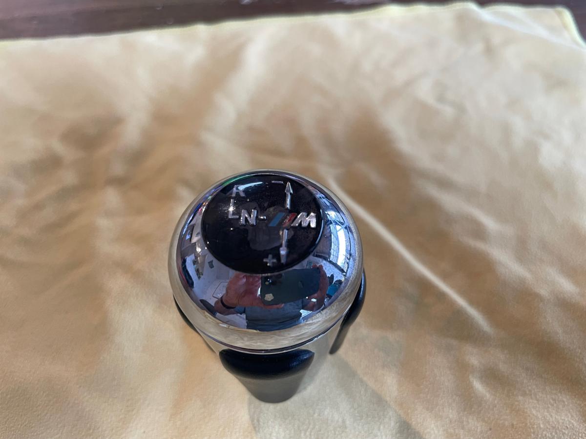

                      The SMG shifter on my car is actually in pretty great condition considering it's nearly 20 years old. Aside from needing a clean really the only wear/damage on it is the emblem has bubbled as they tend to do, the pads and the chrome are otherwise in excellent condition.
                      BMW do not sell the emblem separately, and although you can get replicas off eBay, they are poor quality (essentially printed with a dome on top) and don't replicate the 3D chrome embossing, etc. that the original does.
                      I thought therefore that I would pull the knob apart and see if I could work out a way to repair it. If I fail then I can just go ahead with the original plan to buy a new one. If I succeed I'll probably still buy a new one anyway and put it on the shelf for the future, but I can then continue using my existing one.
                      Removing the knob from the shifter was actually easier than I was expecting. A moderate amount of force and off it came. You can see the bubbled emblem in this photo (although if you own an SMG you probably already know what I'm talking about).

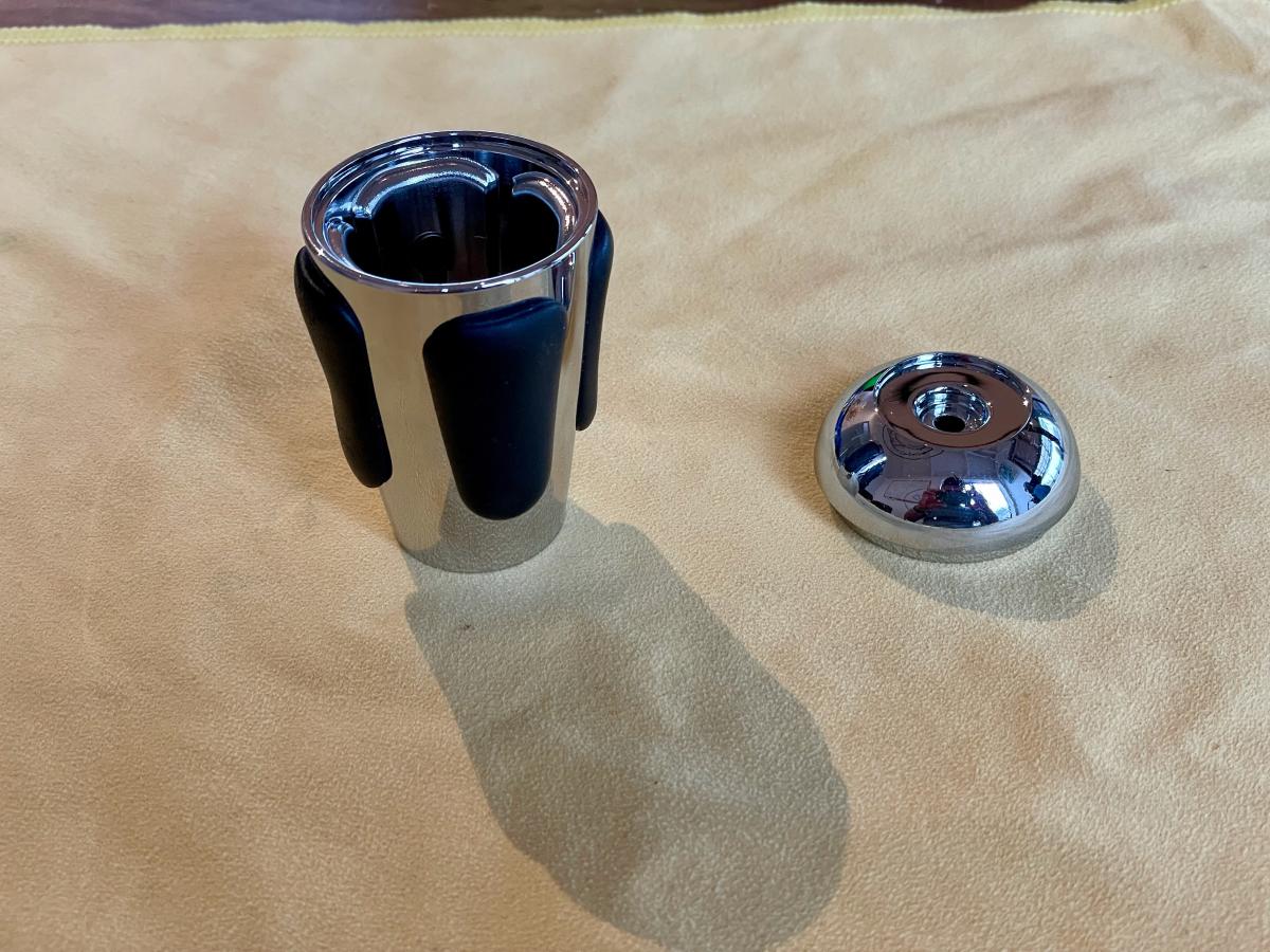

                      With the dome off the rest of the knob can be disassembled. Once in pieces I carefully cleaned everything up (vinegar and water on the chrome to clean on any staining, and then warm soapy water for a general clean and to clean the pads).

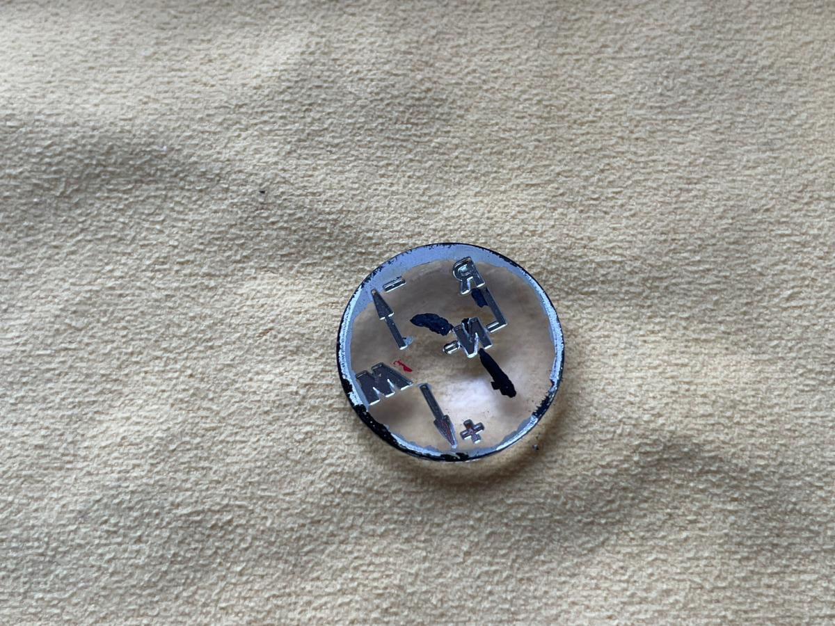

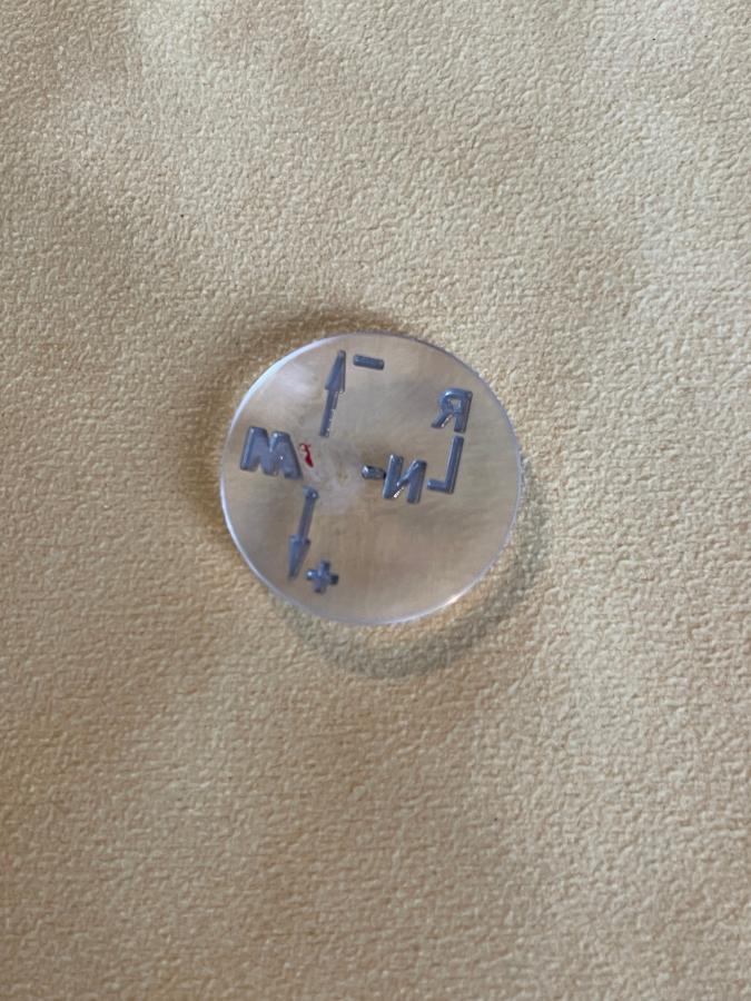

                      I then turned my attention to the emblem. The chrome embossing is essentially milled/cast in relief on the underside of the dome, and then chrome plated. The flat back of the dome then affixes to the black background which also has the coloured M stripes on it. My intention in attempting repair is to paint on the M stripes, and then paint the entire rear surface of the dome black. The finished item can then be reaffixed to the knob. Why paint? It's going to be the only way to get a perfect bond to the dome. Otherwise without this it's still going to look like there's an air bubble in there. I am not going to attempt the painting myself, rather I am going to get my brother (who has been expertly painting very tiny things for a long time) to give it a go - if he can't do it I certainly wouldn't be able to.
                      But before it can be painted I needed to clean up the dome.
                      I very carefully wet sanded the back surface of the dome with 2000 grit sandpaper. It can't be seen in the photos but where the coloured M stripes go you can actually see on the surface of the dome where the colours lay. I was very careful to not sand this area, in order to retain this as it may be useful for my brother when it comes to applying the colour.
                      I'll get the dome to him next weekend for him to have a go. The nice thing is that if anything doesn't go to plan it can just be sanded off and attempted again.
                      In the meantime here's a photo of the rest of the knob all cleaned up and ready to go. The pads in particular look so nice now they're back to a lovely matte black.
