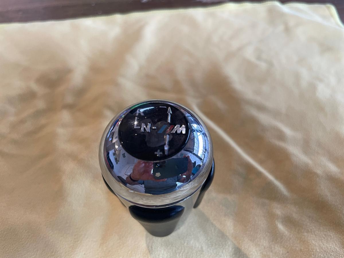

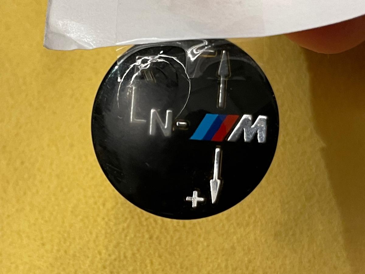

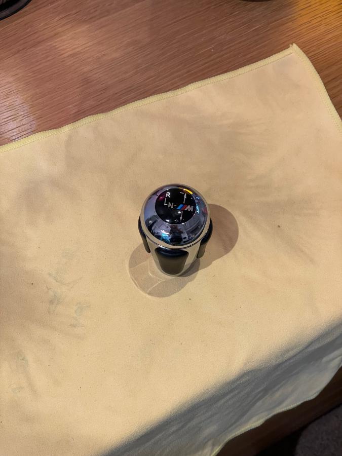

                  Well that worked better than I could have hoped!
                  The enamel paints arrived in the week and my wife is out this evening, so while I was keeping an eye on the boys I decided to do some colour tests. That went well and I had a go at painting by hand. I'm absolutely not skilled enough for it, but then I tried masking with sellotape and that worked surprisingly well, I was expecting the paint to seep badly, but it was very minimal.
                  I very carefully masked for painting the light blue and the red and did those first. I found it was best to let the paint set for about 15-20 minutes before removing the masking (I didn't want to leave it too long and lift the paint with the tape).
                  I then allowed an hour for drying, and then masked for the dark blue and painted that, another 15-20 mins for the masking and then another hour to harden. I then very carefully cleaned up the edges with a sharp knife before applying the black paint.
                  For a hand-made effort I'm very happy with the end result. With the macro shot below you can see it's not perfect, but with the naked eye it looks perfect.
                  Great success!

                    If I'd known in advance how well this was going to work I'd have taken proper before and after photos, but first photo is about the best shot I've got of the bubbled dome.
                    And the end result!
