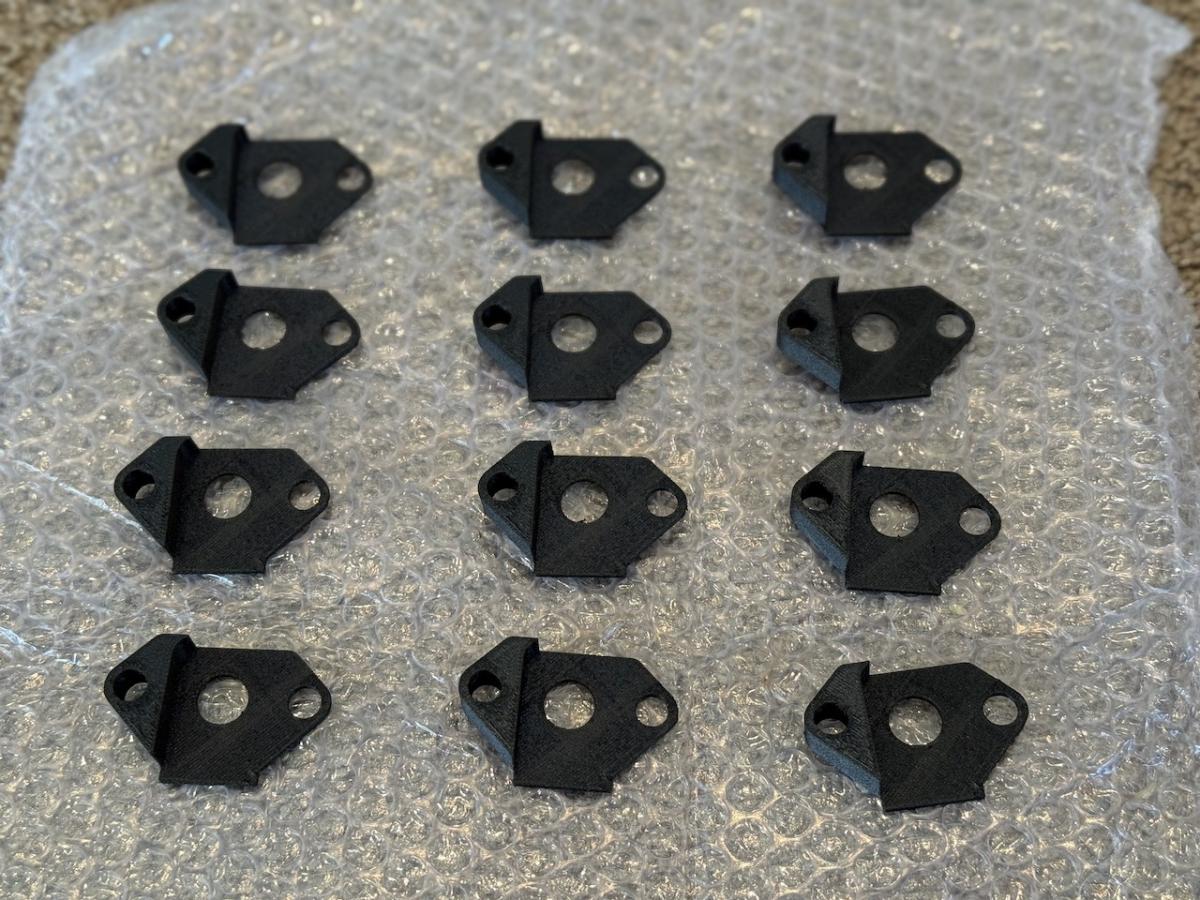

        The MAP sensor adapter printed in CF-reinforced Nylon arrived today. Minimum order value applied so I'm now the proud owner of 12 of these.
        I'll try to install in the next couple of days. HDT is significantly higher than the CF-PETG I used previously.

          I can always take one off of your hands. Let me know brother.
            Click image for larger version Name:	IMG_2274.jpg Views:	0 Size:	187.7 KB ID:	306677
            Yeah send me one as well since you said not to use the previous one 😂
              that would be awesome, sign me up as well

                Oh and also gave the nylon MAP sensor adapter a couple of good heat cycles and then took it off and inspected it - appears to be unaffected by the heat so far, so off to a good start.

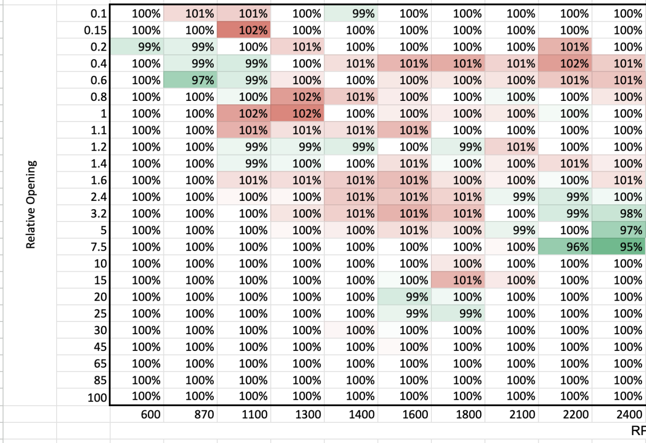

                          I've been doing a bunch of playing around with the VE tuning process for a couple of reasons:
                          Firstly when I was working through documenting how the CSL MAP Sensor is used in the DME it occurred to me that it was probably a good idea to take the MAP Sensor out of the loop of the RF calculation while performing the VE tuning process, as otherwise it would be compensating for underlying inaccuracies in the VE table and otherwise masking and making things more difficult.
                          Secondly when going through the disassembly in detail I uncovered that the AQ_REL value that is logged from DS2 (in TestO) is not in fact the value that is used for the CSL AlphaN table. Rather a modified form of AQ_REL is used which inflates the AQ_REL value by a varying amount below 2400 RPM.
                          Addressing the first piece is a case of changing a parameter in the partial binary to disable the MAP sensor, and I solved the second piece with a spreadsheet to convert TestO logs before putting them through the rest of the VE tuning process.
                          This has been a great success. In the space of 3 tuning runs I've gone from something that (even after earlier VE tuning without addressing these two things) felt like an AlphaN tune (which it absolutely is with the MAP sensor turned off), to something so good, it feels like the MAP sensor is enabled, even though it isn't. (of course this won't extend to changing atmospheric conditions, etc. but gives you an idea of the improvement). Particularly low RPM rev matching is superb now with the AQ_REL values that are logged being accurately used to adjust the VE table.
                          After just 3 runs everything is consolidating beautifully around a lambda of 1.0. (the couple of cells that show greater change are cells that I didn't manage to hit in previous runs).
                          Click image for larger version  Name:	Screenshot 2025-06-12 at 8.33.52 PM.png Views:	0 Size:	610.3 KB ID:	308185

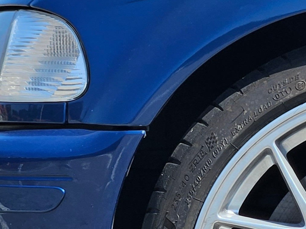

                            Well I found a circumferential crack in the inside wall of the front right today... The tires are old and I've been keeping an eye on them for this exact reason. I was hoping to get another 6-12 months out of them, but that's not going to happen and I need to get this sorted.
                            My plan was (and probably still is) to shelve the 19in Style 67's and get some 18in ARC-8's (original I know, but quite simply can't come up with a better weight/quality/value/looks combination) and buy the new rubber for those rather than the 19s. I'm focused on driving experience and the 18s will be much better suited to Auckland roads than the 19s plus the weight savings will be very welcome.
                            I'm thinking to go with 8.5" fronts and 9.5" rears with ETs to match to keep close to CSL spec. Apex suggest 235/40 for the fronts and 265/35 for the rears, but Michelin PS4S's don't come in a 235/40R18, so I'm wondering whether 225/45 and 255/40 would be a suitable option as that's very close to OE specs as it pertains to circumference.
                              Unconventional suggestion: run 18x9 et42 245/40/18 front with 18x9.5 255/40/18 rear
                                Hmm, they definitely do. Have a set on my car right now
