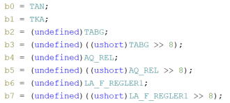

                  On Thursday I got stuck into the additional CAN message project. As a recap the idea here is to add an additional function into the 0401 program binary to send an additional CAN message.
                  I've given the new message the ARBID of 0x7D0 which makes it lower priority than all other CAN messages. The format of the message is:

                  There's basically 4 parts to achieving this:
                  1: Create a new function that replicates the existing function to send CAN messages from the DME. It needs to be recreated as we need space for the extra instructions to call an additional CAN message.
                  2: Modify the 10ms task to point to our new function instead of the original.
                  3: Load our new CAN message definition into the CAN config table in the program ROM.
                  4: Create a new function to assemble the new CAN message and push the frame to the CAN buffer.
                  The fun part is that this needs to be done by modifying the machine code in the binary, no easy way to write assembly or C here!
                  I got the above done on Thursday, spent code-checking it and then flashed it to my car on Saturday morning. As soon as I turned the ignition on I could tell something was wrong as the DSC light was flashing. All modules relying on outbound CAN were throwing errors. A review of what I'd done revealed a dumb mistake. I was trying to use slot 17 of a 15 slot buffer 🤦‍♂️. Anyway it was an easy fix and v1.1 ran without issue, and I connected to the MK60 with INPA and could view live CAN data, so I knew the standard CAN messages were working fine.
                  I'm not actually set up for CAN logging so at this point I shipped the binary off to Bryson for further testing.

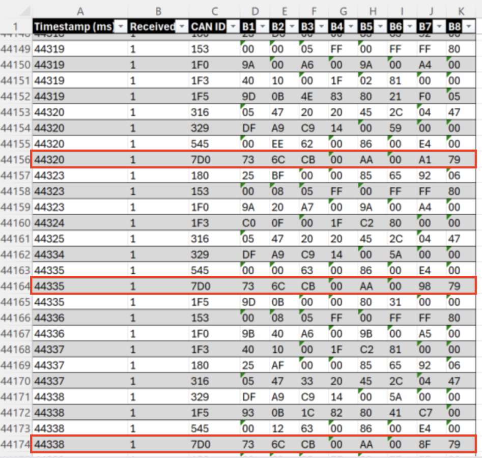

                  I was very excited to get this back from him showing the new message being logged:
Name:	Screenshot 2025-06-22 at 10.34.00 AM.png
                  Bryson then setup his logger with the appropriate conversion factors and has been able to log AQ_REL, Lambda Integrator, etc. at 100Hz instead of the 5Hz or so that you get over DS2. He's posted a link to the log which you can find in his post here
                  I'm super stoked that this has worked out. In addition to being very useful for tuning, it also proves that these sorts of modifications are possible and that the disassembly work is good enough to understand what's going on to the degree that it's possible to make working changes and additions to the program.

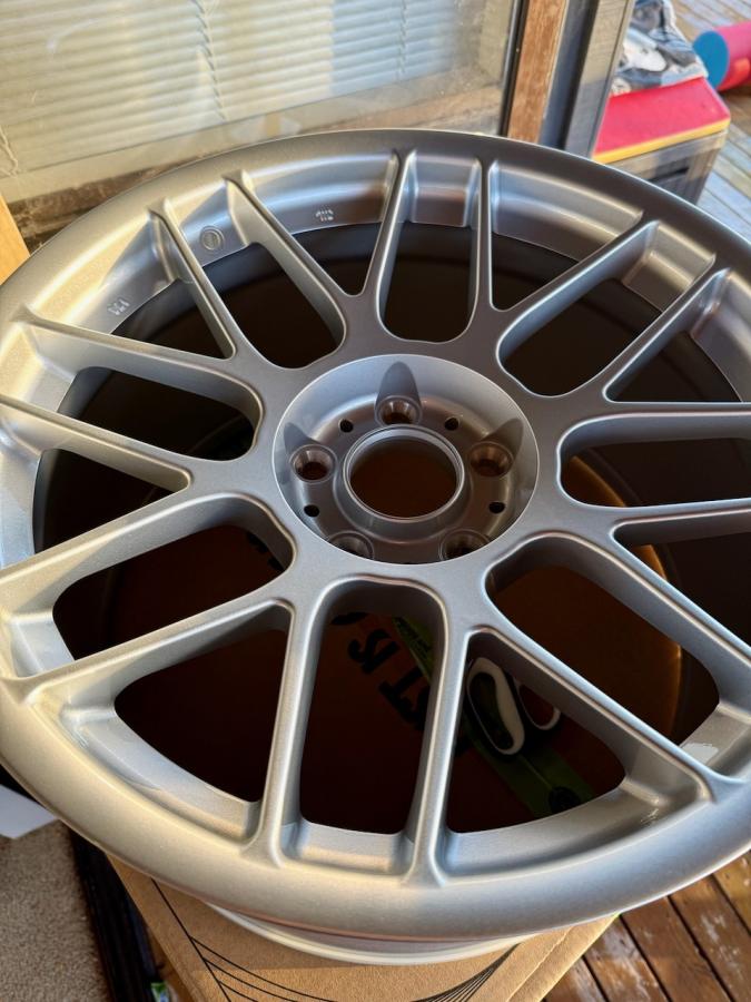

                      Couple of updates:
                      1: The wheels arrived today 🎉 Mandatory photo, although we all already know what ARC8's look like 🙃

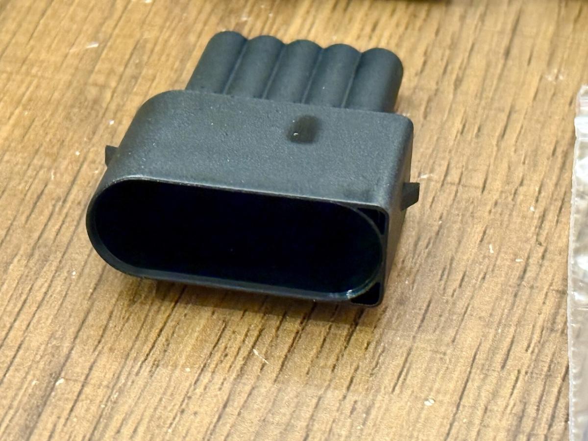

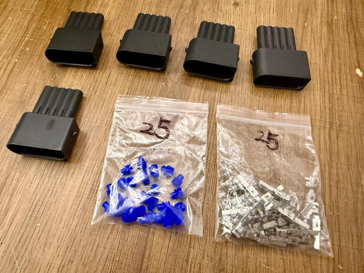

                      2: The male MAF sensor connectors arrived. I don't actually have need of these for myself, but I finally came across them and thought I'd order some to confirm they're a match and if so share the details with everyone as saves having to pay Turner money for their relocation harnesses.
                      These things appear to be the exact same item Turner are using and they come with the pins and seals.
                      I ordered 5 of these for the princely sum of $9.58USD total including shipping. per-unit price is $1.24USD.

                      You can purchase your own (you can order singles) here: https://www.hdconnectorstore.com/productdetail/32496.html

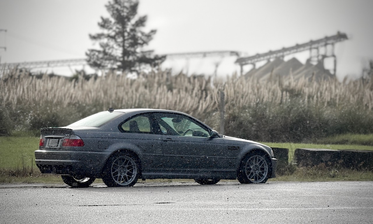

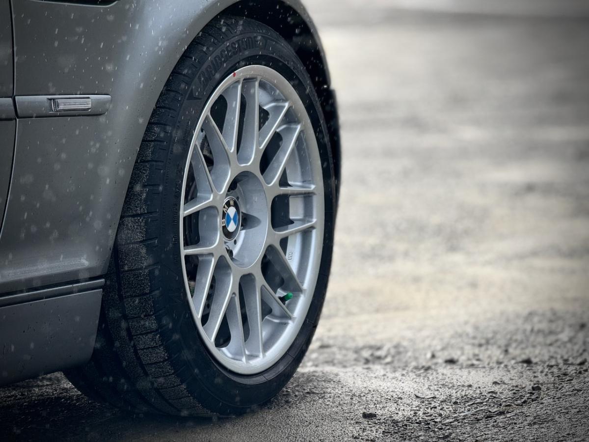

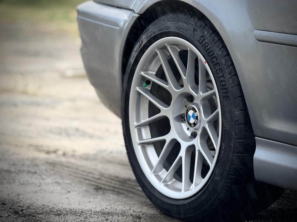

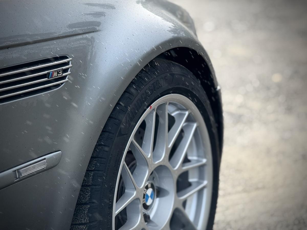

                          Like heinzboehmer I've very much missed driving the car while it's been laid up, so like him when I got it back on the road a short test drive turned into a longer one. Only I ended up at a slightly less globally-famous landmark. The Mt Rex sand processing facility in Helensville 😂 Also, it's winter here, it was raining, and the sun was in the wrong place.

                            Looks great and very glad you’re happy with the wheel/tire setup. Now I know for sure what wheel/tire setup I’ll be running if I ever do the widebody
                              Looks great and very glad you're happy with the wheel/tire setup. Now I know for sure what wheel/tire setup I'll be running if I ever do the widebody
                              I completely forgot to mention looks haha! Have to say that although looks weren't high on the priority list I do love how the 9in fronts fill out the front wheel wells and make the car look a bit more aggressive and purposeful without being OTT. And of course the ARC-8s are a classic look in their own right for the E46.
                                Hell yeah man! Car is looking great. Glad it's back on the road.
                                The RE71-RS's while the stickiness would have been giggle-worthy, don't give the same degree of feedback and would be impractical in wet conditions, so the Sport it is.
                                You made the right choice. Probably an unpopular opinion, but I think "track-y" 200 tw tires suck on the street. They're noisy, uncomfortable and aren't really all that fun until you get some heat into them (at which point you have to get out of the car and adjust tire pressures). Also, they're skeeetchy in the wet. I've hydroplaned real bad on the highway on the way to the track with them, not fun at all.
                                Don't get me wrong, I love my RE71-RSs on track, but I'm always happy to swap back to my street tires after driving home for a couple hours.
