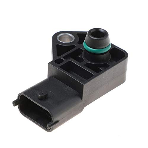

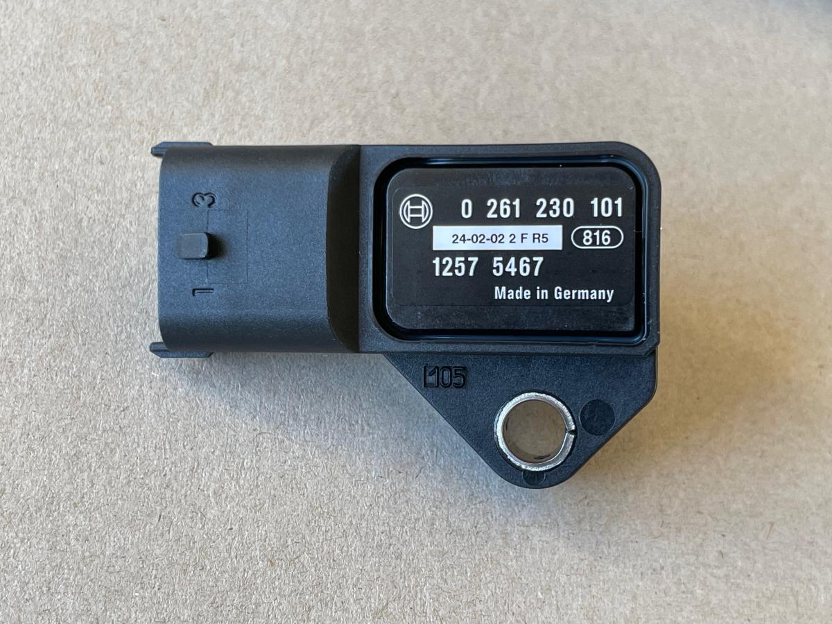

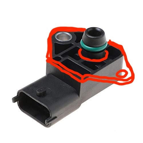

        So what I'm envisaging is something like this.
        The sensor itself has 1 mounting hole.
        Click image for larger version Name:	41AUbKmq6YL.jpg Views:	0 Size:	23.3 KB ID:	269564
        And supposedly the sensor needs to be stood off from the air rail by about 1.5mm. So what I'm thinking is making up a 3D printed piece that is made up of a 1.5mm thick surface across the mating face of the sensor, plus also the "missing mounting point" on the other side of the sensor. The idea would be that it could be bonded to the sensor and the end result would be a sensor that has two mounting wings and is the right size to mount to the rail.
        Here's a horrible mouse-drawing of what I mean:
        Click image for larger version Name:	41AUbKmq6YL-addition.jpg Views:	0 Size:	28.3 KB ID:	269565
        Ultimately though I need to get both the rail and sensor in hand to validate the fitment before going too far with this idea.

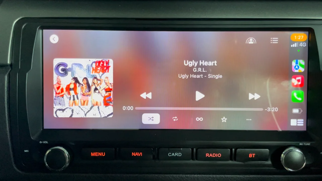

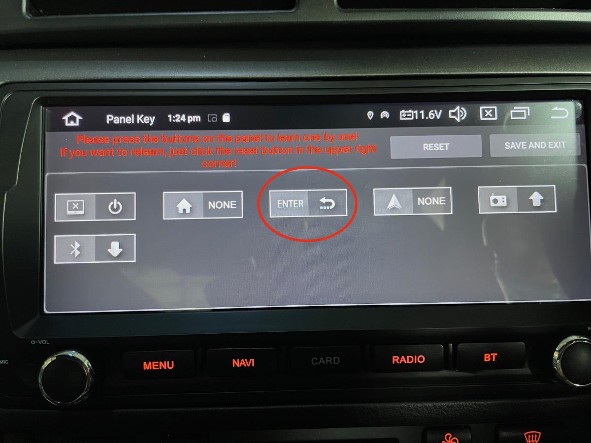

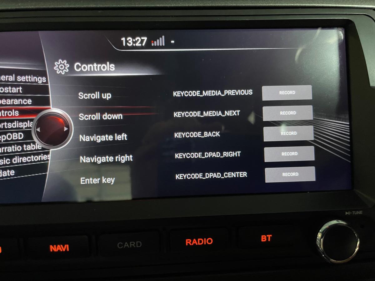

          Secondly I finally figured out how to get the right-hand encoder knob on the Xtrons mapped to iDrive Launcher to navigate the menus. See the video below for what I mean:
          The video ends when I hit play in CarPlay,presumably my phone can't video and drive CarPlay at the same time. But what I was trying to show was that when ZLink (CarPlay) is open, the right knob can still be used to play/pause and navigate forwards/backwards through your playlist.
          To get this working you need to configure the short and long press on the right encoder button as follows in Factory Settings -> Touch Settings -> Panel Key (You can ignore my mappings of other keys - they're from experimenting and are not important)
          Click image for larger version  Name:	IMG_9340.jpg Views:	0 Size:	96.9 KB ID:	270084
          And turn on Control Mappings and map "Scroll Up, Scroll Down, Navigate left and Enter key as follows in iDrive Launcher Settings -> Controls.
          Click image for larger version  Name:	IMG_9343.jpg Views:	0 Size:	94.2 KB ID:	270085
          I'm very happy to get this going as Android stereos are renowned for the right encoder not being mappable. on the IX8246BHL the rotary encoder is mapped to KEYCODE_MEDIA_PREVIOUS and KEYCODE_MEDIA_NEXT and it is the fact that it is mapped to actual Android key codes that makes this possible. Please note that I have no idea whether this would work on any other Xtrons unit - you'd have to try it yourself.
          Limitations? I'm not too sure of what all the limitations are as I'll need to play around with it more first, but I'll update here as I find anything. Very happy to have this working properly now. I don't have any particular day to day burning need for it, but it was annoying me that I had it almost working but not quite.

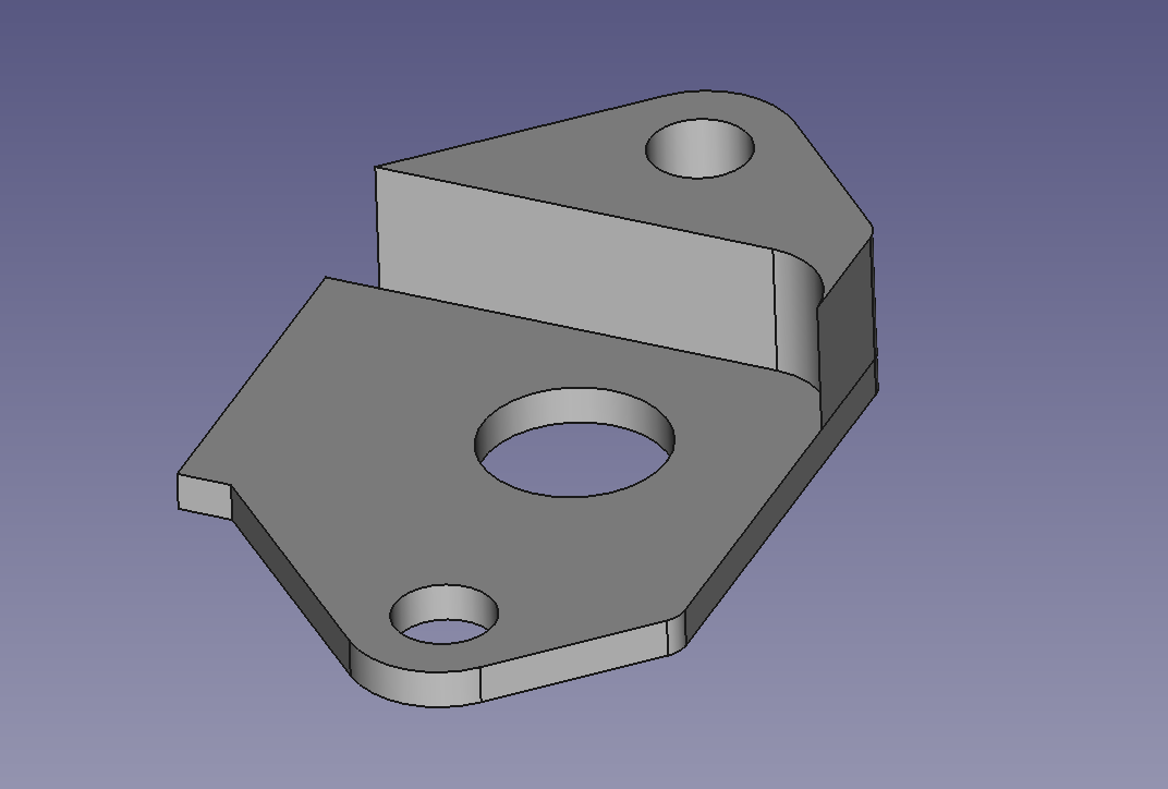

                      CAD Project 2: Adapter for Bosch *101 MAP sensor
                      As I mentioned above I plan to design an adapter for the Bosch *101 Map sensor to space it out from the air rail appropriately and add on the second mounting point. With the rail and sensor due in my hands next weekend I should be able to measure up and have everything I need to prove out this idea. Looking forward to seeing if this will work.

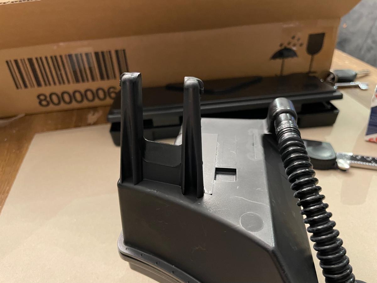

                        The CSL secondary air rail and SMG reservoir were waiting for me when I got home from work this afternoon.
                        I took the opportunity of having 1 out of 2 children with the grandparents and made a start on...
                        CAD Project 2: Adapter for Bosch *101 MAP sensor​

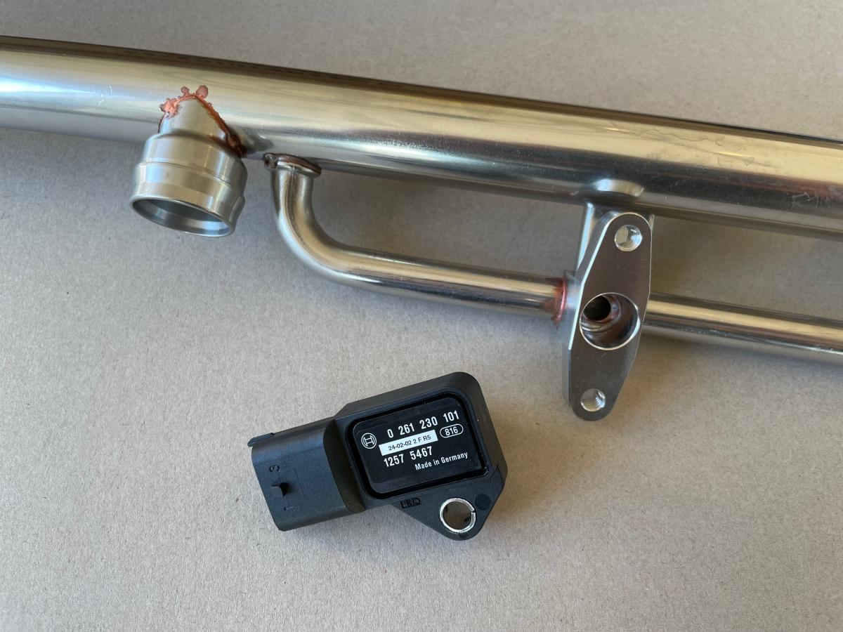

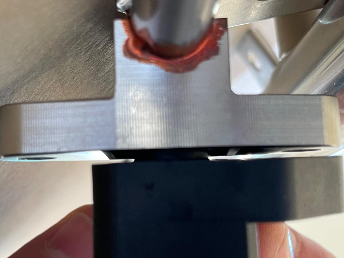

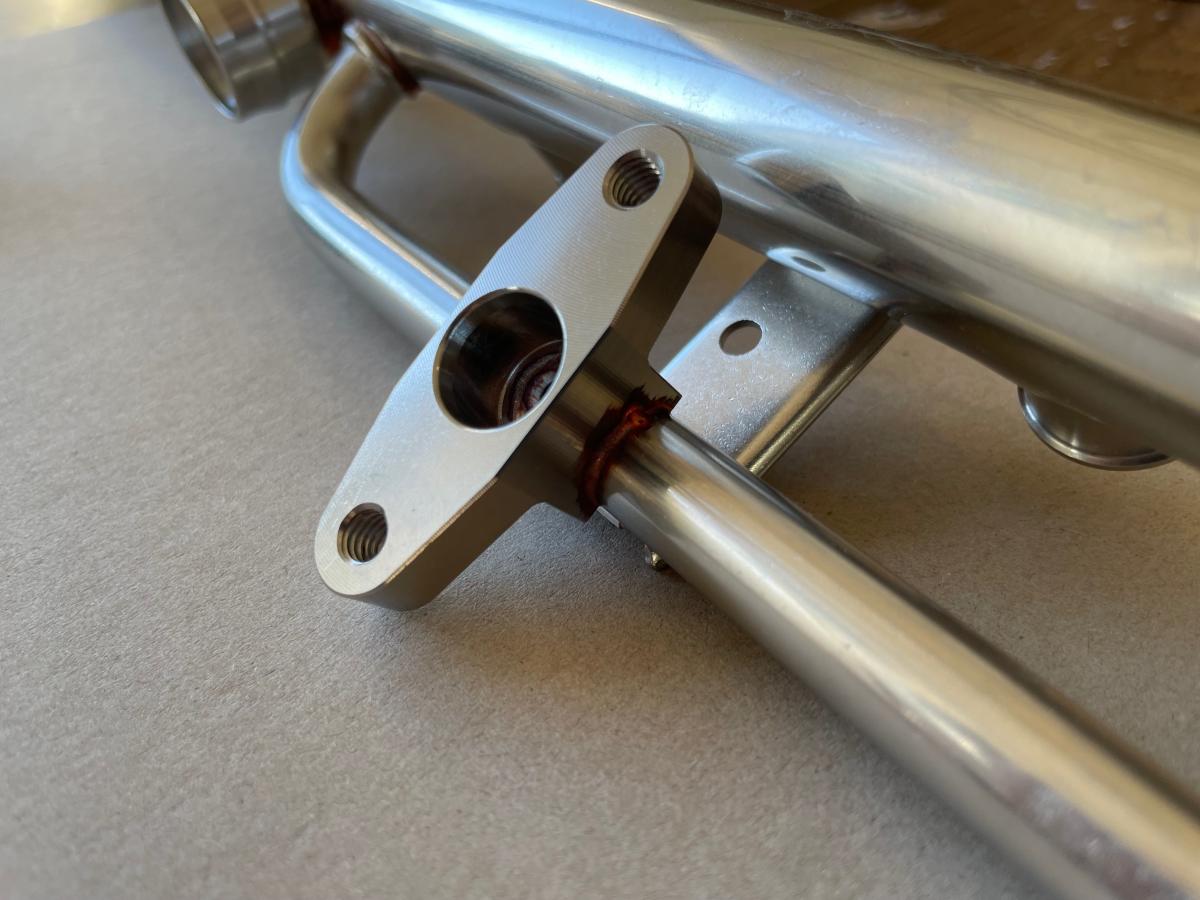

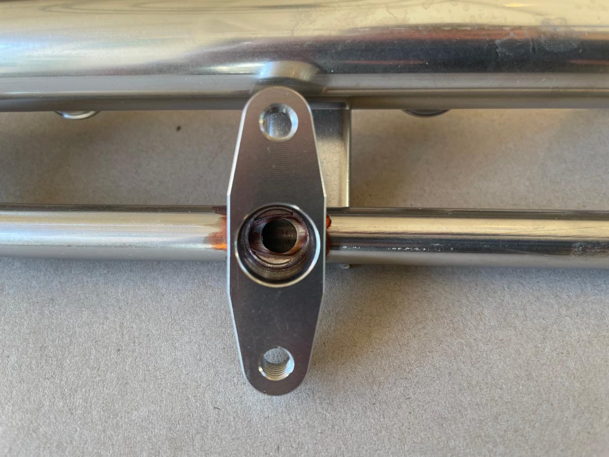

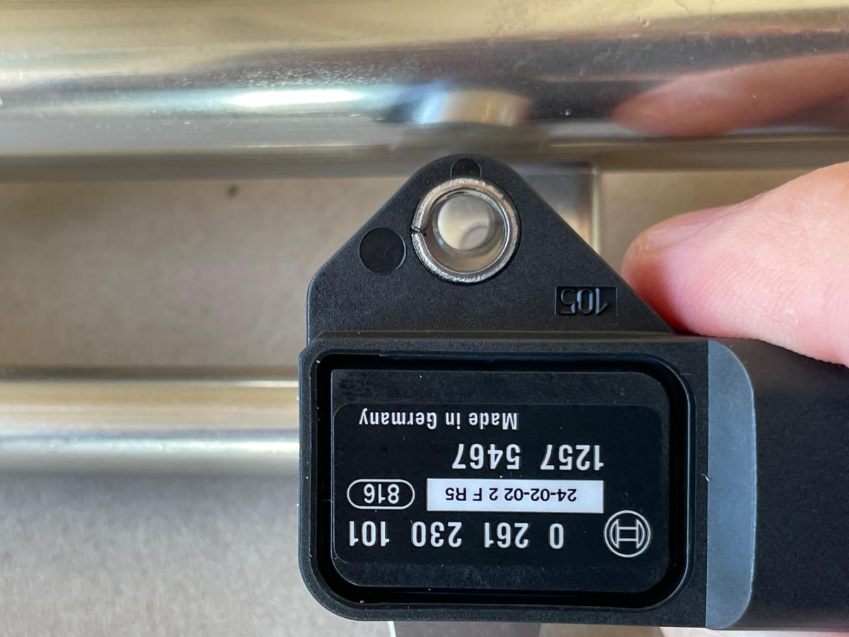

                        With the air rail and sensor now in hand I was able to check the fit and measure up:
                        Click image for larger version  Name:	IMG_9404.jpg Views:	0 Size:	140.8 KB ID:	271566
                        I was aware that you either have to trim the nozzle or stand off the sensor and that's fine, but I wasn't prepared for this:
                        Click image for larger version  Name:	IMG_9411.jpg Views:	0 Size:	100.1 KB ID:	271567
                        Now in practice this probably won't matter too much, but it's not as good a fit as I was expecting.
                        Also as I had read elsewhere the o-ring will need to be replaced for a correctly fitting item. It's far too loose in this application. If people are buying this sensor and just chucking it on it's not going to be a good seal/fit, there's work to do to make this fit decently.
                        So I decided to get on with it and draw up the stand-off plate + second mounting point. For reference here are a couple of close-ups of the mounting point on the rail.

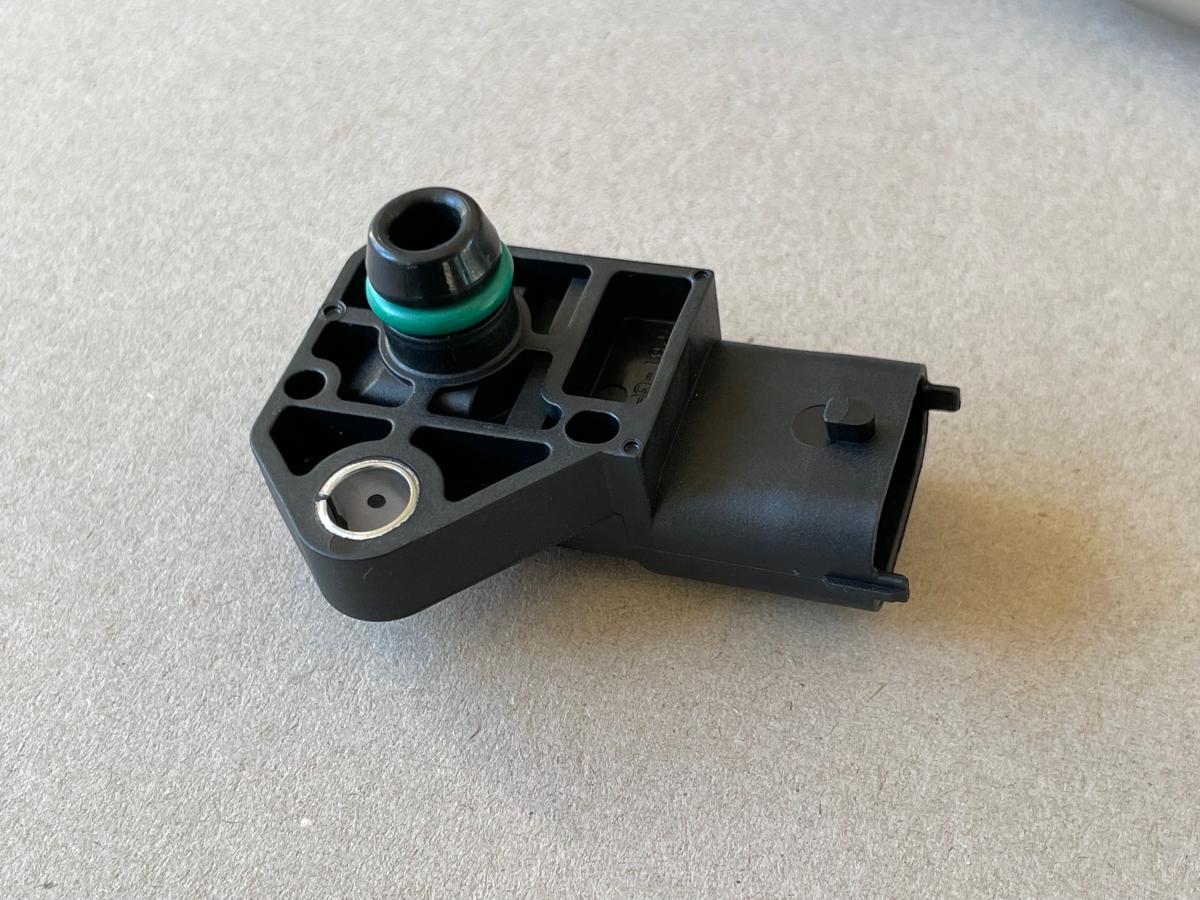

                        And here's some close-ups of the sensor:
                        Click image for larger version  Name:	IMG_9407.jpg Views:	0 Size:	167.9 KB ID:	271571
                        Click image for larger version  Name:	IMG_9409.jpg Views:	0 Size:	155.3 KB ID:	271572
                        And this is the stand-off that we need to account for:
                        Click image for larger version  Name:	IMG_9415.jpg Views:	0 Size:	82.4 KB ID:	271573
                        It measures in slightly more than 1.5mm but I'm going to make the standoff 2.5mm thick to allow a little wiggle room.
                        I knocked this up and have sent it off to Dad to have a first prototype printed for fitment checks:
                        Click image for larger version  Name:	Screenshot 2024-07-12 at 5.25.49 PM.png Views:	0 Size:	20.4 KB ID:	271577
                        I'll report back on this when I have the prototype in hand. I expect there will be fine-tuning adjustments to make.

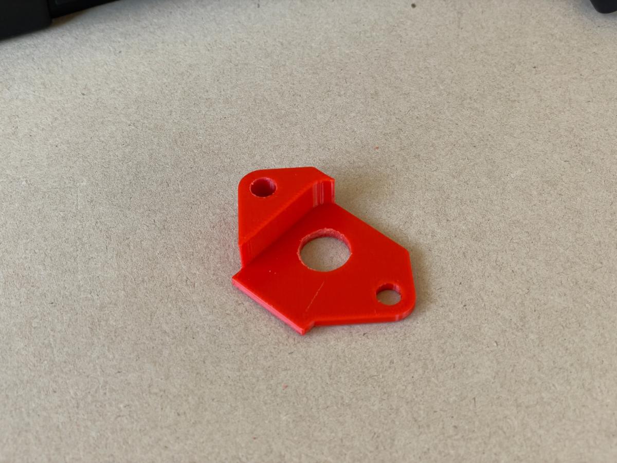

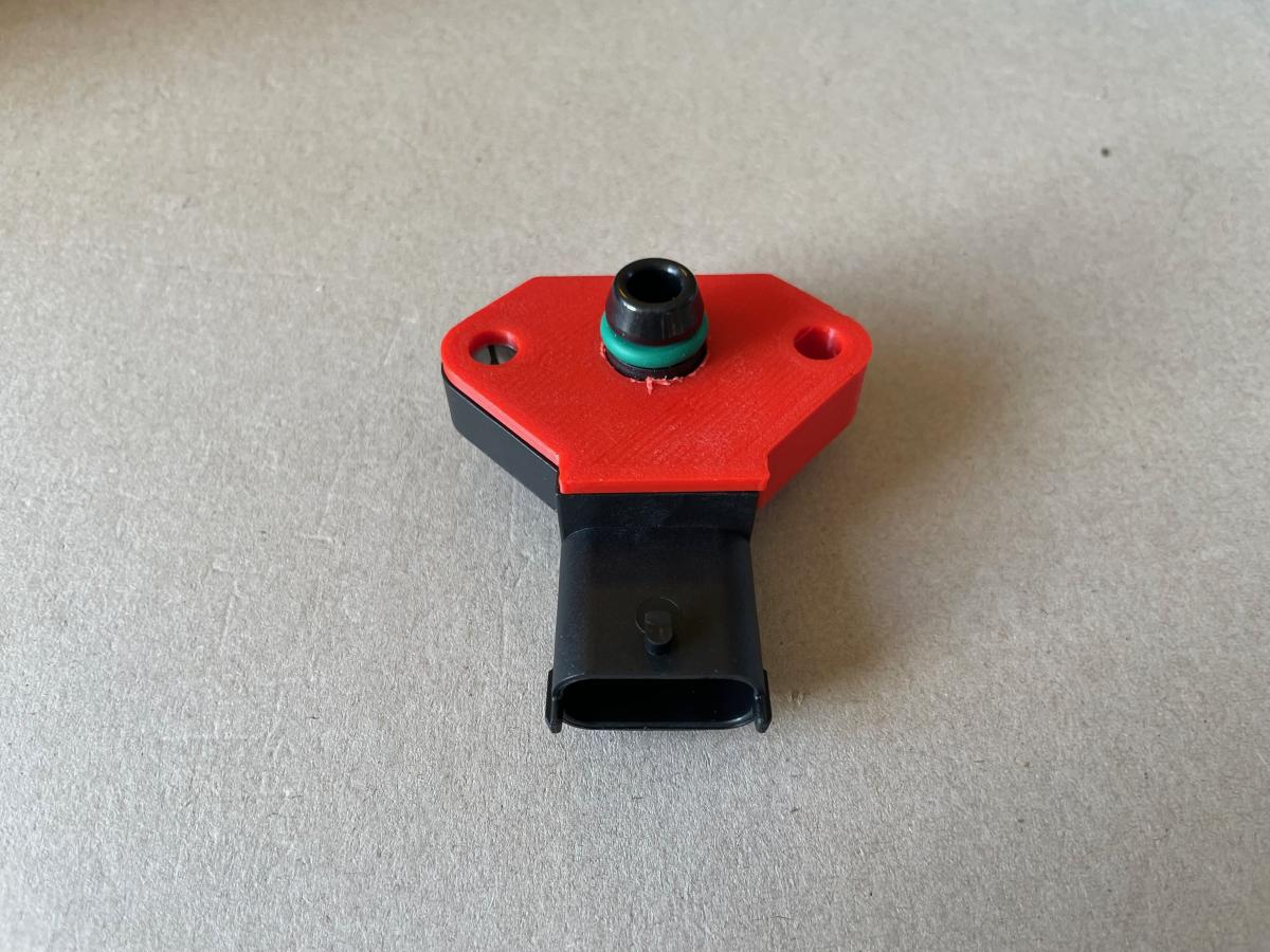

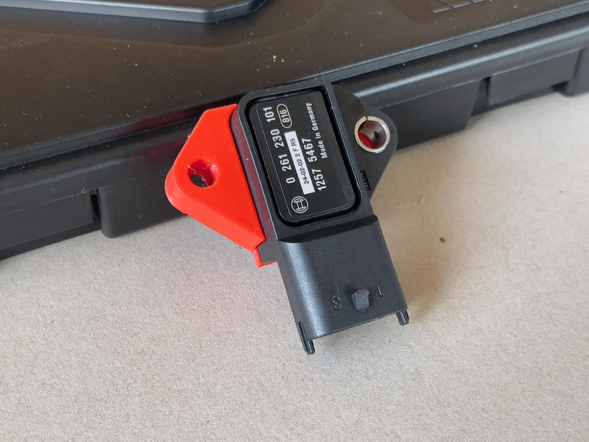

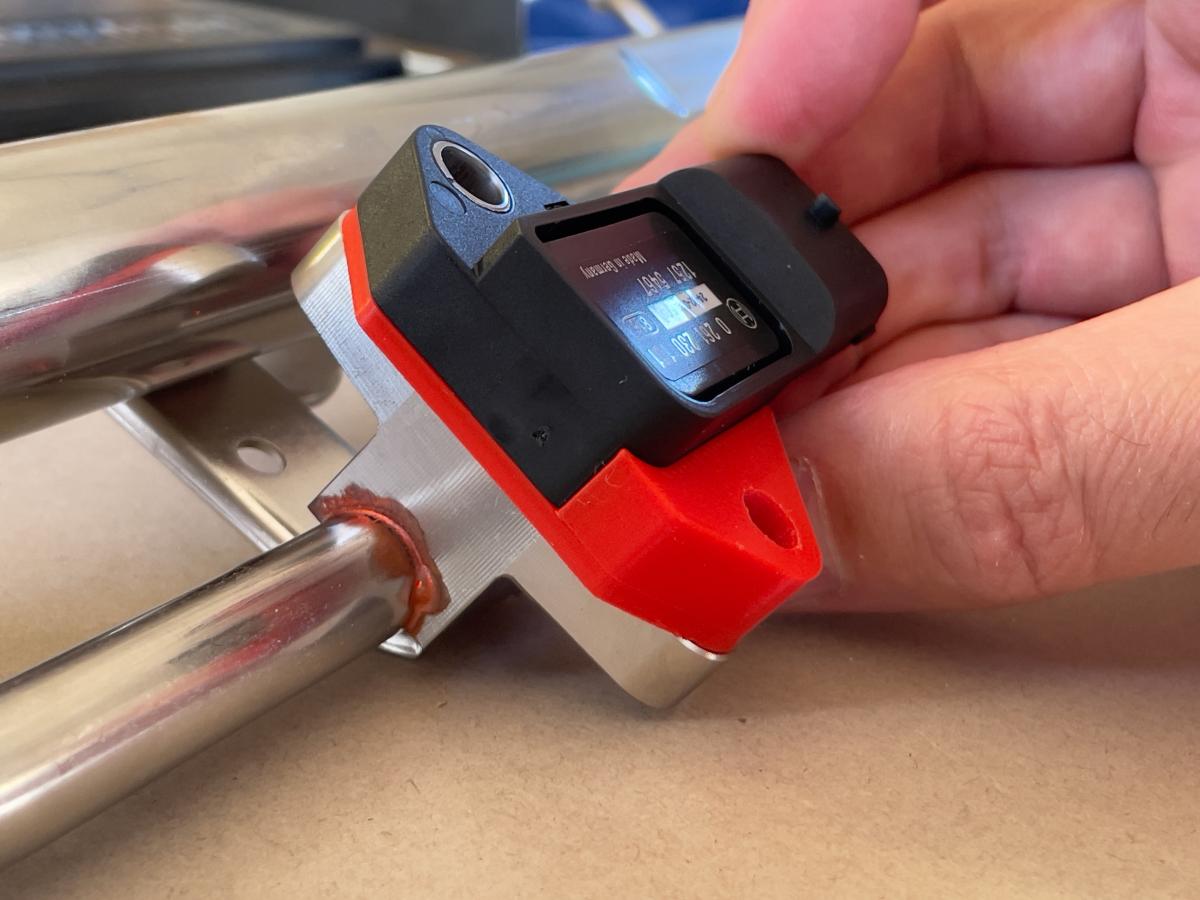

                              Dad dropped off the the prototype this afternoon:
                              Click image for larger version  Name:	IMG_9430.jpg Views:	0 Size:	143.6 KB ID:	271822
                              And here it is fit to the sensor - I'm very happy with how well this fits for a first prototype.
                              Click image for larger version  Name:	IMG_9425.jpg Views:	0 Size:	142.9 KB ID:	271823
                              Click image for larger version  Name:	IMG_9426.jpg Views:	0 Size:	134.4 KB ID:	271824
                              Very happy with how well it fits together and seems I even got the radiuses of the beveled edges right!
                              It fits up nicely to the rail:
                              Click image for larger version  Name:	IMG_9429.jpg Views:	0 Size:	93.6 KB ID:	271825
                              Planned changes for the next iteration:
                              - Enlarge mounting holes a bit to allow some wiggle room for the mounting bolts
                              - Enlarge hole for sensor nose as I had to file it out slightly in this proto.
                              - Reduce the thickness of the spacer plate. The piece is very solid and I think it will be better to reduce it back to approx 1.5mm so that the o-ring on the nose will sit a little bit lower in the air rail.
                              Dad will also print the next prototype with CF reinforced PETG which should be a suitable end material with sufficient heat resistance for this application. Printing in the target material will allow us to check for any dimensional variance with a different material (proto 1 is just PLA).
                              I think this should turn out well!

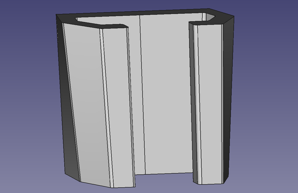

                                With the SMG expansion tank in hand I was able to measure up and design a copy of the bracket that the tank clips into. I measured up the tank:
                                Click image for larger version  Name:	IMG_9488.jpg Views:	0 Size:	82.2 KB ID:	271845
                                And was able to draw up the two profiles at the top and bottom of the clip, which results in a bracket looking like this:
                                Click image for larger version  Name:	Screenshot 2024-07-13 at 9.01.44 PM.png Views:	0 Size:	30.7 KB ID:	271846
                                Again I've sent it off to Dad to have the first prototype printed.
