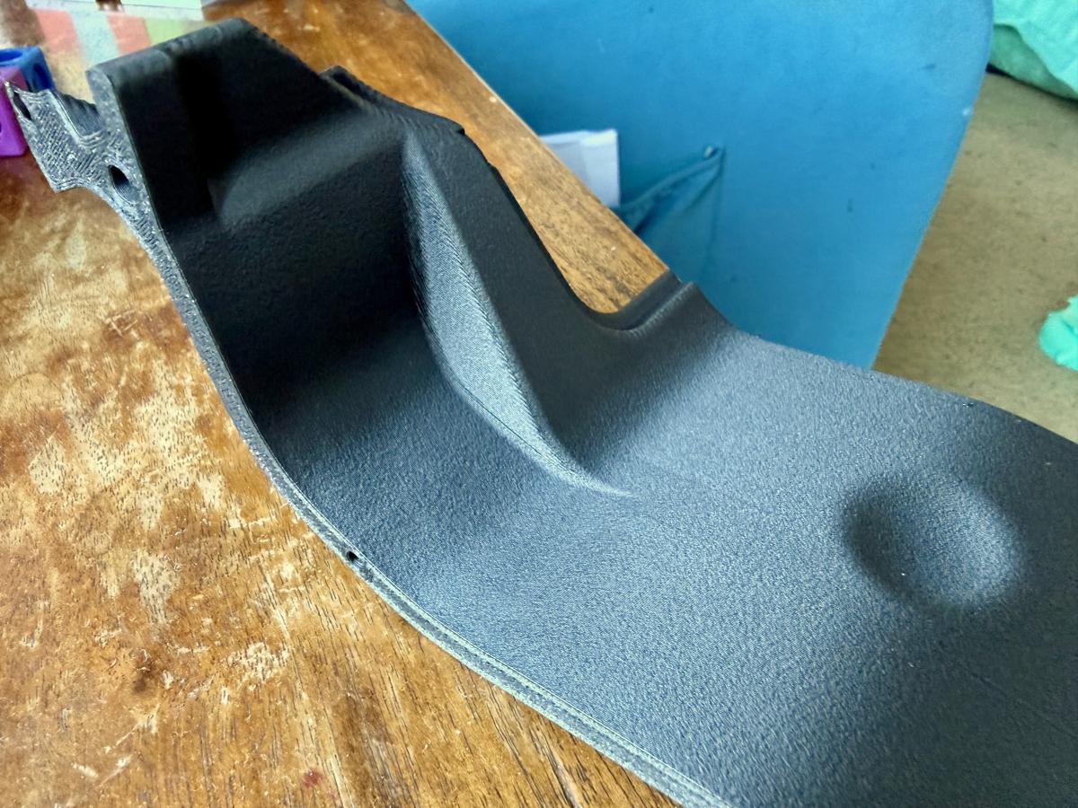

                      Set up a riser and holder for the printer and AMSs. AMS HT arrived so set that up and dried some PET-CF. I'm still waiting on 0.6mm nozzles but decided to do a test print of the PET-CF with ASA support to see what it was like.
                      It went predictably and the PET-CF nozzle eventually clogged, but the outcome prior to that is incredible, very happy with how this will turn out.
                      Photo below of steep overhang that was supported with ASA at the support interface - can't distinguish it from the upper side!
                      Click image for larger version  Name:	IMG_5441.jpg Views:	0 Size:	192.8 KB ID:	571693
                        Hmmmm that part looks vaguely familiar
                          Haha yes indeed. I'm so excited to get them printed. I've said it before but you really have done an amazing job with these pieces - looking forward to holding them in my hands!
                            I'm looking forward to seeing you assemble them! And especially excited to see how much trouble the gaskets give you.
                            X2D should do a much better job with those since you can use the aux nozzle for supports.
