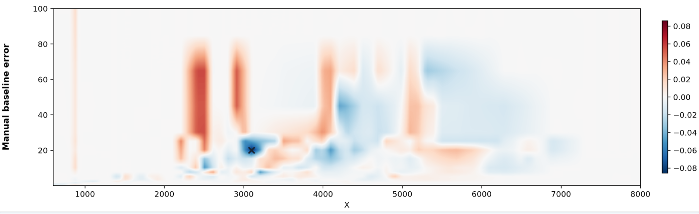

    This is the resultant VE table error of just mapping the correction to the standard interpolation points:
    Click image for larger version  Name:	Screenshot 2026-09-14 at 8.26.08 PM.png Views:	0 Size:	164.5 KB ID:	366928

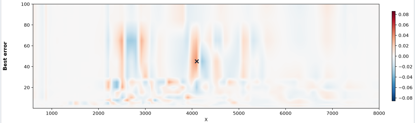

    And this is exactly the same data, but with interpolation points optimised - I have also specified certain areas of the surface as having a greater weighting (e.g. low dr_rel/rpm combos the relative error matters more).
    Click image for larger version  Name:	Screenshot 2026-09-14 at 8.26.14 PM.png Views:	0 Size:	163.9 KB ID:	366929
      That is too cool. And on a Mac no less! Guess I’m glad I sprung for the beefcake M4 in my latest machine.

        Doing the VE tuning reminded me to have a play with something I've been meaning to do for a while. With high rate CAN logging there's enough resolution in the logs to go more granular with the VE tuning process. I'm just playing around at this point, but have tried things like building a correction map at a higher resolution, and then essentially brute-force solving (my M1 Max seems to be able to do about 150,000 fits per minute) an optimal 20x24 table.
        In this quick example below, the best-found table has an RMS error of 0.0046 vs 0.0109 on the starting corrected table (e.g. standard interpolation points) - a 57.95% improvement, and a reduction in the max error point of about 20% - not bad.
