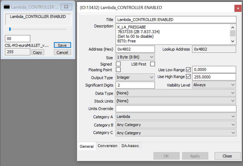

    Ok here we go, set to 00 to disable:
    Click image for larger version  Name:	lambda controller disable.png Views:	0 Size:	154.4 KB ID:	308160
      Thanks heaps for this - Correct me if I'm wrong but doesn't this straight up disable the lambda controller?
                Yes, that scalar will shut down the lambda controller completely however Lambda regulator shutdown is rpm/rf based. You'll have a blast disassembling the lambda module! I don't miss it one bit, LOL…

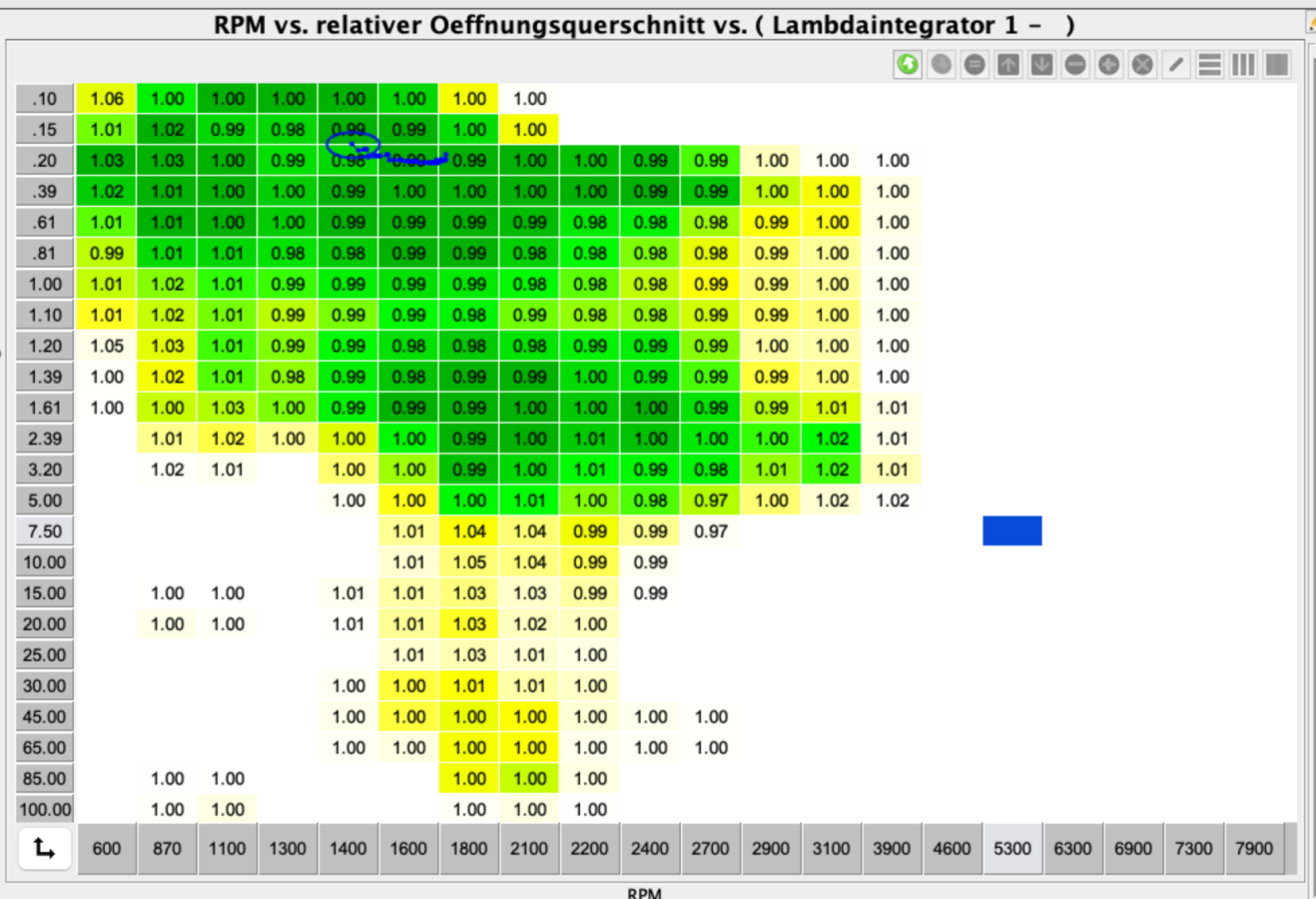

                        I did a test drive just now.
                        I took my most recent VE log (note this was first one with MAP sensor disabled which I think is why it shows slightly lean across the board - I think the MAP sensor was compensating for/hiding this) and ran it through the spreadsheet, then imported to MLV, then into your spreadsheet Heinz, to generate the new VE table. The result was as I was expecting, that the mismatched AQ_REL values were previously making low RPM appear richer than they actually were (e.g. more fuel was needed).
                        Click image for larger version Name:	Screenshot 2025-06-11 at 8.48.29 PM.png Views:	0 Size:	513.7 KB ID:	308052
                        I then went for a (reasonably quick) run (about 6000 log lines) focusing on the low RPM and could tell the improvement pretty much immediately, no-throttle, low-rpm downshifts were particularly noticeable, rev matching was even better than previously, the car had even more pep than previously (remember I'm currently doing these runs with the MAP sensor turned off as well, so when I'm making these comparisons it's on pure AlphaN without the MAP sensor correcting anything).
                        And I think the MLV view speaks for itself - Lambda around the high change areas is significantly better, and a lot of values that were quite wrong are now spot on. There's those couple areas between 870 and 1100 RPM to clean up (that previously weren't clearly identifiable and kept moving around - which makes sense given AQ_REL was being misinterpreted) but all in all this is quite a lot of improvement for a single run, and it's very noticeable when driving.
                        Click image for larger version Name:	Screenshot 2025-06-11 at 9.06.09 PM.png Views:	0 Size:	462.1 KB ID:	308053
                        I'll do another run tomorrow off the back of this to prove further that this converges on a neat end result, but I'm pretty confident from this first run that this is the missing trick to really nailing down the low RPM.
                        Important to note as well that I am running pure AlphaN with the MAP sensor disabled. I think this is really key when logging as well to not end up masking inaccuracies in the VE table.

                                Ran through the karter16 updated VE tuning method on my car today. Car is running Bry5on's latest mullet (v28) and I disabled MAP and adaptations during the data logging sessions.
                                Here's the final change compared to the baseline after three iterations:
Name:	Mullet v28 Heinz VE Tuning Comparison.png
                                There was a little bit of weirdness left down low (<1500 rpm and <~1.5 relative opening) before the tuning. It was mostly noticeable when pulling away from a stop and when feathering the throttle right before fully disengaging the clutch on upshifts. Was extra noticeable with the stock comfort throttle mapping.
                                But all that is practically undetectable post-tuning! I'm super happy with the results. Drivability is very, very, very close to stock now.
