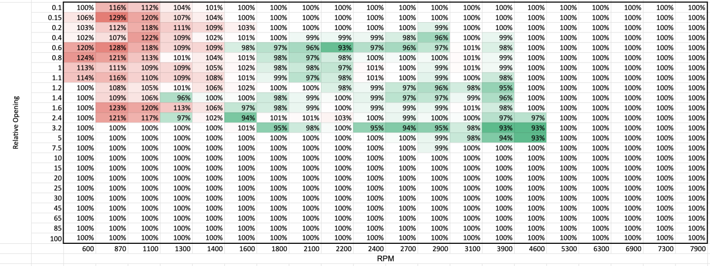

    Ran through the karter16 updated VE tuning method on my car today. Car is running Bry5on's latest mullet (v28) and I disabled MAP and adaptations during the data logging sessions.
    Here's the final change compared to the baseline after three iterations:
Name:	Mullet v28 Heinz VE Tuning Comparison.png
    There was a little bit of weirdness left down low (<1500 rpm and <~1.5 relative opening) before the tuning. It was mostly noticeable when pulling away from a stop and when feathering the throttle right before fully disengaging the clutch on upshifts. Was extra noticeable with the stock comfort throttle mapping.
    But all that is practically undetectable post-tuning! I'm super happy with the results. Drivability is very, very, very close to stock now.

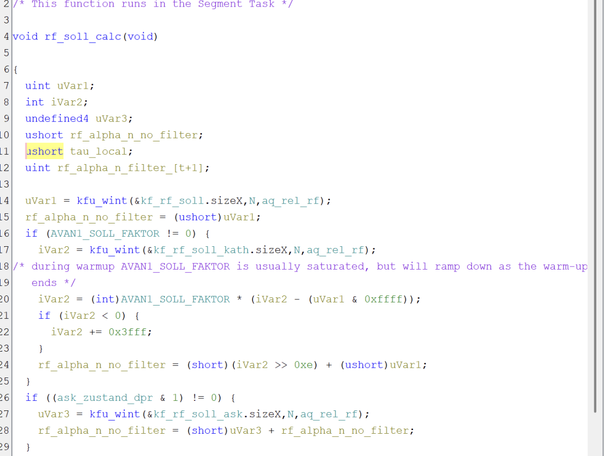

        As I was chasing the last few parameters I came across this again and looked at it in a slightly new light. the Alpha N Kath table is blended in based on AVAN1_SOLL_FAKTOR. But why use AVAN1_SOLL_FAKTOR and not KATH_FAKTOR directly. Last time I looked at this I wasn't in the detail enough to question it, but it seems to be an interesting choice.
Name:	Screenshot 2025-08-03 at 9.34.14 AM.png

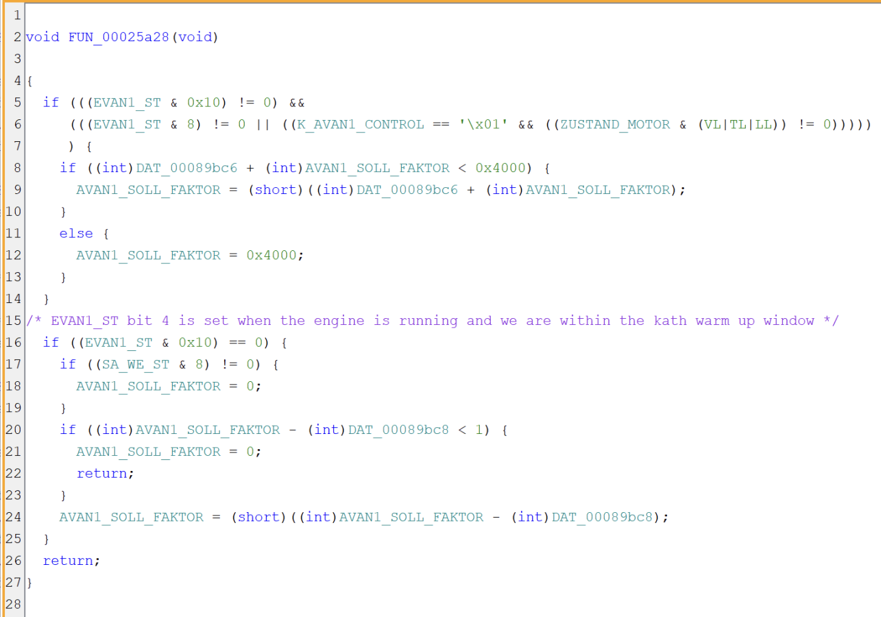

        AVAN1_SOLL_FAKTOR is calculated on the slave here:
Name:	Screenshot 2025-08-03 at 9.36.16 AM.png

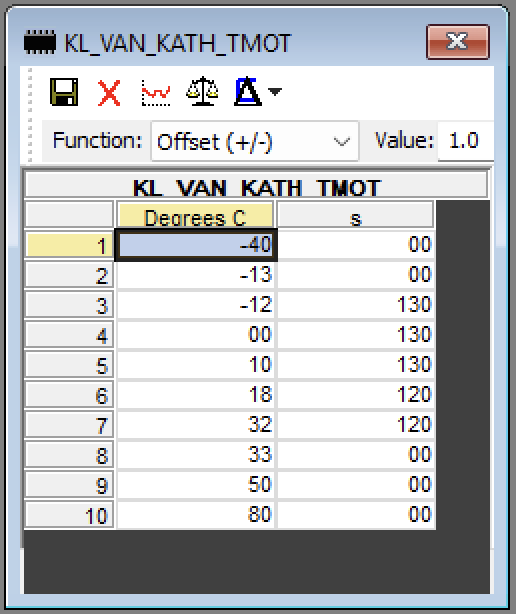

        The key thing to note is if EVAN1_ST bit 4 is set then AVAN1_SOLL_FAKTOR ramps to 1 over a few seconds) if bit 4 is cleared then AVAN1_SOLL_FAKTOR ramps to 0. So it's either on or off with a bit of smoothing over the few seconds of the transition.
        How is EVAN1_ST set?

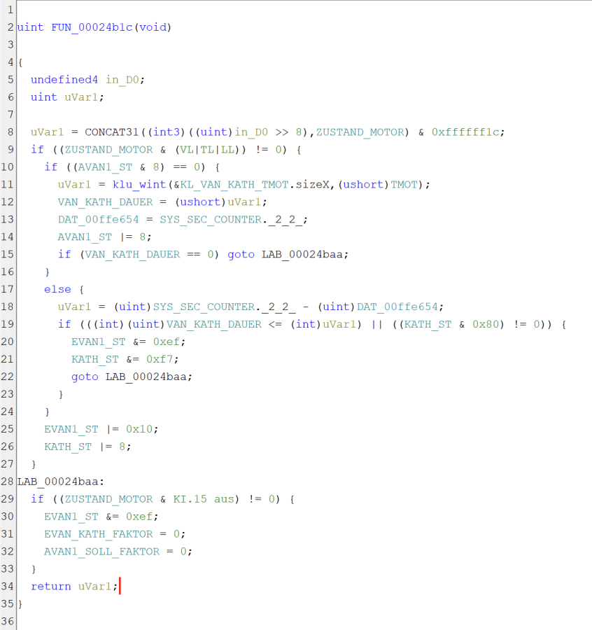

        bit 4 is set here:
Name:	Screenshot 2025-08-03 at 9.38.31 AM.png
        What this is doing is using the curve KL_VAN_KATH_TMOT to determine how long EVAN1_ST should be cleared for before it is set.
Name:	Screenshot 2025-08-03 at 9.41.07 AM.png
        First time the function runs and engine is in running state (LL/TL/VL) it checks current TMOT and looks up how many seconds the warm up period should last for. (e.g. if TMOT is 18 degrees C then the warm up will last for 120 seconds).
        EVAN_1_ST bit 4 stays cleared for 120 seconds and is then set.
        So the warm up period that the AlphaN Kath table is used is a set number of seconds based on TMOT at the time the engine starts, not a temperature target that is achieved by the end of warm up.
        So back to my original question, why are we using AVAN1_SOLL_FAKTOR rather than KATH_FAKTOR. Thinking about it a bit more it actually makes a fair bit of sense. Use of the AlphaN Kath table is tied to the use of the VANOS Kath tables because the different camshaft tables affect the volumetric efficiency and therefore the AlphaN table needs to be tuned to the VANOS Kath profiles. Likewise they both use AVAN1_SOLL_FAKTOR as they need to switch together as well.
        Anyway, why am I writing this in here? Because we should stop presuming that the AlphaN Kath table is used until TMOT >= 80 degrees and come up with a different strategy (We could probably log AVAN1_SOLL_FAKTOR over DS2, or we could log TMOT on engine start and work out how many seconds into the log file to take data from from there).
        Not sure in practice how much this will really affect anything but might as well make sure we have the most correct knowledge :-)

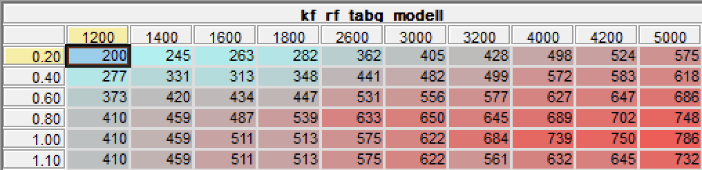

              KF_RF_KORR_DRREL
              Click image for larger version  Name:	Screenshot 2025-09-06 at 10.11.16 AM.png Views:	12 Size:	26.9 KB ID:	317770
              This table has x axis: N (rpm) and y axis: rf_tabg_modell - TABG. The output is a multiplier factor which is applied to RF.
              rf_tabg_modell
              So what is rf_tabg_modell then. It's nominal TABG (exhaust gas temp) as obtained from this table:
              Click image for larger version  Name:	Screenshot 2025-09-06 at 10.18.05 AM.png Views:	12 Size:	31.7 KB ID:	317771
              Essentially this is a table of expected TABG for a given RPM/RF. This is what BMW would have measured during testing.

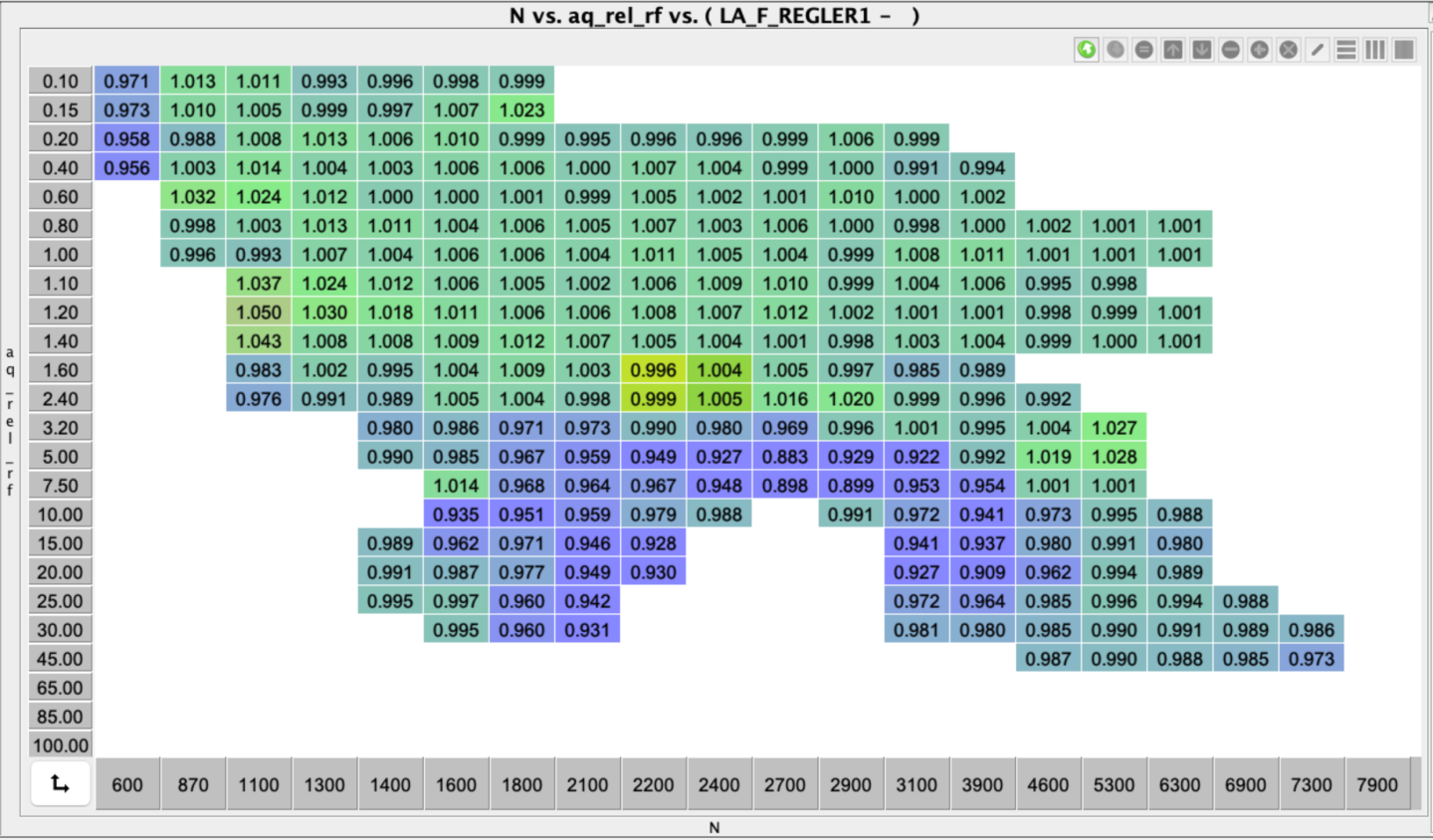

              What all this means in practice is that if you simply log lambda and aq_rel_rf you're going to end up with that area appearing rich (because the number you're looking at to chase stoich has been intentionally adjusted rich) and incorrectly leaning it out.
              To prove this point here is the familiar histogram (note I'm using aq_rel_rf which is the previously noted correct input variable to be using for VE tuning).
              Click image for larger version  Name:	Screenshot 2025-09-06 at 11.02.45 AM.png Views:	12 Size:	553.5 KB ID:	317772
              There's a big rich patch in the middle there at higher aq_rel_rf that needs to be corrected right?
              Let's have a look once we've corrected lambda for rf_korr:
              Click image for larger version  Name:	Screenshot 2025-09-06 at 11.03.01 AM.png Views:	13 Size:	542.3 KB ID:	317773
              As we can see we're actually still lean in some cells! These screenshots were from an early tuning run experimenting with this, which is why the corrected table hasn't converged on 1 everywhere.

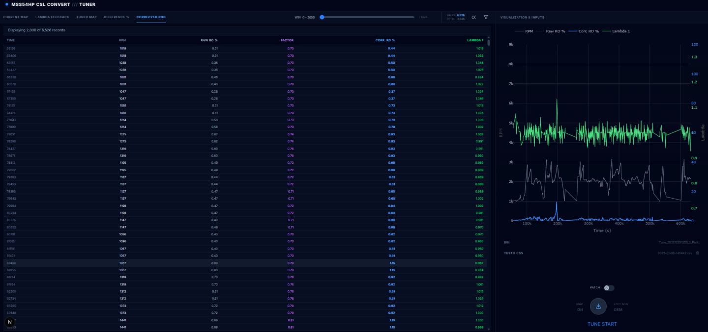

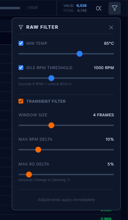

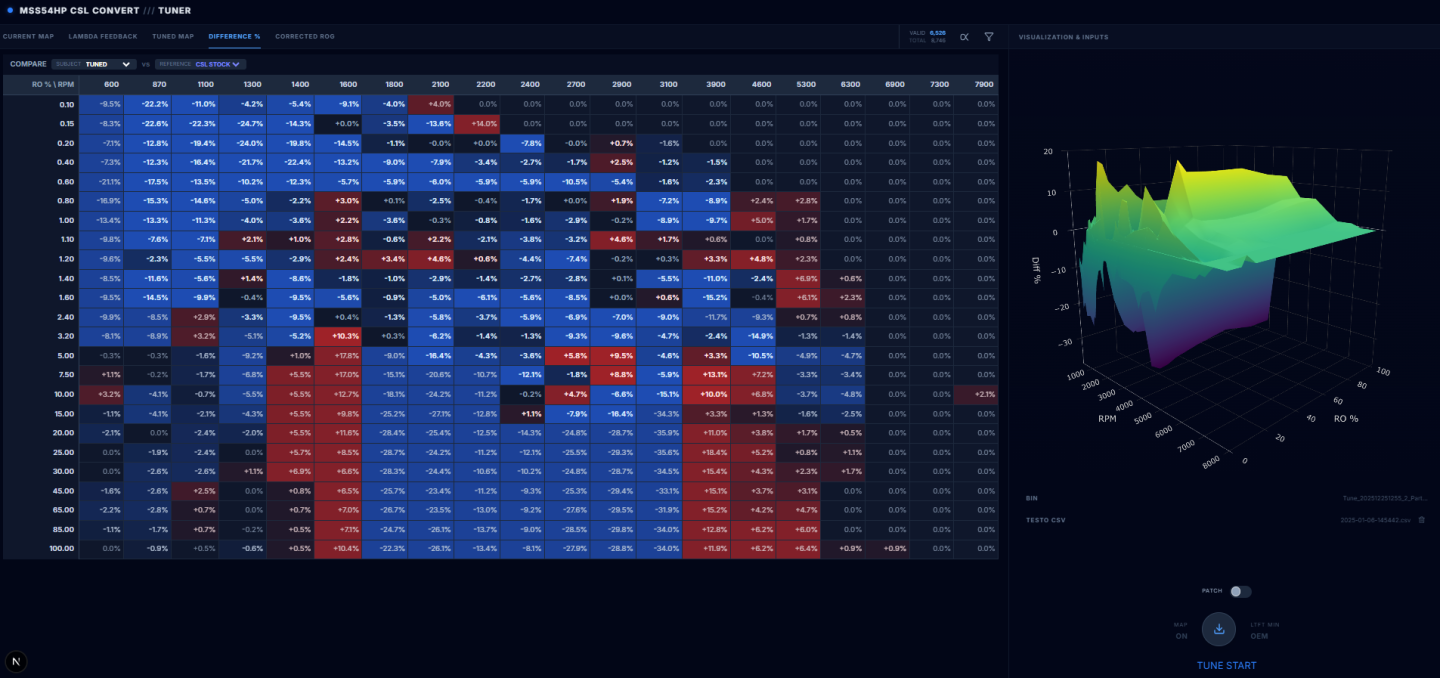

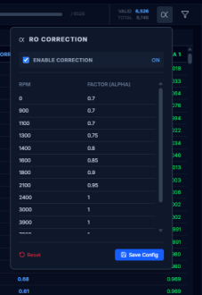

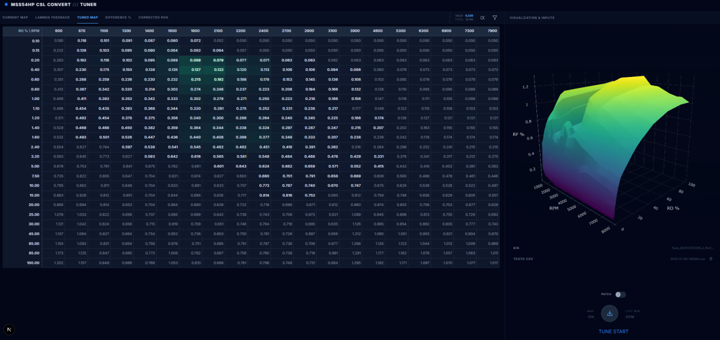

                          Finishing up csl intake project now. Been here reading for weeks. You guys are amazing. This and several other threads so helpful in trying understand what’s going on and what needs done to make the swap proper. Thanks for the hard work and making it available to all.

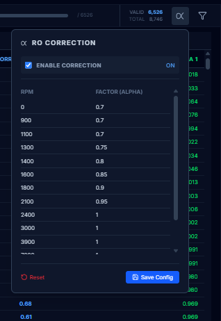

                            First of all, I would like to express my gratitude to everyone who contributes daily to the research and publication of the CSL CONVERT tuning methodology.
                            I have been looking for a way to give back to this community, and I have developed an application that integrates the various tuning processes currently shared in this thread into a single workflow.
                            Integrated Processes:
                            • Disabling MAP & LTFT compensation (TunerPro)
                            • RO (Relative Opening) Correction (AQ_REL to AQ_REL_ALPHA_N Logfile Converter | Spreadsheet)
                            • Lambda Value Aggregation (MegaLogViewer)
                            • Tuning VE Calculation (VE Tuning With Lambda Integrators | Spreadsheet)
                            • VE Comparison vs. Stock CSL (VE Tuning With Lambda Integrators | Spreadsheet)
                            • VE Table Editing (TunerPro)
                            • Re-enabling MAP & LTFT compensation (TunerPro)
                            In short, I have taken the previously labor-intensive process and streamlined it: now, you can simply upload your Partial BIN and TESTO LOG CSV, click the download button, and the process is complete. (The tool is completely free.)
                            The app is hosted on GitHub Pages, so it can be used immediately without installation: https://mss54hp-csl-convert-tuner.tsunagi.app/
                            The source code is also public, so please feel free to review or modify it: https://github.com/mushitaro/mss54hp-csl-convert-tuner/
                            Important Note on Development: This application was developed entirely using Gemini (LLM); there has been no manual code review by a human. As a result, there may be unexpected bugs or redundant "spaghetti" code in some places. I have left some of the redundant code as-is because I’ve had bitter experiences where asking an AI agent to "clean up" resulted in it deleting critical logic that was difficult to recover.
                            Technical Specifications & Limitations:
                            • Supported BIN: Currently only tested with 0401 partial BIN.
                            • CSV Formats: Supports semicolon-delimited (Testo output) and comma-separated (Spreadsheet output).
                            • Headers: Header names must match Testo exactly.
                            • Accuracy: I have compared the values generated by this app against manual tool calculations at the cell level and confirmed they match perfectly.
                            • Checksums: A checksum correction feature is not yet included, but it can be implemented quickly if the addresses and reference ranges are identified.
                            Ideally, I would like to integrate Testo and flashing tools directly, but I am still researching that logic. If anyone can provide information on this, I would love to try and integrate it.
                            Compatibility: Tested on Chrome and Edge. I cannot guarantee operation on Safari or Firefox (though Gemini claims to have performed automated testing...).

                              Beggars can’t be choosers, but it would be great to get a tool to allow similar auto tuning but using a wide band 02.
                                That’s pretty complicated with the MSS54HP as the CSL binary is not always targeting the same stoich target, particularly at mid-rpm and transitions to WOT. Not saying it’s impossible of course but it’s not trivial either!
