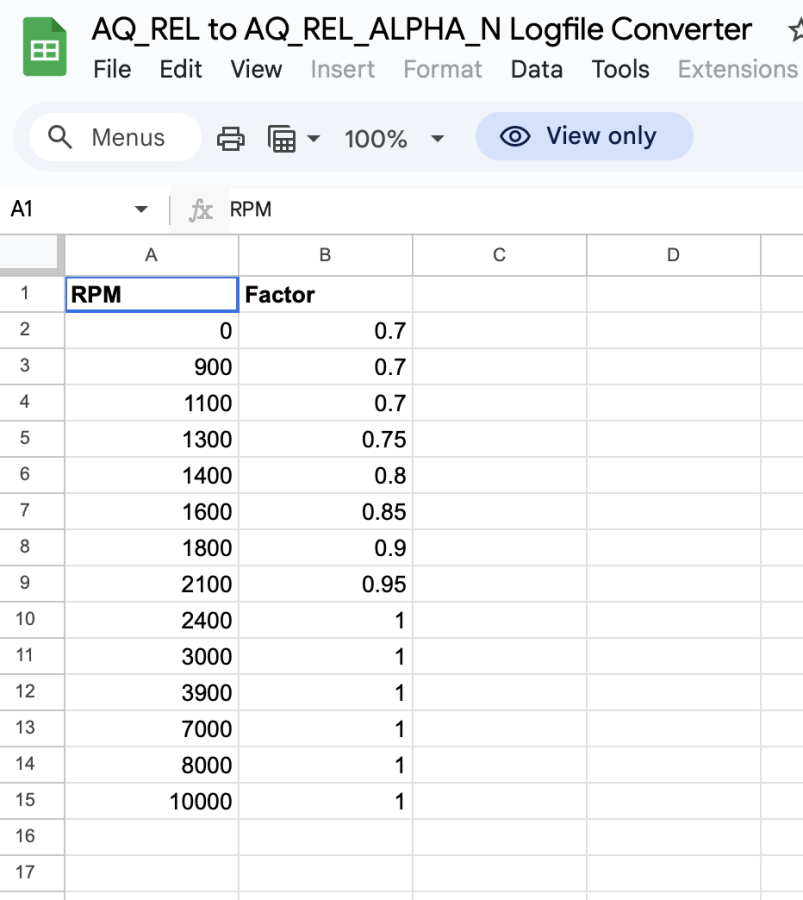

    Because the adjustment factor varies between 0.7 and 1.0 between 900 and 2400 rpm the raw Relative Opening data points need to be adjusted before the log is summarized by MLV.
    At this point I'm envisaging an extra sheet in Heinz's spreadsheet where you import your log, it applies the linear interpolation for RO for each line, then you export the log file and open in MLV.

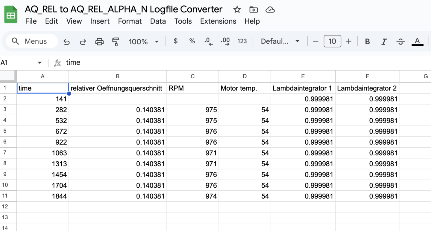

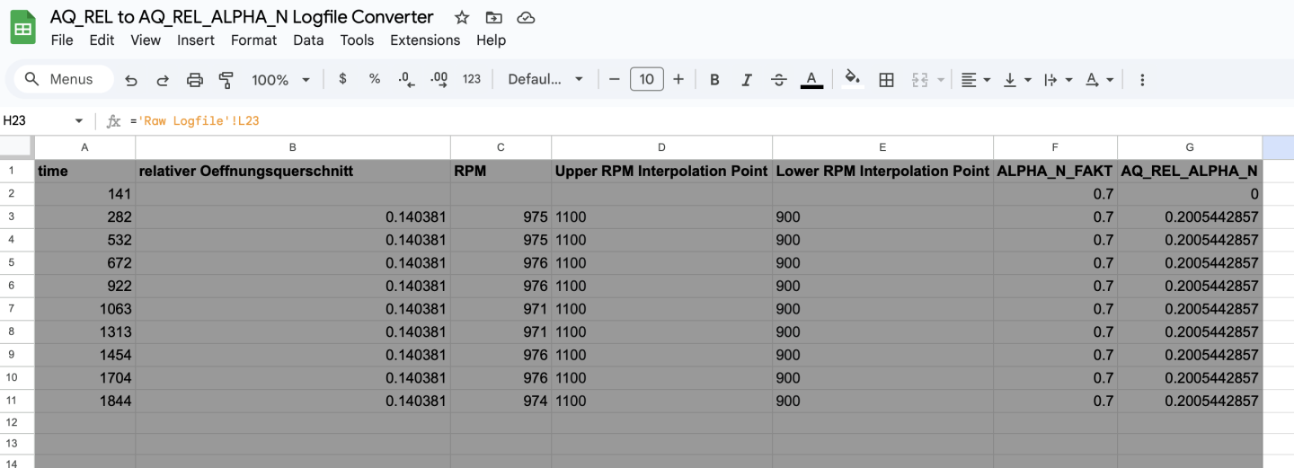

        Okay - I spun up some google sheets to handle the conversion of AQ_REL to AQ_REL_ALPHA_N in TestO logfiles in a somewhat general manner.
        - Read the instructions sheet first.
        - It can take input log files with up to 26 variables and up to 100,000 rows. It doesn't matter what order the variables are in, so long as Relative Opening (relativer Oeffnungsquerschnitt) and RPM are present.
        - The Calculations tab shows all the working to show exactly what it does.

        Import Raw logfile:
        Click image for larger version  Name:	Screenshot 2025-06-11 at 7.43.53 PM.png Views:	0 Size:	264.1 KB ID:	308020

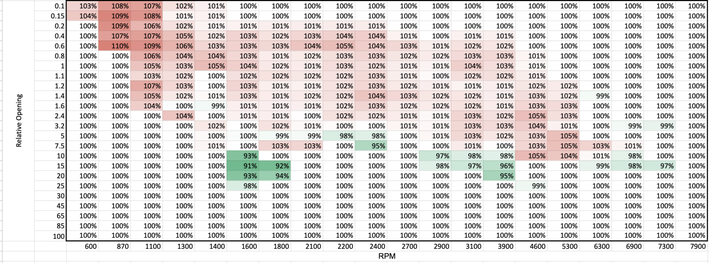

        Copy of the ALPHA_N_FAKT table:
        Click image for larger version  Name:	Screenshot 2025-06-11 at 6.27.44 PM.png Views:	0 Size:	121.8 KB ID:	308012 Click image for larger version  Name:	Screenshot 2025-06-11 at 6.28.52 PM.png Views:	0 Size:	22.3 KB ID:	308013

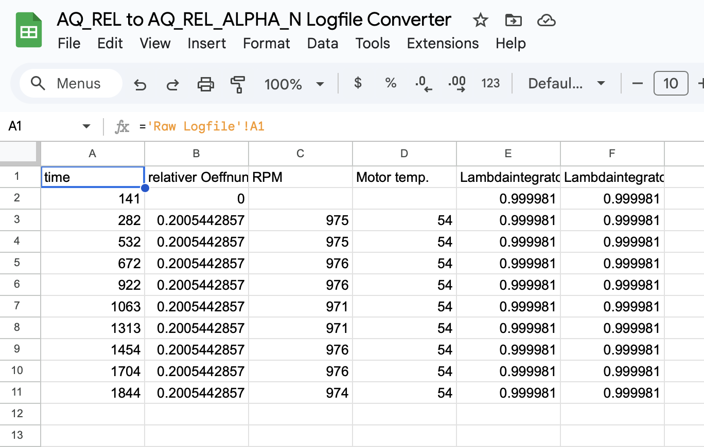

        And the output:
        Click image for larger version  Name:	Screenshot 2025-06-11 at 7.43.49 PM.png Views:	0 Size:	139.6 KB ID:	308021

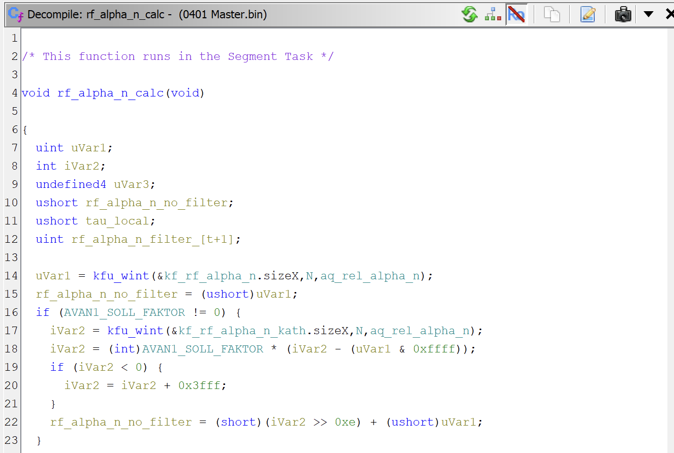

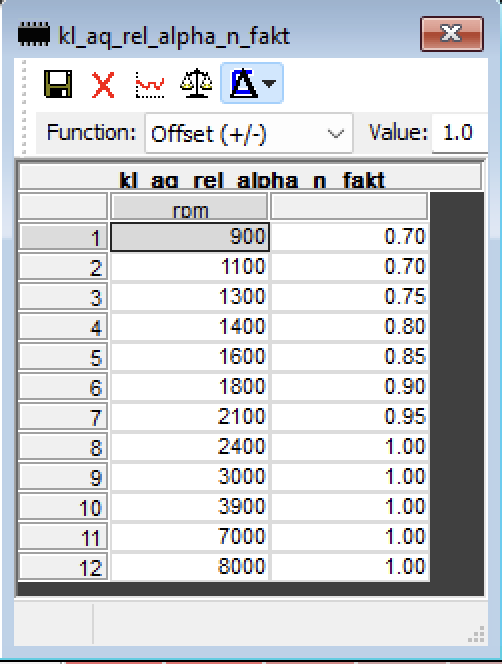

          I just have one dumb question that came to mind. The y axis on the VE table for CSL FW is AQ_REL_ALPHA_N and not AQ_REL, right?
            Hell yeah, thank you!
            Yessir

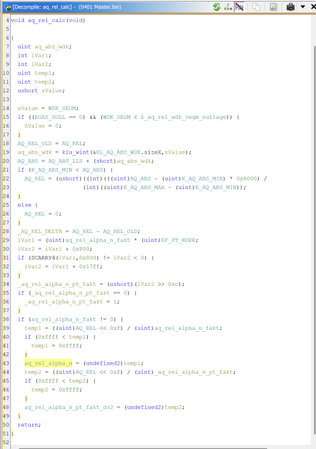

            Line 14 (and line 17 for the warm-up table).
Name:	Screenshot 2025-06-11 at 7.19.17 PM.png
            And here's the evidence (lines 38 to 43) that aq_rel_alpha_n is aq_rel modified by aq_rel_alpha_n_fakt (which in turn is lookup based on RPM from kf_aq_rel_alpha_n_fakt table)
Name:	Screenshot 2025-06-11 at 7.21.37 PM.png
              Please note that I fixed a bug (typo in formula) just now. heinzboehmer if you took a copy of the sheet already then you'll want to grab the latest version.

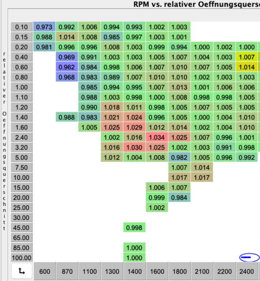

                  I did a test drive just now.
                  I took my most recent VE log (note this was first one with MAP sensor disabled which I think is why it shows slightly lean across the board - I think the MAP sensor was compensating for/hiding this) and ran it through the spreadsheet, then imported to MLV, then into your spreadsheet Heinz, to generate the new VE table. The result was as I was expecting, that the mismatched AQ_REL values were previously making low RPM appear richer than they actually were (e.g. more fuel was needed).
                  Click image for larger version  Name:	Screenshot 2025-06-11 at 8.48.29 PM.png Views:	0 Size:	513.7 KB ID:	308052
                  I then went for a (reasonably quick) run (about 6000 log lines) focusing on the low RPM and could tell the improvement pretty much immediately, no-throttle, low-rpm downshifts were particularly noticeable, rev matching was even better than previously, the car had even more pep than previously (remember I'm currently doing these runs with the MAP sensor turned off as well, so when I'm making these comparisons it's on pure AlphaN without the MAP sensor correcting anything).
                  And I think the MLV view speaks for itself - Lambda around the high change areas is significantly better, and a lot of values that were quite wrong are now spot on. There's those couple areas between 870 and 1100 RPM to clean up (that previously weren't clearly identifiable and kept moving around - which makes sense given AQ_REL was being misinterpreted) but all in all this is quite a lot of improvement for a single run, and it's very noticeable when driving.
                  Click image for larger version  Name:	Screenshot 2025-06-11 at 9.06.09 PM.png Views:	0 Size:	462.1 KB ID:	308053
                  I'll do another run tomorrow off the back of this to prove further that this converges on a neat end result, but I'm pretty confident from this first run that this is the missing trick to really nailing down the low RPM.
                  Important to note as well that I am running pure AlphaN with the MAP sensor disabled. I think this is really key when logging as well to not end up masking inaccuracies in the VE table.

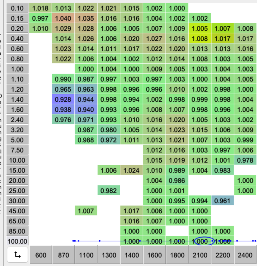

                      I went for another run this morning (about 5 degrees cooler than last night).
                      I didn't need to look at the log file to know that this is the right approach. Honestly was like driving the car with the MAP sensor enabled.
                      As you can see from the log there's still some tuning to go, mostly around the very low rpm range which is really hard to consistently hit while driving (especially with SMG). But essentially all the cells are pretty rapidly converging at 1.0 (those that still have some work to do are where they didn't have good coverage in the previous logging run).
Name:	Screenshot 2025-06-12 at 8.33.01 AM.png
                      I'm stoked. I'm very confident now that this is the trick to nailing down the low RPM, and just need some others to further validate what I'm seeing.

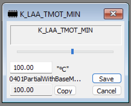

                            1: Disable and clear Long Term Fuel Trims
                            In TunerPro (with the XDF above loaded along with your current 0401 partial (tune) binary) Open the K_LAA_TMOT_MIN parameter and set it to 100 degrees C. As noted in heinzboehmer's earlier post this has the effect of raising the point at which the LTFTs are updated above the operating temperature of the motor (e.g. the LTFTs will never change).
                            Click image for larger version  Name:	Screenshot 2025-06-12 at 11.28.06 AM.png Views:	0 Size:	11.4 KB ID:	308140
                            2: Clear current engine adaptions in INPA.
                            Again as heinzboehmer notes this is necessary because the above step only stops LTFT's from being updated, not used. So you need to reset them to 1.00 so that they have no effect.

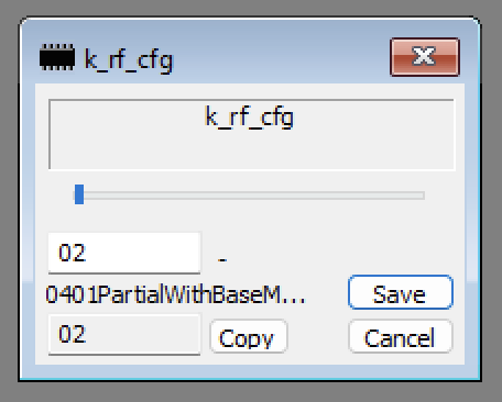

                            3: Disable the MAP Sensor Integrator
                            The MAP Sensor is a good thing under normal conditions in that it, in real time, accounts for variation between the AlphaN VE table and actual real-world conditions. This is why running the MAP Sensor results in a smoother drive. However this correct is counter-productive when performing the VE tuning process. To disable the MAP sensor input to calculation of Relative Fill and rely solely on the AlphaN VE table set k_rf_cfg to 0x02 (if you would like more reassurance that this does what I say it does see here: https://github.com/karter16/CSL_0401...put-parameters)
                            Click image for larger version  Name:	Screenshot 2025-06-12 at 11.34.16 AM.png Views:	0 Size:	10.0 KB ID:	308141
