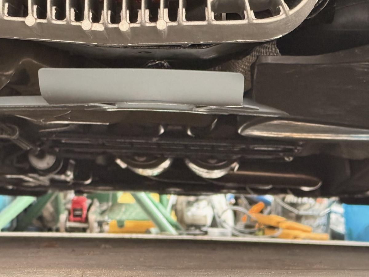

                    Sill waiting for the ground to dry out a little bit before I progress the retaining wall so spent a couple of hours this afternoon taking the rear sway bar brackets and v brace off and cleaning them up. When Dad and I did the underbody refresh in 2017 we used an enamel black paint for most of the pieces, and 8 years on they still look amazing - wipe the road dust off and they look brand new still. There were a couple of pieces (the sway bar brackets and v brace) which we painted with exactly the same stuff, only silver instead of black. Unfortunately the silver kind of sucks in comparison to the black - presumably whatever they put in it to make it silver makes it more susceptible to surface rusting.
                    So anyway - I took them off, stripped the enamel with acetone and then cleaned up the surfaces with some fine sandpaper before cleaning again with acetone and then undercoating.
                    The pictures are a bit average because it's pretty late in the day here, but I'm sure you've all seen undercoated things before:

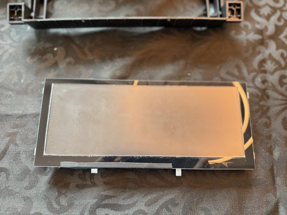

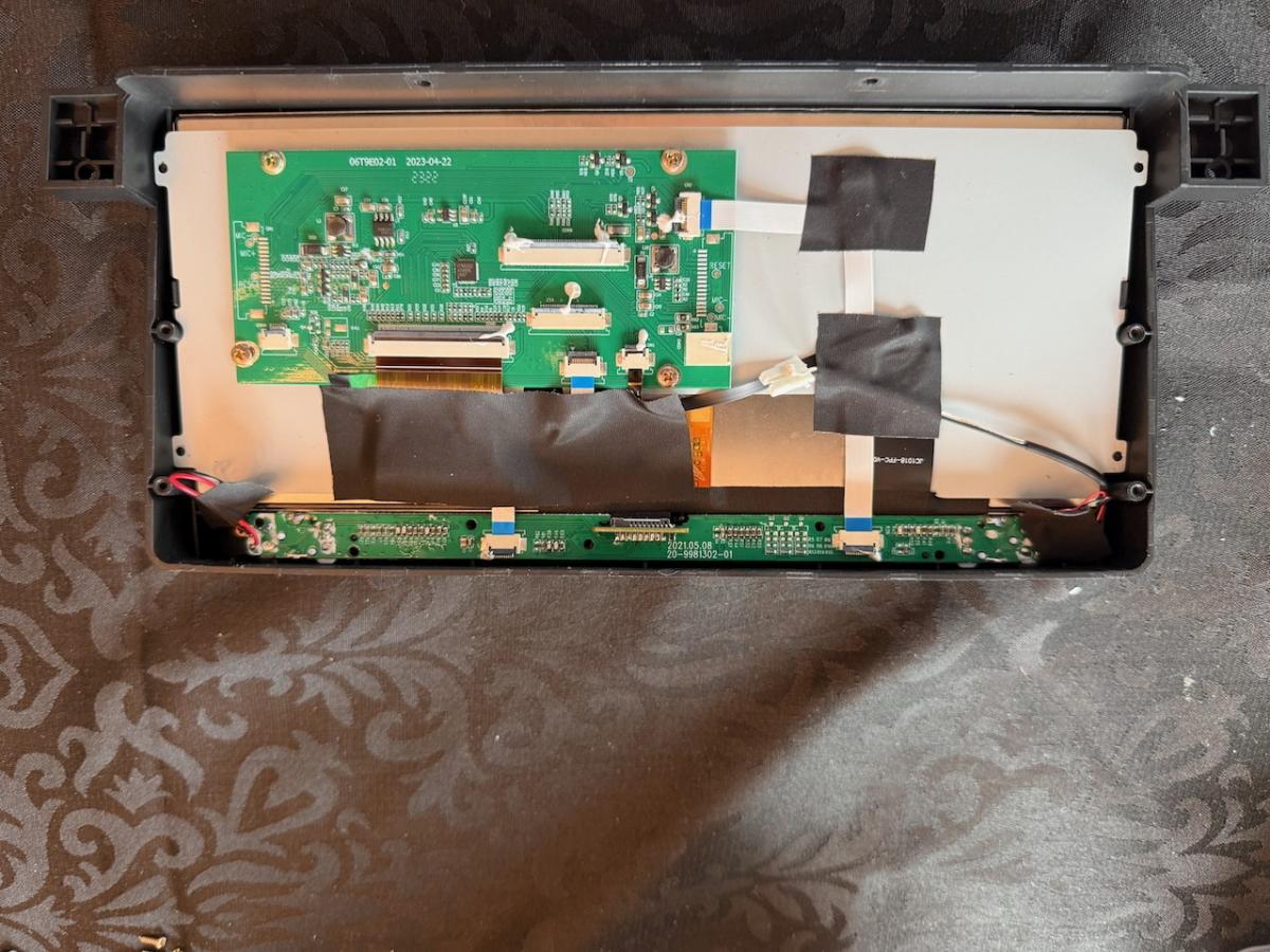

                      Another rainy day here so retaining wall is again on hold. I took the opportunity this morning to finally redo the matte screen overlay on the Xtrons head unit. I got the Xtrons about 16 months ago and have had a much better experience with it than I was expecting. I'm well decided that I'll be keeping it. one of the downsides of it, and many head units is the glossy screen. About a year ago I purchased a matte screen overlay to see if I liked it better. I did my best to line it up nicely but because I had to cut it to size the edges were visible and annoying to me. I've long intended to take the head unit out and disassemble it so that I could replace the overlay over the entire LCD screen so that the edges would be hidden by the bezel if that makes sense. Today was that day.

                      Rear case off:

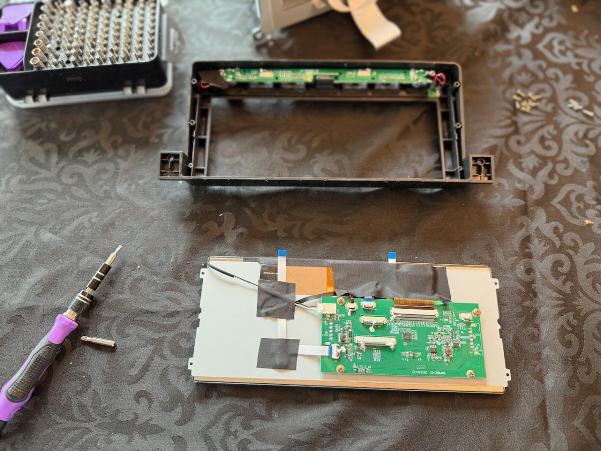

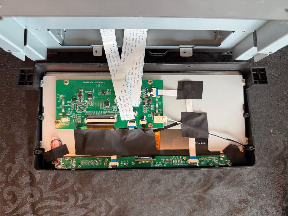

                      Disconnect the two big ribbon cables between the chassis and the display and remove the 4x screws holding the display shield on.
                      Then the display and shield pop out of the bezel:

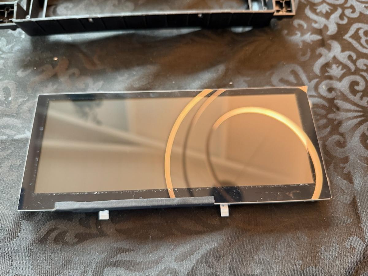

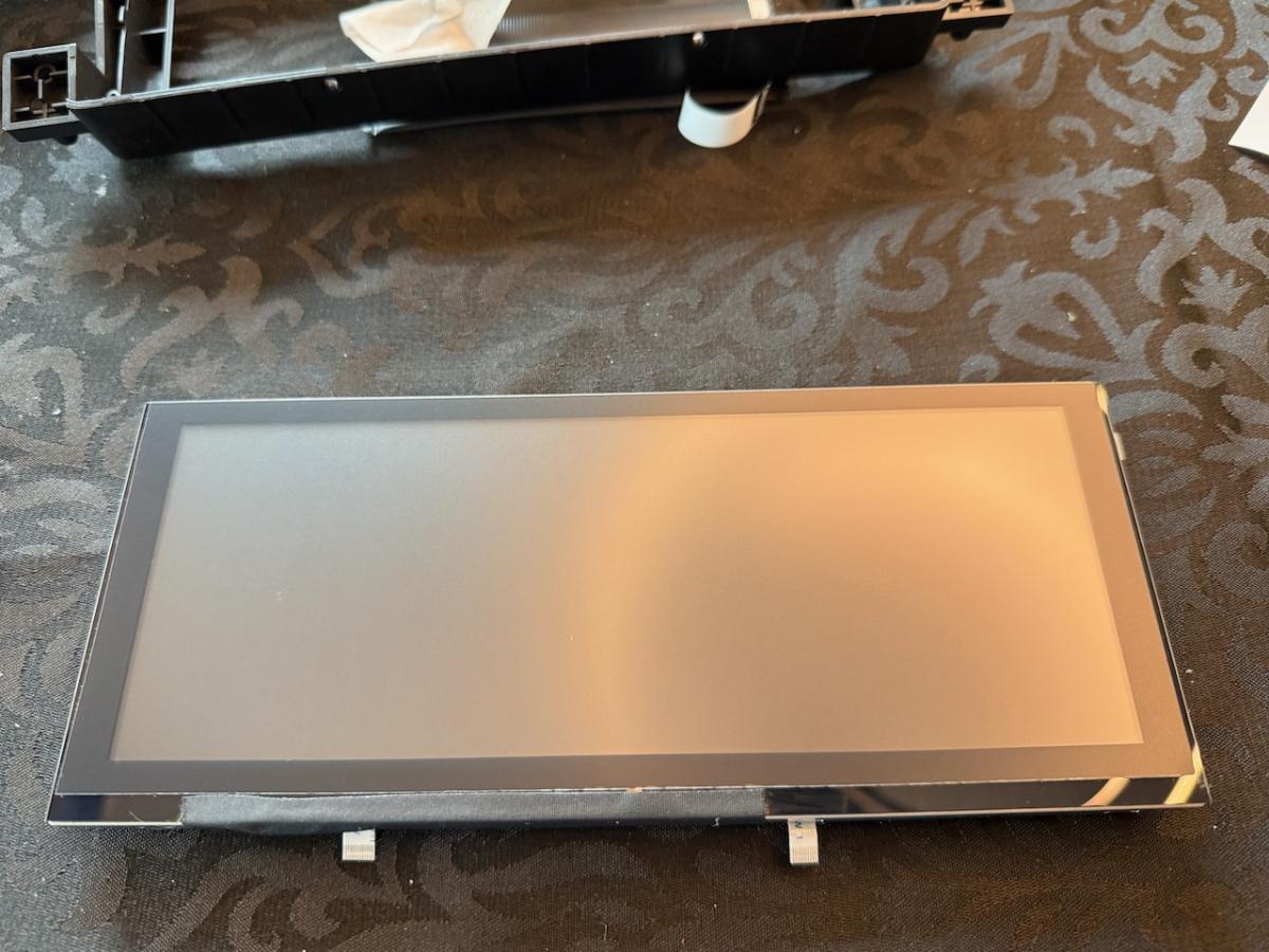

                      The screen with the old matte overlay on it:
                      Old matte overlay removed:

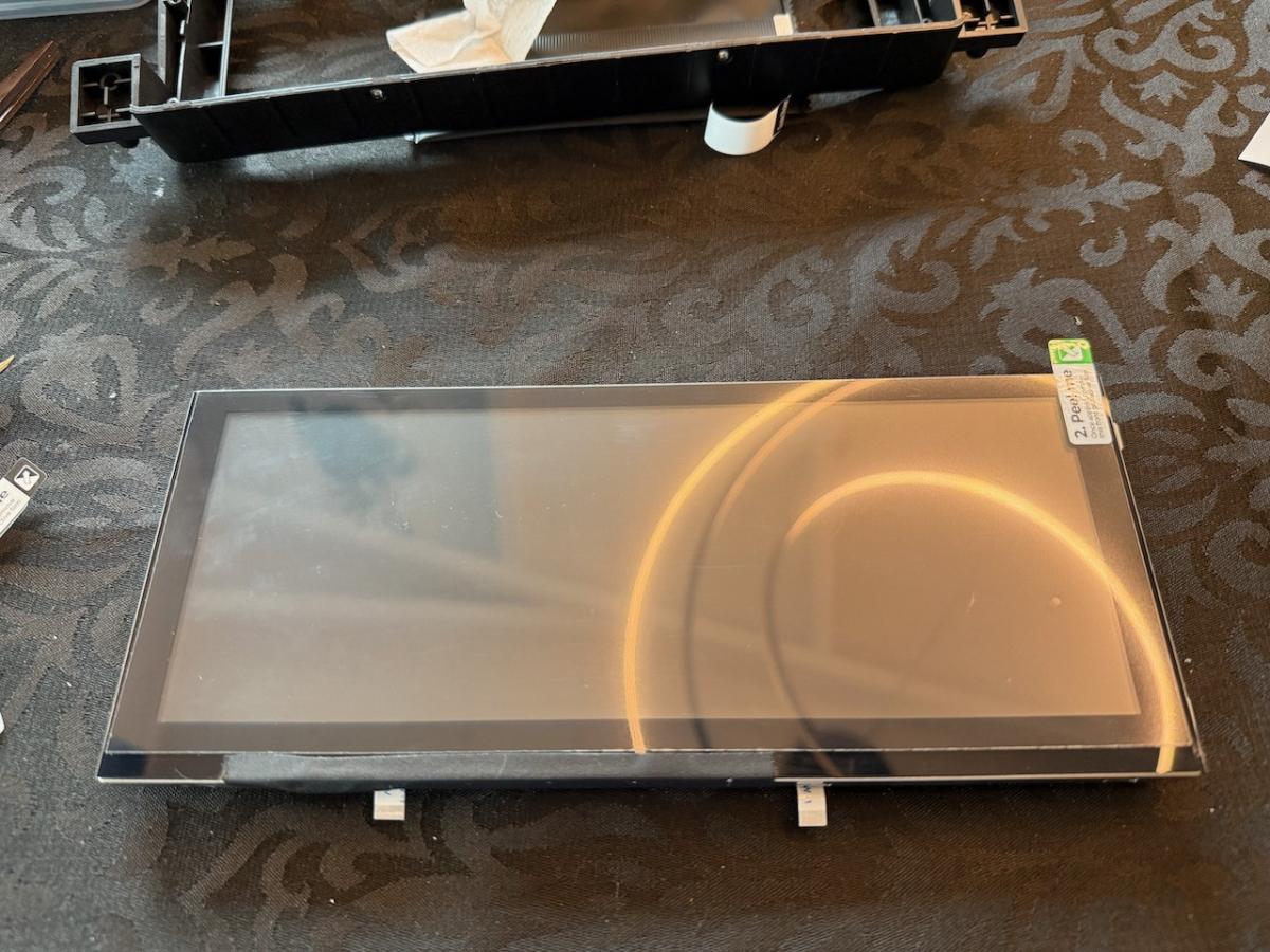

                      I didn't get any photos of applying the new overlay as both my wife and I were employed in getting it on and keeping the screen completely free of dust. We succeeded and the overlay went down perfectly:

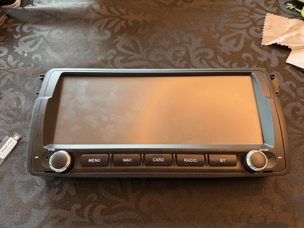

                      The new overlay with the protection layer removed:

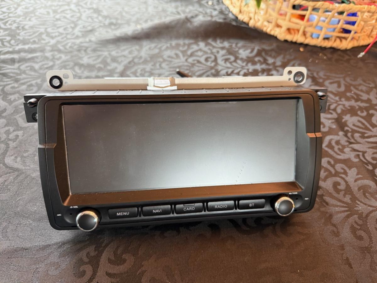

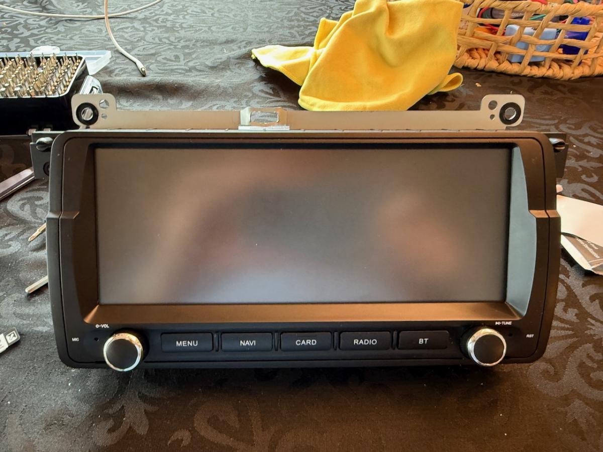

                      Then it was just a case of reinstalling back into the bezel:
                      And reconnecting the ribbon cables and putting it all back together:

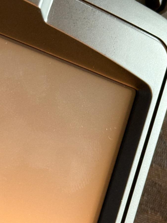

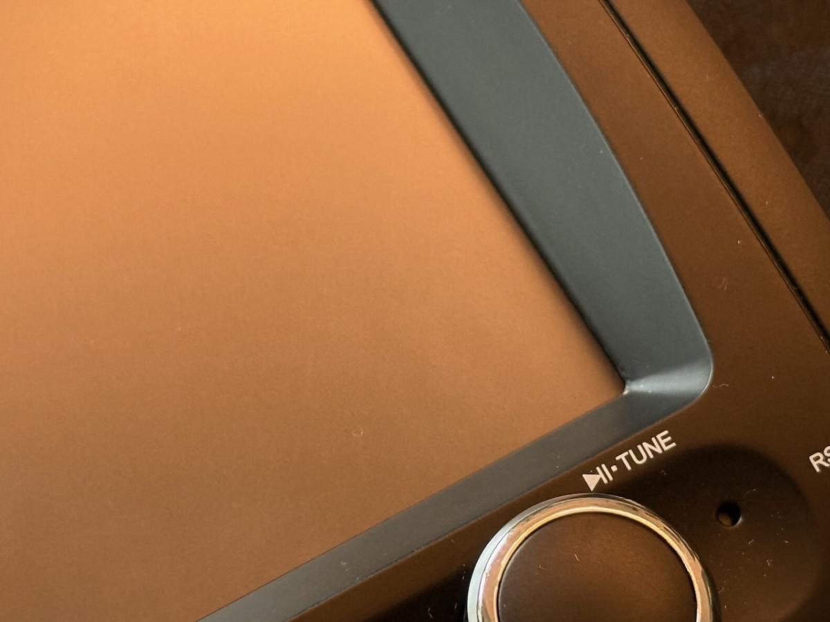

                      I'm super happy with how this has turned out - we got the overlay to go down perfectly and it looks fantastic:

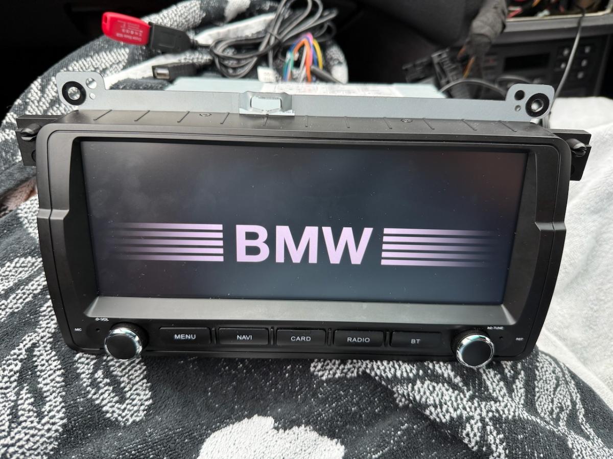

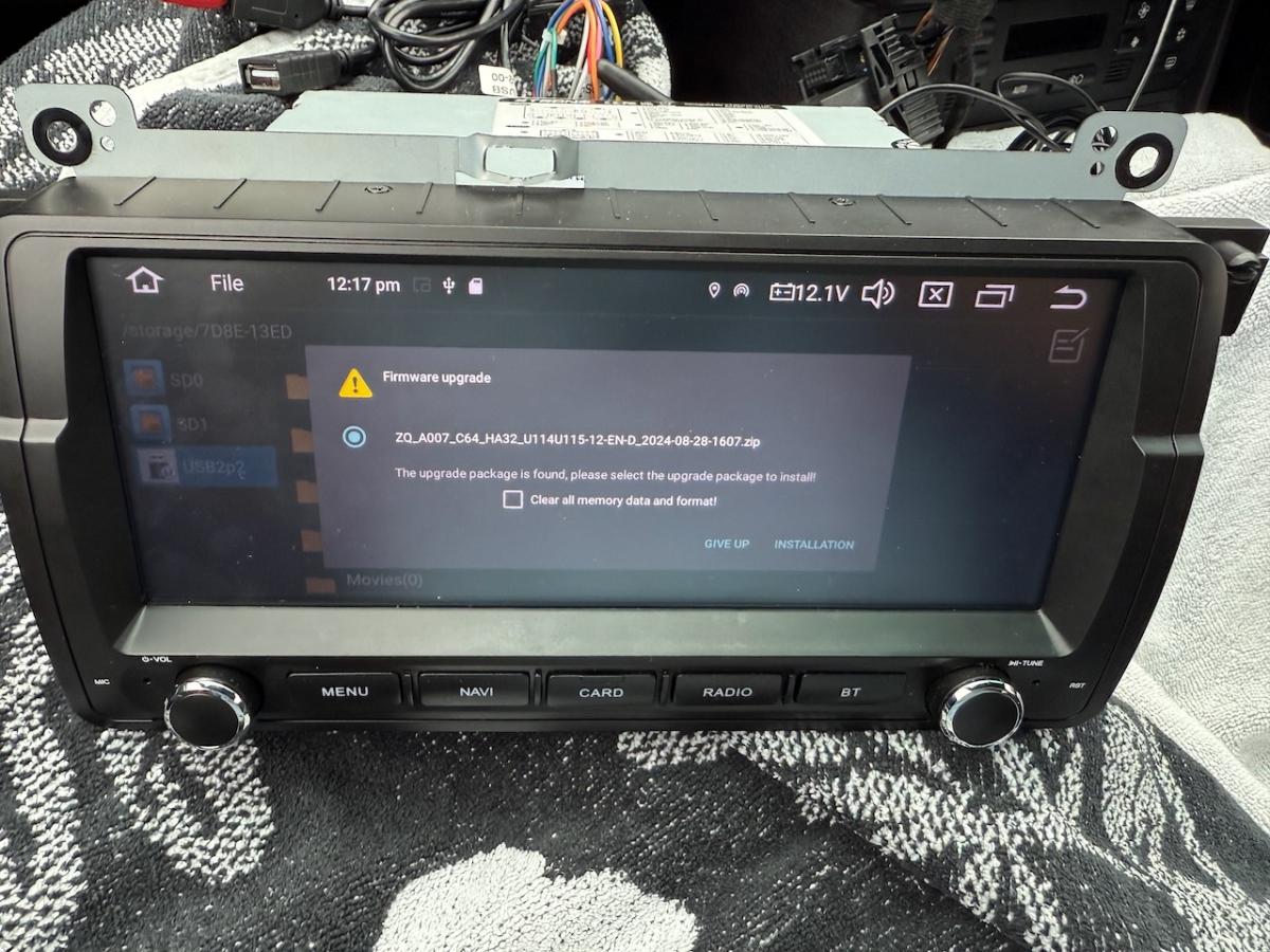

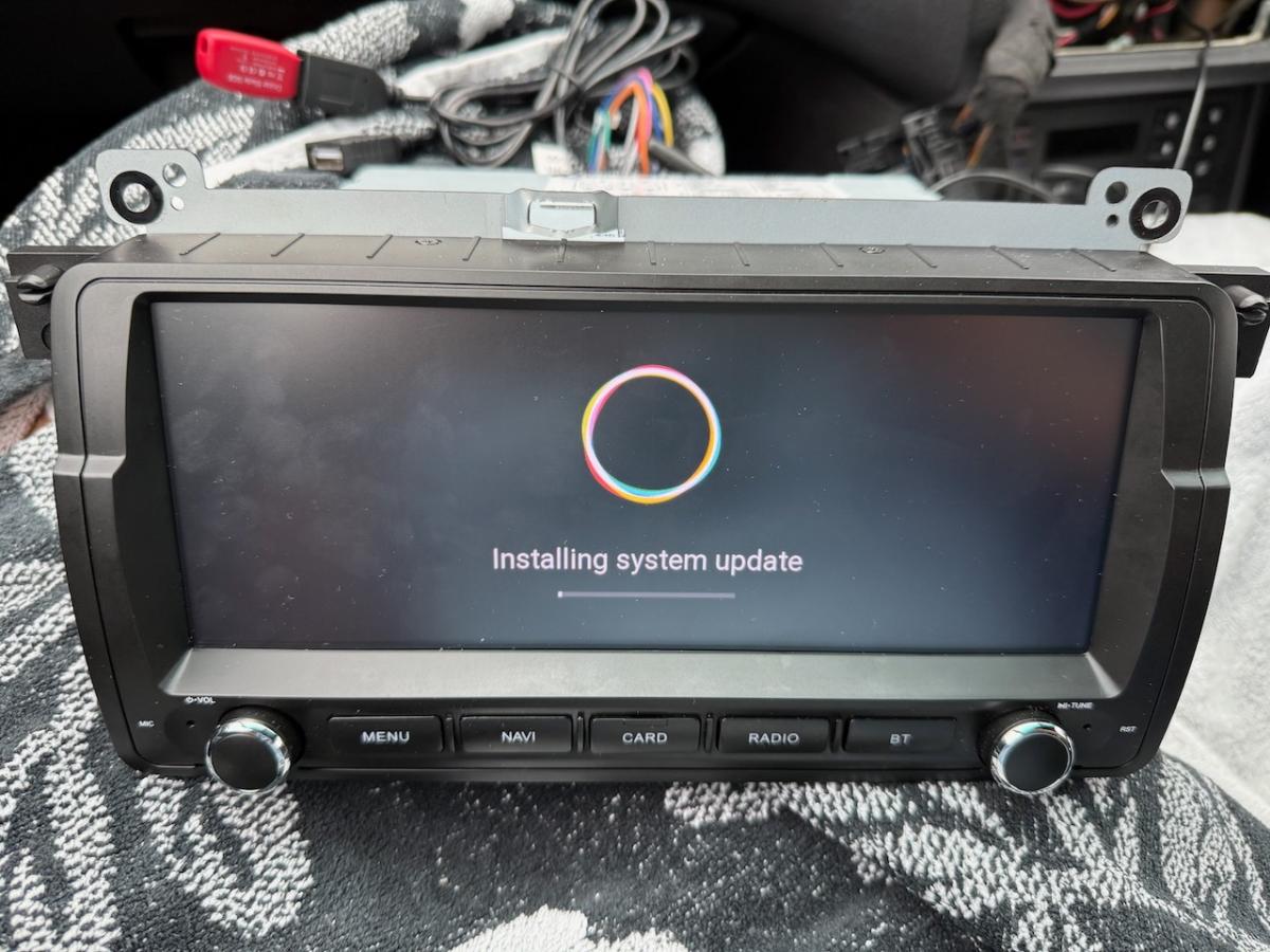

                      While I had the unit out I took the opportunity to plug in the USB extension and install the latest firmware to address the issue with a greater than expected difference between volume levels 4 and 5. This was straightforward and did indeed fix the issue.
                      Now that it's reinstalled I'll give the screen and the head unit a clean to get the fingerprints from install off.

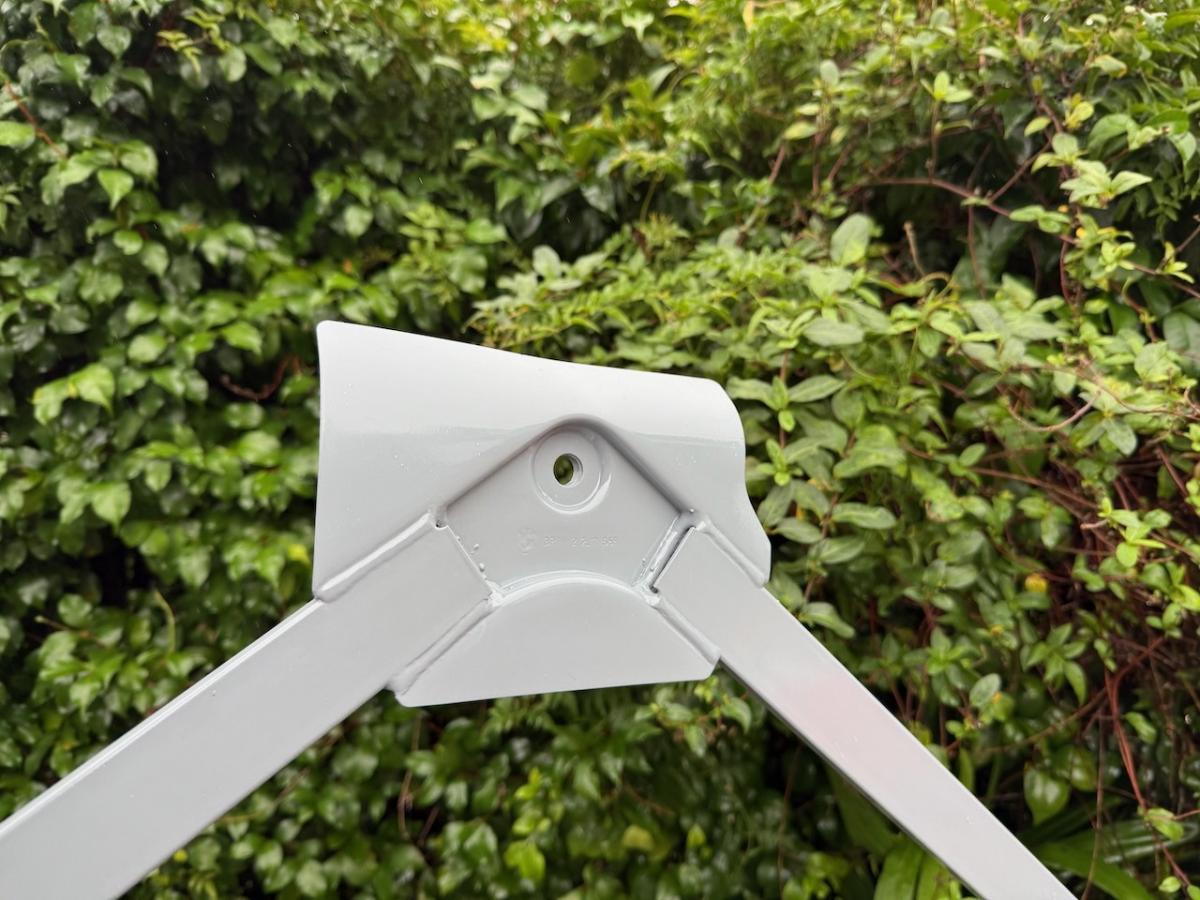

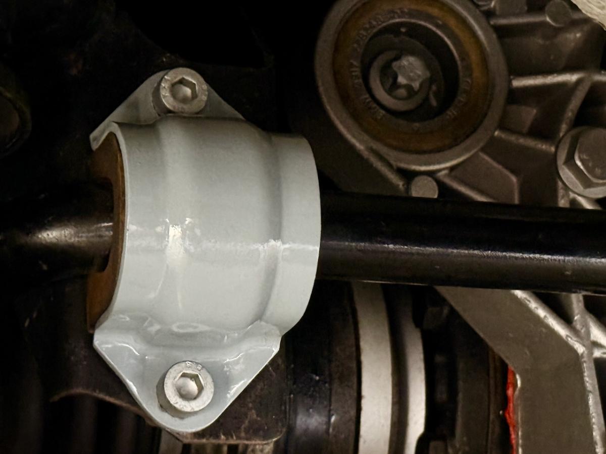

                        Today I also finished up the repainting of the v brace and rear sway bar brackets project. I top coated them a week and a half ago and they've been resting while the enamel fully cured. Today I reinstalled them along with new hardware to match.
