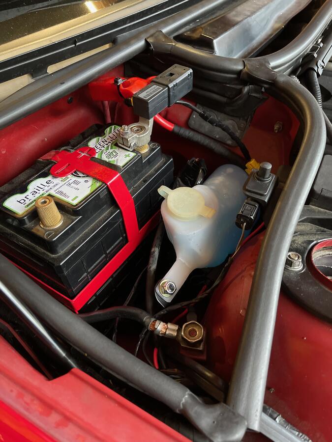

                          Washer tank was leaking so I replaced it (no, it wasn't the seal-- tried that first).

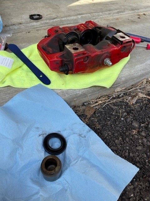

                              I also rebuild one of the 996 calipers, because I had pad failure at my last event of the seasons last year, and it melted the seals.
