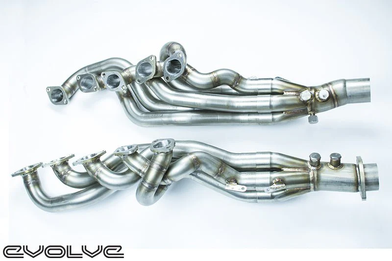

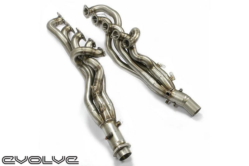

      Nice. Have you seen the equal length stepped headers for the E60 M5 from Euro Power Sports? He has a video up with stock exhaust and those headers and it sounds just amazing and right.
      The evolve long tube headers (made by supersprint) that I have installed are already pretty absurd looking/sounding/power gaining.
      Click image for larger version  Name:	evolve-long-tube-manifolds-bmw-e60e61-m5-e63e64-m6-267760.jpg?v=1730461979.jpg Views:	0 Size:	63.4 KB ID:	298545
      evolve-long-tube-manifolds-bmw-e60e61-m5-e63e64-m6-412491.webp​

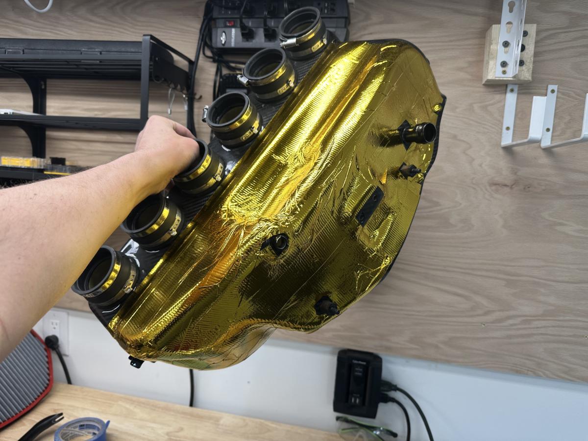

              added some bling
              … but did it such that it will not be visible when the airbox is installed in the car.
              I pretty much have an f1, now.
                I wrapped my entire CSL intake in gold and I got laughed at.
                Well well well lol.

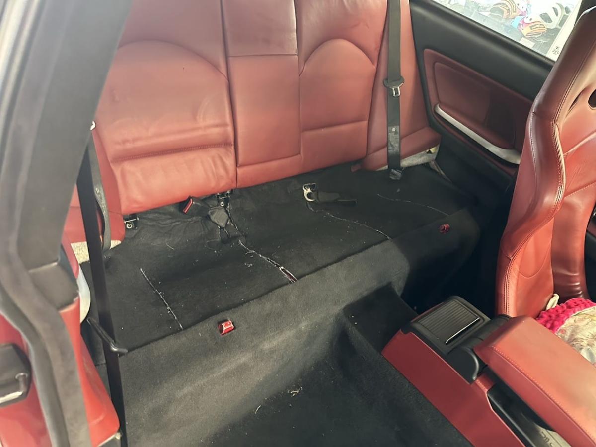

                    Took advantage of my daughter moving from child seat to booster seat and did some hardcore modding today-- updated sound deadening pad under the back seat.
Name:	IMG_5014 Large.jpg
                    Try not to be too jealous.
                      Hol' up, you added weight to the car?
                        I'll be installing mine soon too. Looks great.
                          Technically I think this is lighter than the original rubber sound deadening mat.
                            I actually am very jealous. It's one of those things I keep forgetting to buy...
                              51488204055 (the original rubber mat): 2.83 kg
                              51488252759 (the replacement one): 1.67 kg

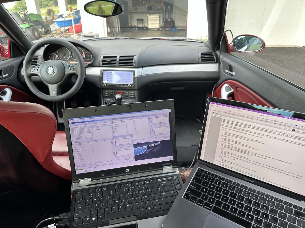

                                Just got back from a failed attempt at data logging with Testo (seemingly didn't record anything), and it is decidedly quieter with that installed.
                                Action shot, reading your post.
