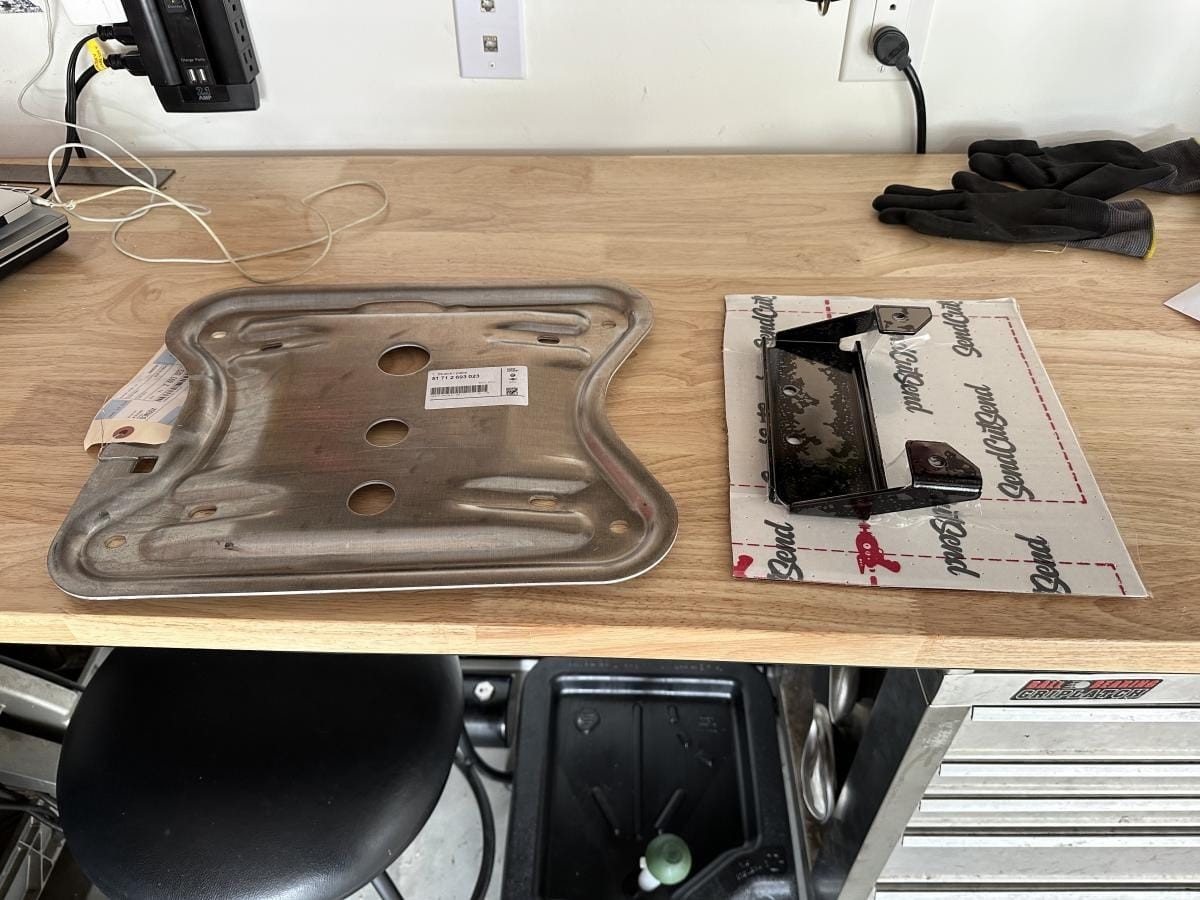

    51488204055 (the original rubber mat): 2.83 kg
    51488252759 (the replacement one): 1.67 kg
    there you go.
    Was hard to be certain, as the original came out in... shards.
      Technically I think this is lighter than the original rubber sound deadening mat.

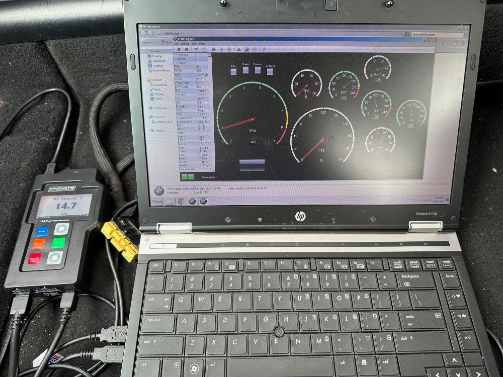

                    Can you share the details on the wide and setup? I've been wanting to install a similar setup for a while. Curious which O2 sensor was used, and if any adapters were required. How you wired it and the cabin hardware/software would be really helpful! Looks awesome!
                      I have this, but the AEM is less of a PITA:
                      The innovate setup I have is very... picky. Picky about power, picky about preheating the O2. I've figured out what it likes now, and can work within it, buy my neighbor has the AEM and it's much more plug and go. Note: He isn't a BMW guy, so can't speak to how well it works with Testo/BMWLogger/etc.
                      In terms of how it's installed, I leave the wideband installed in my header full time and have the plug routed to the drug bin. When I want to log AFRs, I run a cable through the passenger window, under the hood by the cowl, to the drug bin. I only want to monitor AFRs when tuning (not full time), so didn't do any sort of permanent wire routing.
                      Software wise, I started out using BMWLogger (pictured above). It sucks. I'm now using Testo. It is not the most intuitive to set up but once getting past that it's just better.
