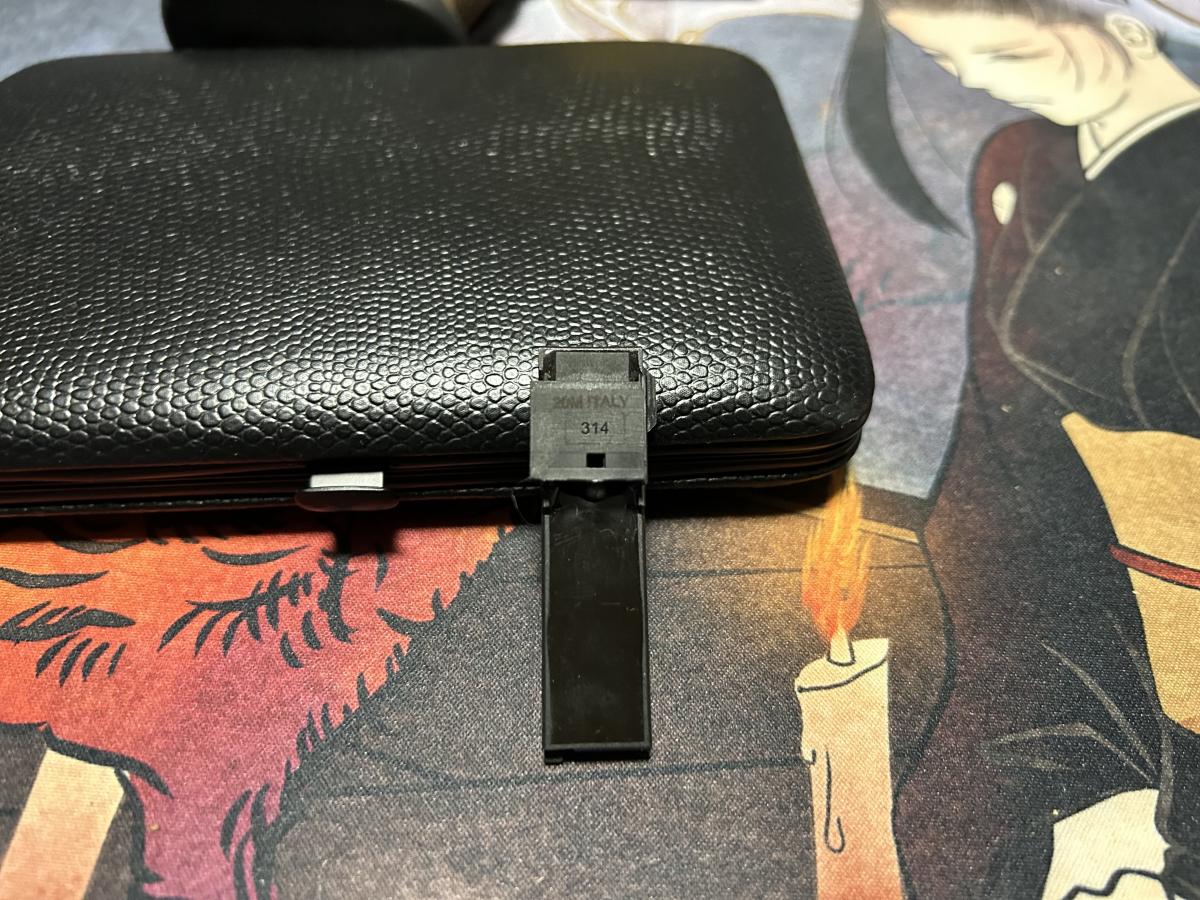

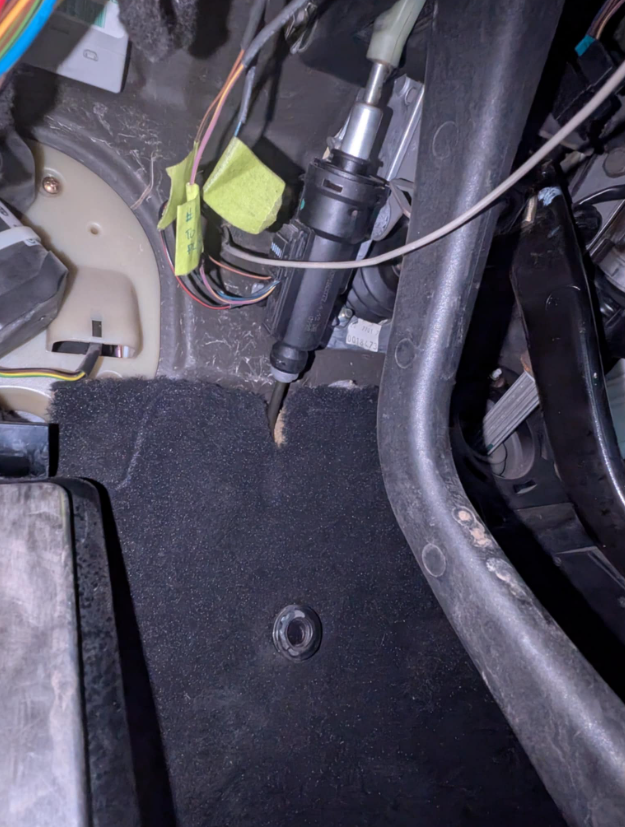

                            here is the clutch switch that was installed on my car. not sure of the part number..

                              I bought a SMG ZCP converted to 6 speed but I have similar issue with OG. This is the clutch switch I have on the car.
                              Instagram : @gc.m3sg
