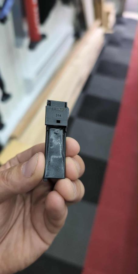

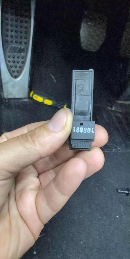

                  I replaced the clutch switch with the new black one that replaces the NLA brown one (PN 61319122700 - written 314 on it). The car idles better and no longer stall at stop, but it is not perfect. Maybe i'm too used to newer bmws now ^^. The one that was installed had 180804 written on it.

                    Originally posted by M3LSB.Gab View Post
                    I replaced the clutch switch with the new black one that replaces the NLA brown one (PN 61319122700 - wrote 314 on it). The car idles better and no longer stall at stop, but it is not perfect. Maybe i'm too used to newer bmws now ^^. The one that was installed had 180804 written on it.
