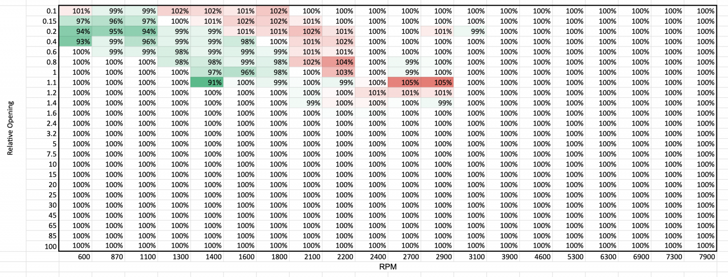

                      Alright, first warm up data log done after flashing the interpolated warm up table. Waited for the car to cool down fully (more than 24 hrs) and started logging immediately after start up. Still only got like 4 minutes of logs before the engine switched over to the hot map...
                      Here's the interpolated warm up table compared to the first iteration using the same lambda integrator method:
                      Click image for larger version  Name:	Screen Shot 2023-12-01 at 12.21.26 PM.png Views:	3 Size:	427.1 KB ID:	244105
                      (I made sure to filter out any points >= 80 C in megalogviewer)
                      So, it's super close to the interpolated table. Considering this table only ever really gets used for a handful of minutes, I think this is my last iteration. Very happy with all this drivability tuning
                      Edit: Attached the megalogviewer warm up settings profile to this post if anyone wants it. Forum doesn't like the ".settings" extension, so just remove ".txt" from the filename and use like normal.

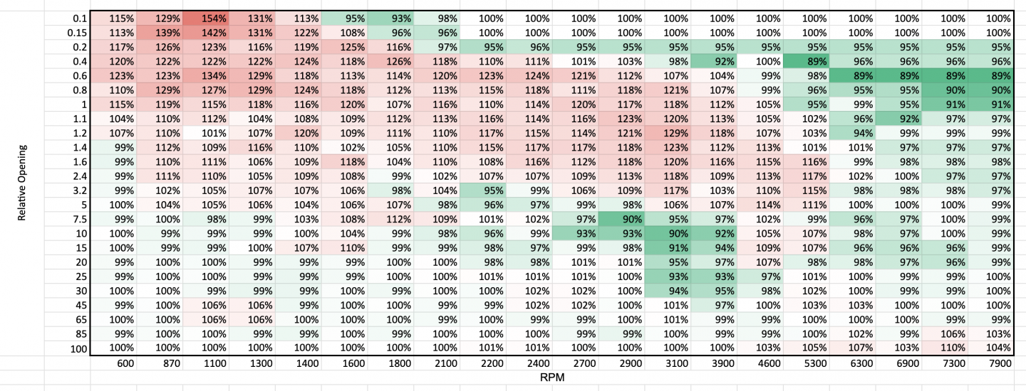

                            For the record, here’s the difference between the default CSL tune and the 5 runs in version using this method on my car. Super clever, thank you for sharing!
                            Click image for larger version Name:	IMG_0692.png Views:	0 Size:	637.4 KB ID:	243562
                            Throttle tip in is so much smoother and the motor seems much happier. I agree that a good amount of the rasp is gone in that mid-2k RPM range. Looks like those CSL cams and the SS headers really do make a difference. With these headers, I needed fuel almost everywhere, and particularly in two islands.
                            My motor is a 180k mile stock internal CSL conversion, with flap, SS v1 headers and matching catted section 1. This tuning was done with flap closed to the appropriate map.
                            Adaptations are now turned back on, so I’ll be watching what the motor does.
                            edit: I’d bet that the resonances and jitteriness in the 2k RPM range can be totally tuned by changing the interpolation motor RPMs. I did this for my WOT tune and was able to get a super flat AFR curve by targeting the resonant and nodal frequencies as the interpolation points.
