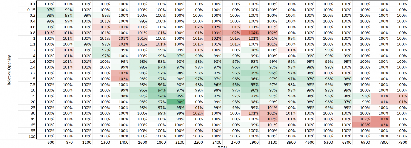

                Click image for larger version  Name:	Screen Shot 2023-11-30 at 10.22.47 AM.png Views:	274 Size:	880.5 KB ID:	243958
                For the record, here’s the difference between the default CSL tune and the 5 runs in version using this method on my car. Super clever, thank you for sharing!

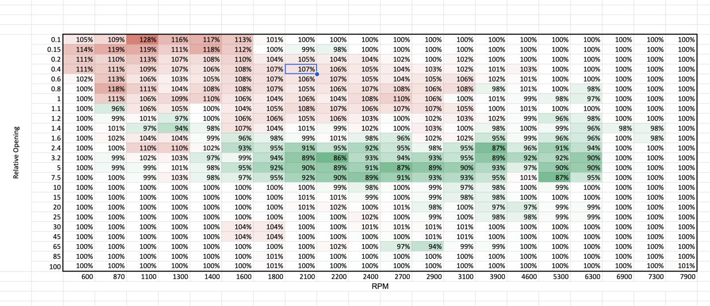

                Frist off, thanks to everyone who worked on this. I have done similar part throttle tuning in other applications but always wondered if it were possible to do for the S54 with more or less "free" software.
                Interestingly my car didn't need many changes. I always thought it ran well without any of the jerkiness that is commonly reported with the CSL tune. My set-up is slighly different than Bry5on and heinzboehmer. I'm running the Karb race box and megan headers with a homebuilt catted 2.5in section 2. Guessing this is related to better airflow with the SS headers or perhaps a more refreshed fuel system. New pump and filter within the last 1000 miles.
                I logged for around 20-30 minutes and tried to vary load and hit as many engine speeds as I could. A bigger dataset would certainly work better. Next step is to get more data and set-up my wideband for WOT fueling.
                Click image for larger version  Name:	image.png Views:	0 Size:	774.0 KB ID:	256802​

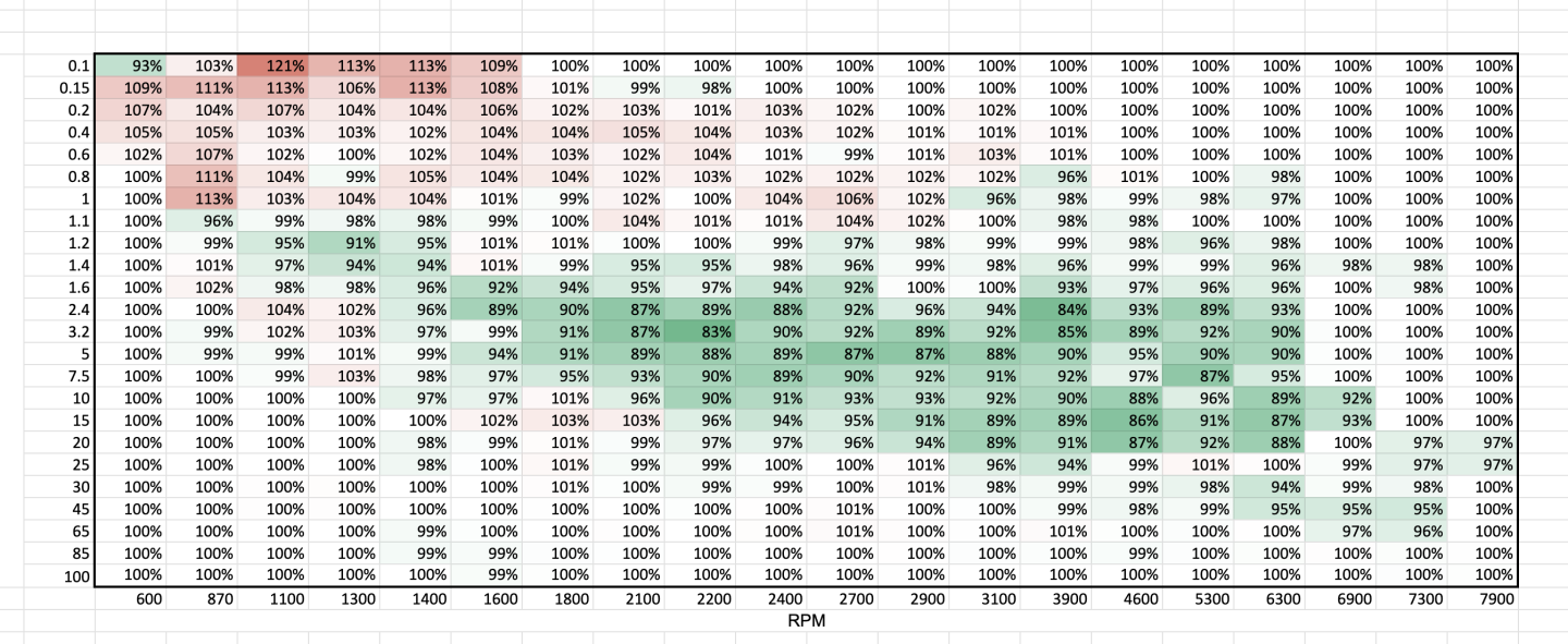

                  Finally changed sparks and oil and made about 1,30 hour run
                  Comparsion to stock CSL
Name:	Снимок экрана 2024-04-18 в 17.37.14.png

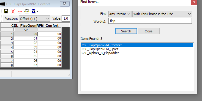

                                Can someone tell me which table is for disabling flaps enrichment? I did comfort and sport to make them always open
