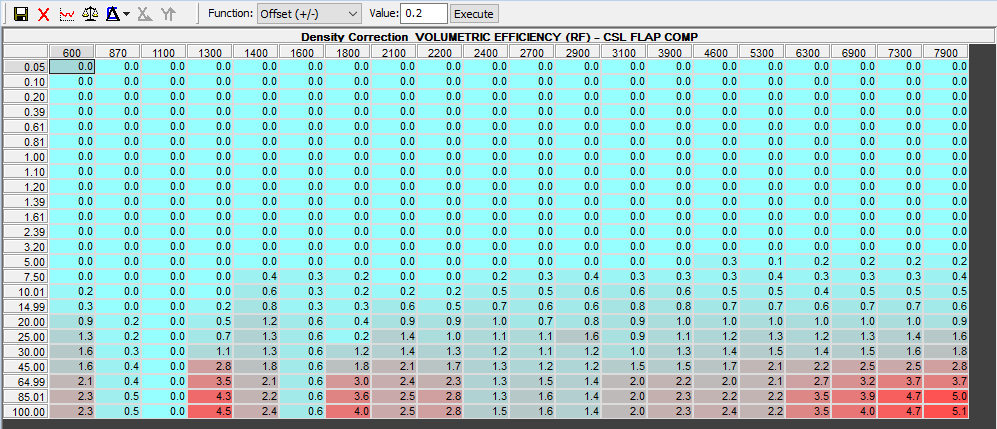

        So I did a run with flaps turned open all the time and most the bucking I had in 2-3k rpm is gone, the flap comp map is mostly 0 but I still wonder if it worth trying to make it all 0? As it would still compensate

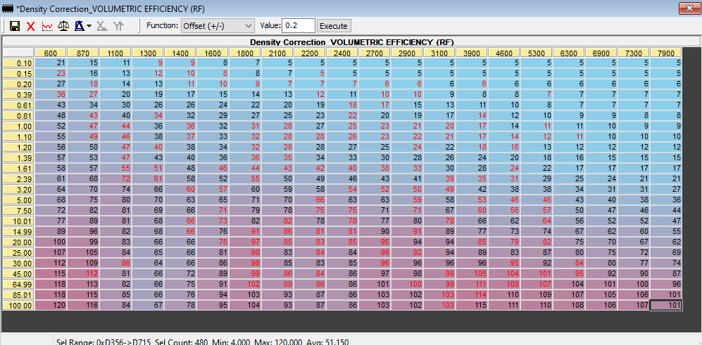

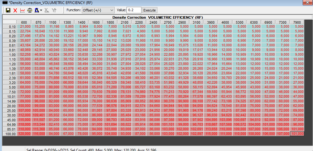

        Also I did the logging as author suggested, after a good long drive my log wasn't that far off (1-5%) but the problem that I can't save Density map with decimals, it would only allow me to save if round the numbers. Is that normal? In author video he shows saving with decimal values

          You want the compensation at higher loads all the time. If you zero the whole map, you will not get enough fuel until you do a full retune again. The map has no effect whatsoever where the cells are zero. Zeroing that map will only make your life harder! Looks like yours is running with the correct amount of fuel pretty much everywhere, although I’m surprised that solved your bucking issues.
            #80
            Change the type from int to float. I think I posted up more details in one of my earlier posts.

                #82
                But did it used this map before I made flap open all the time? It is swapped in E36 so it doesn't see gear or speed and I used comfort for mapping on dyno which is set 9k rpm opening by default from neutral to 2nd gear.
