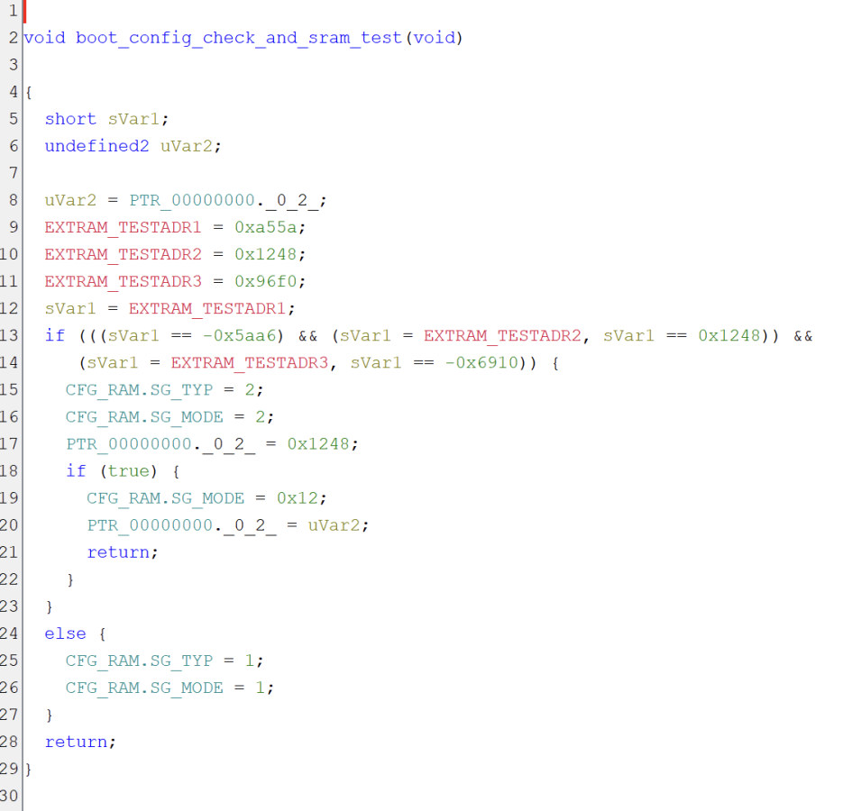

              The last 20 or so functions in the program ROM seem to be related to the CAN B functions so I'm going to say yes. Furthermore I think that this function plays into it as well:

              This function checks to see whether it can successfully write and read to "EXTRAM" test addresses. if it can it sets SG_TYP and SG_MODE to 2, if it can't it sets it to 1.
              In the A2L SG_TYP == 1 means "Basic Mode" and SG_TYP == 2 means "Applications Mode". That in turn seems to govern whether the CAN "B" is used or not. So I think what the DME does is boots up and checks to see whether it has access to the extra external RAM that is used for storing the ROM as RAM for Gredi, and if it does then it puts itself in a mode where it expects to be communicated with via CCP (Gredi).
              And yes, I doubt that there is a practical way for us enthusiasts to take advantage of this...

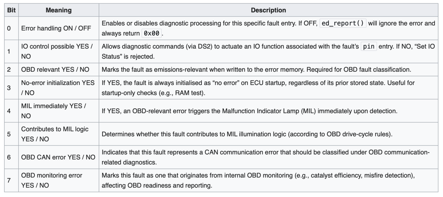

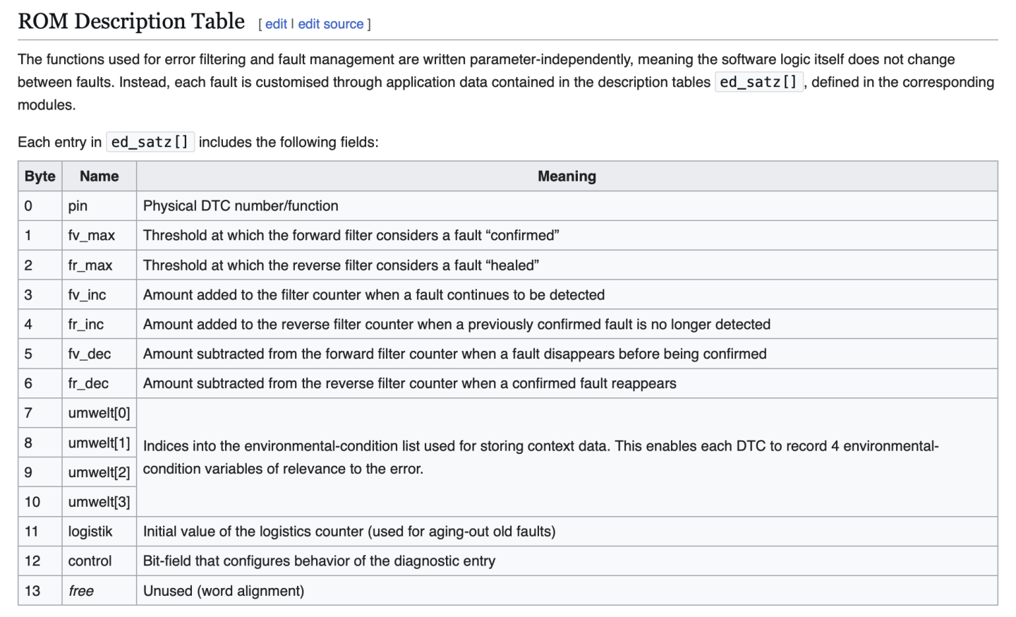

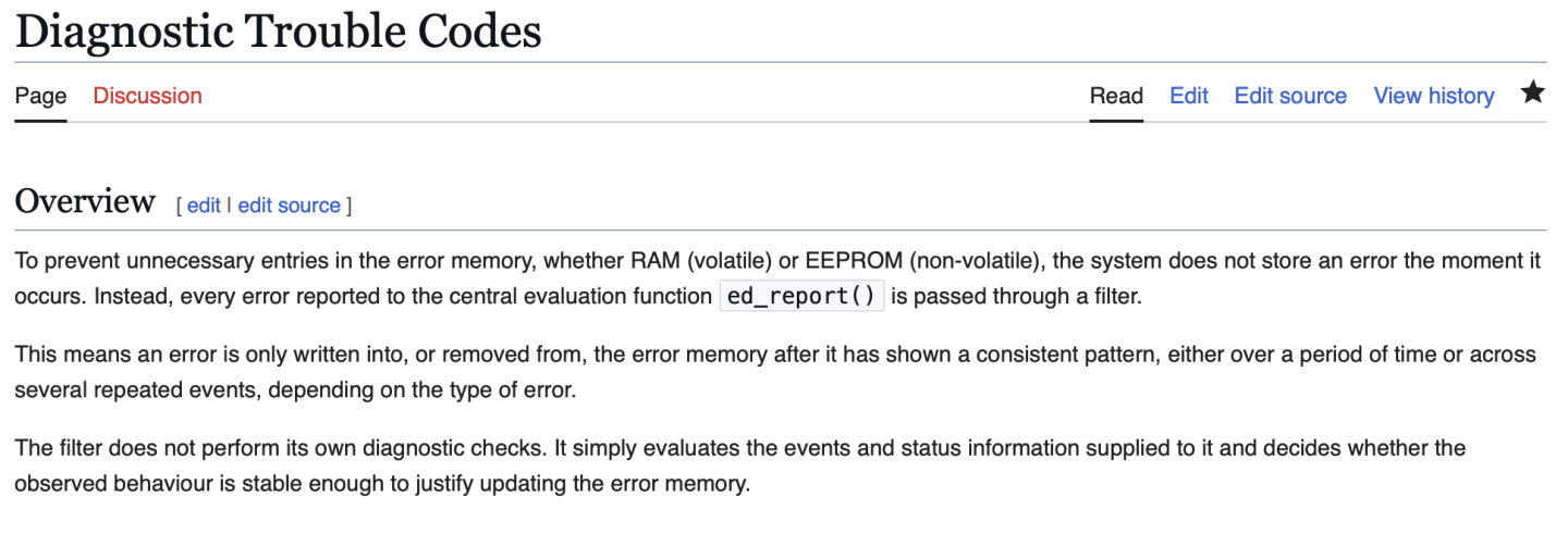

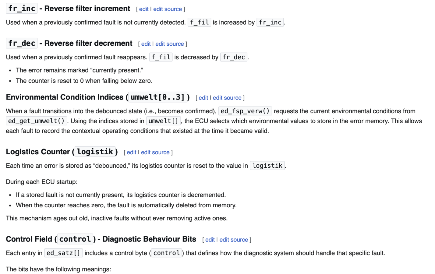

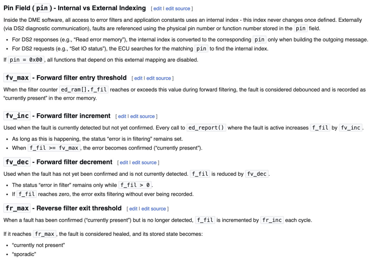

                                Have been working on this on and off for a while - here's a more complete view of how the DTC configuration table works and what each of the values means.
                                Of note is that of the various "strategies" that exist to delete DTCs, the control byte (byte 12, or 13 if you're not using zero-based indexing ) is the only one that matters.
