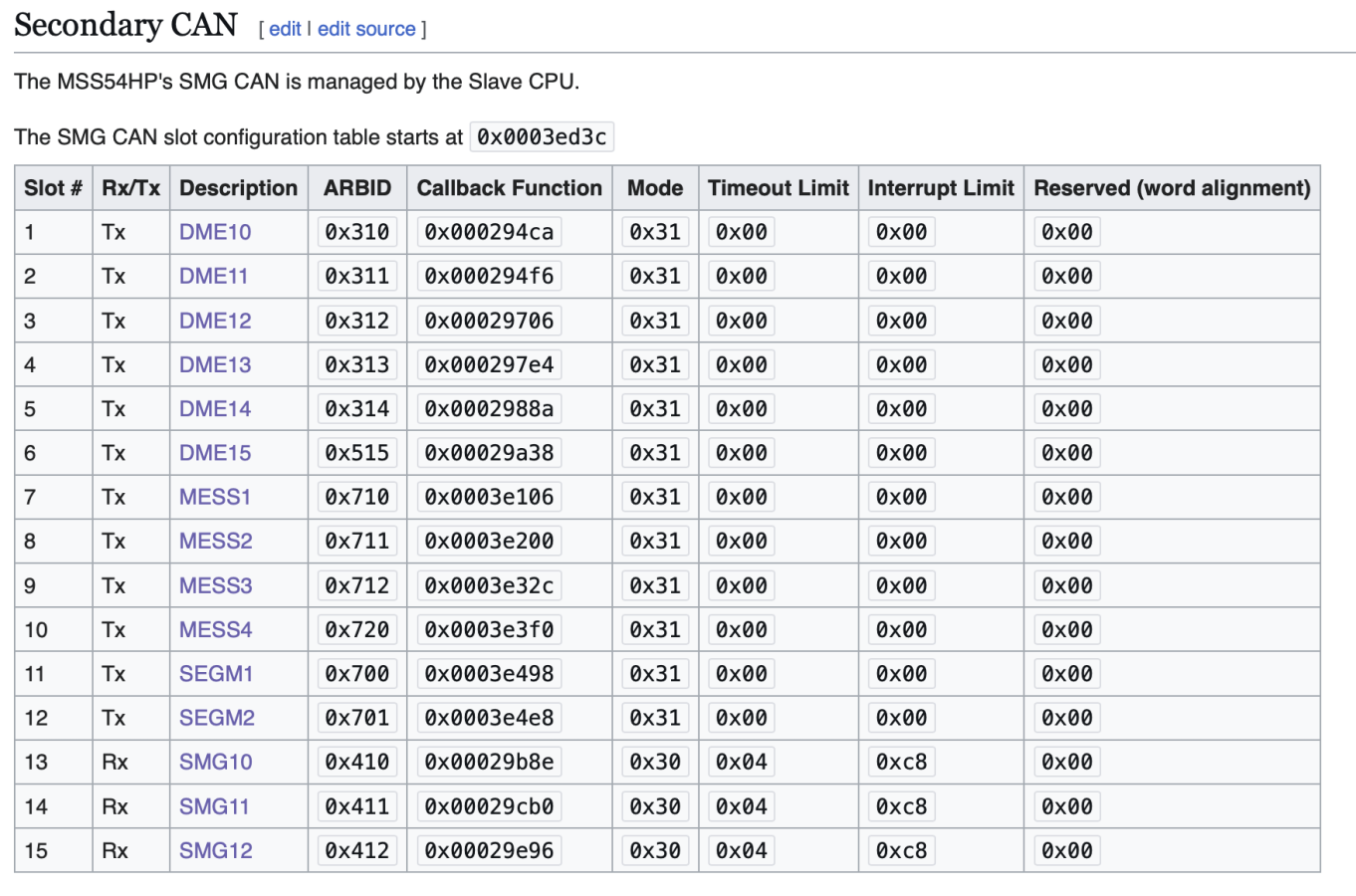

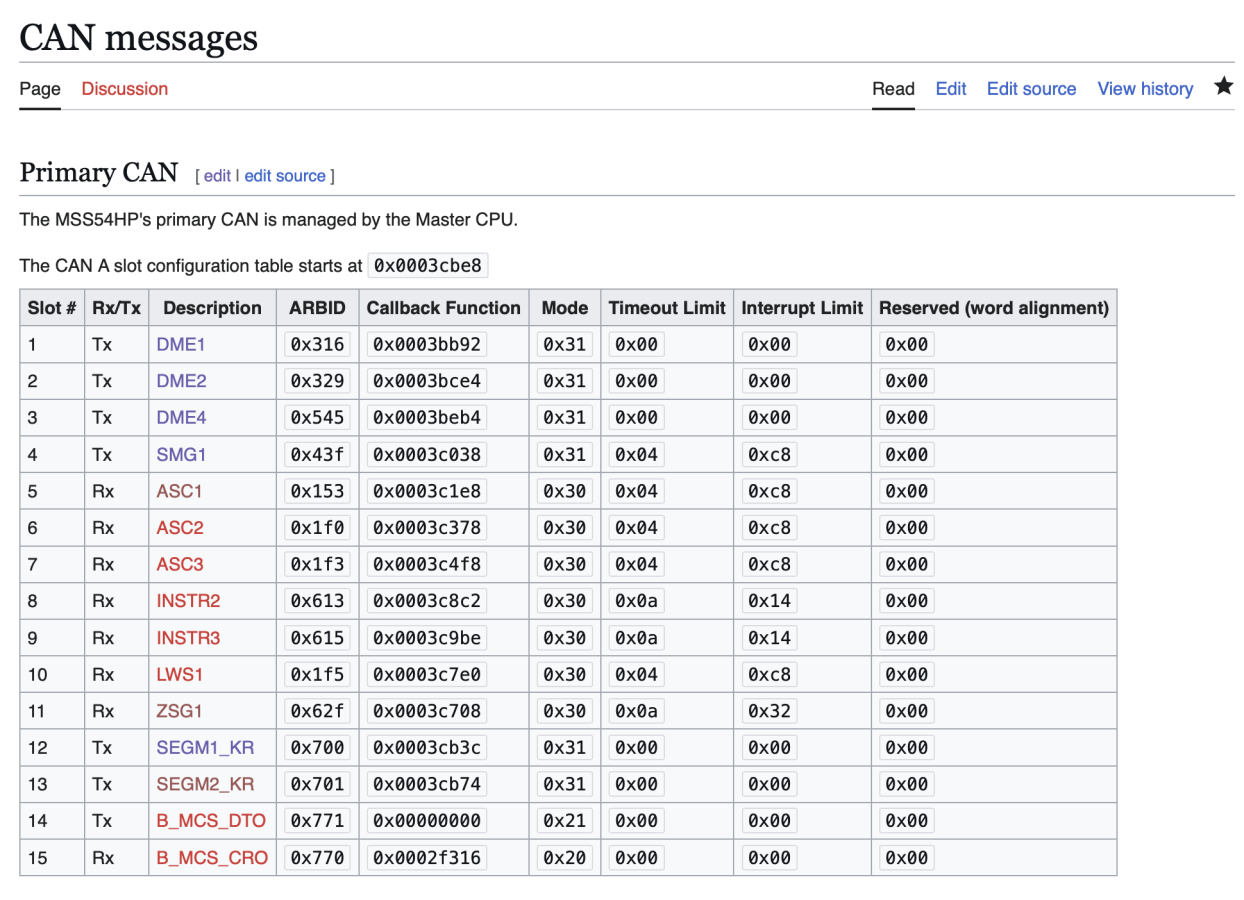

    I'm also working on fully documenting all the CAN messages for both the primary and secondary CAN busses. It's slow going as there's an awful lot of work to figure things out, sense check them against other functions that use the values, etc.
    I'm about a 3rd of the way through having the detailed documentation for the Primary CAN completed, and will post it all up here once I get that done, before I move on to the detail for the secondary (SMG) CAN.

                Hey thanks for this - yes I've read through Olza's work. I guess you could say I'm going through the disassembly and independently verifying based on the disassembly. Not because I have any reason to doubt the work others have done, but I need to be completely sure that I'm not inadvertently introducing any mistakes into my disassembly, so need to figure everything out from primary sources.
