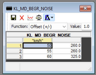

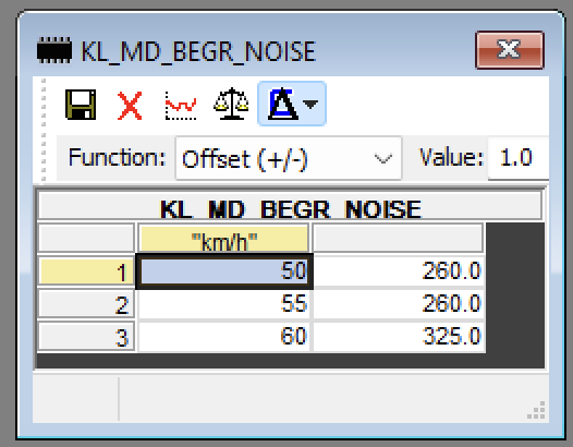

                          Random aside.
                          One of the torque limitations in the Moment Manager is to restrict maximum torque below a certain vehicle speed under certain conditions in order to quote "reduce noise". I've seen others edit this out by adjusting KL_MD_BEGR_NOISE to not have restricted torque below 60 km/h.
                          Click image for larger version  Name:	Screenshot 2025-06-13 at 4.42.42 PM.png Views:	0 Size:	15.3 KB ID:	308395

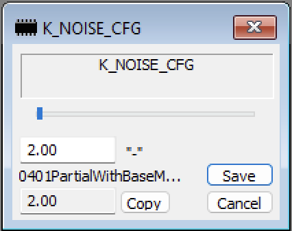

                          Worth noting that if you want to turn this off completely you can simply set K_NOISE_CFG to 0.
                          Click image for larger version  Name:	Screenshot 2025-06-13 at 4.43.40 PM.png Views:	0 Size:	11.1 KB ID:	308396
                          Click image for larger version  Name:	Screenshot 2025-06-13 at 4.44.12 PM.png Views:	0 Size:	176.4 KB ID:	308397

                          - If you set bit 0 of K_NOISE_CFG to 1 you can make the car use the VANOS noise tables.

                            You mean I’ve only had 80% torque in first gear this whole time?! Ha
                            punched this in to ChatGPT for fun. It immediately figured out this is a noise management routine for a car
                            START noise_st_calc
                            |-- Is speed in mid range AND correct gear selected AND motor is active?
                            | |-- YES --> Add time since last check to "valid condition timer"
                            | |-- NO -->
                            | |-- Is speed out of bounds OR wrong gear AND noise mode is not active?
                            | |-- YES --> Reset "valid condition timer" to 0
                            |-- Is:
                            | - throttle/power demand high enough
                            | - speed in valid range
                            | - correct gear selected
                            | - "valid condition timer" exceeds required threshold?
                            | |-- YES --> Set noise mode to ACTIVE (set high bit)
                            |-- Is:
                            | - noise mode currently ACTIVE
                            | AND
                            | - throttle is too low OR wrong gear selected OR speed out of acceptable range?
                            | |-- YES --> Deactivate noise mode (clear high bit) AND reset timer
                            |-- Save current system time as "last checked time"
                            |-- Is noise mode INACTIVE OR noise feature is DISABLED in configuration?
                            | |-- YES --> Clear low bits (0 and 1) of noise state
                            | |-- NO --> Noise is ACTIVE AND config is enabled:
                            | |-- Is "mode bit 0" enabled in config?
                            | | |-- YES --> Set bit 0 in noise state
                            | |-- Is "mode bit 1" enabled in config?
                            | |-- YES --> Set bit 1 in noise state AND RETURN
                            RETURN​
                              My E60 M5 6spd did the same thing, ign based torque management, I disabled it and it turned my description of the car from “quite civil” to a “burnout machine”…
                                Well I’m definitely going to be disabling this now that modern tires are grippier. That’s an extra 50ft-lbs in first gear! Here we go.
                                Also, this would be a cool thing to have enabled/disabled based on sport mode. Wonder why they didn’t do that.
