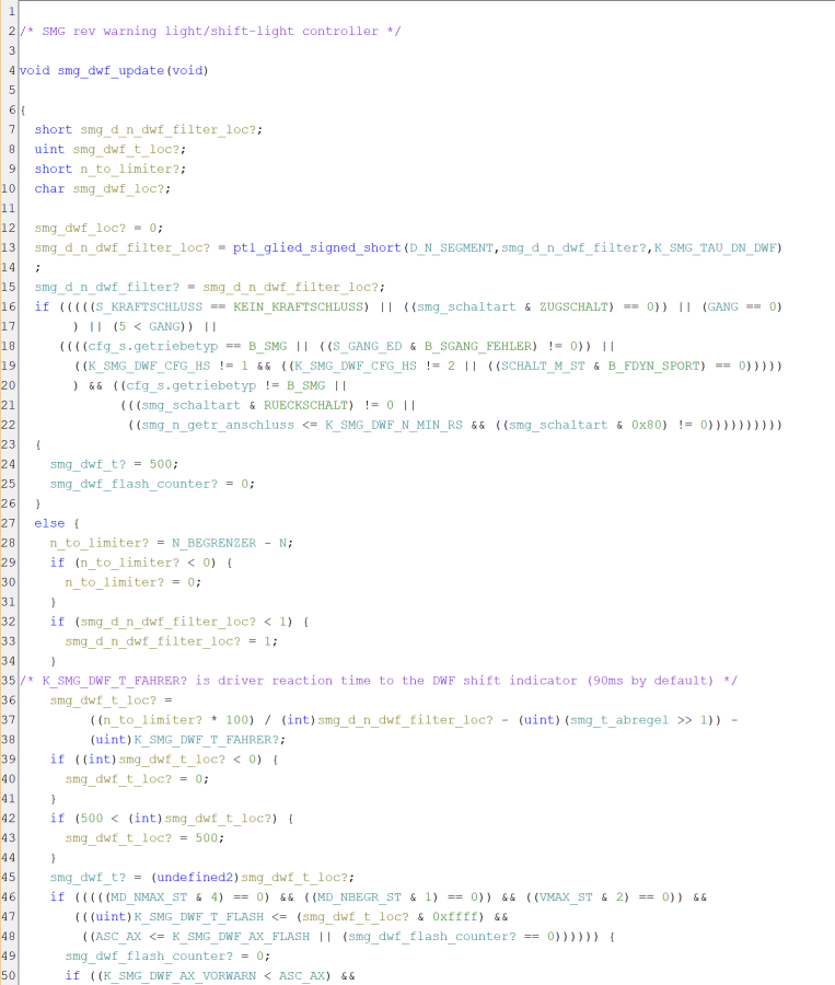

        I've been doing a bunch of work on figuring out the SMG module in the slave binary. This is one of the areas the least information is available on, so there's a lot to work through and figure out. I've been making some great progress though.
        There's 53 SMG functions in the slave binary, divided into the following sub-modules if you will:
        - Clutch (manipulation of the clutch)
        - Motor (e.g. motor torque and speed regulation)
        - Shifting (changing of gears)
        - Common/basic (init functions, the task functions, DPR, IPK, SK (safety concept), etc.)
        Of note is that the SMG module has its own IPK messages to transfer critical values between the slave and the master. Some of these come straight off the SMG canbus and go via the IPK to the Master, others are generated by the SMG module functions and the results are sent to the Master (e.g. torque and engine speed regulation for the SMG).
        The SMG also has its own freeze-frame generator for error reporting, so SMG-specific variables can be captured.

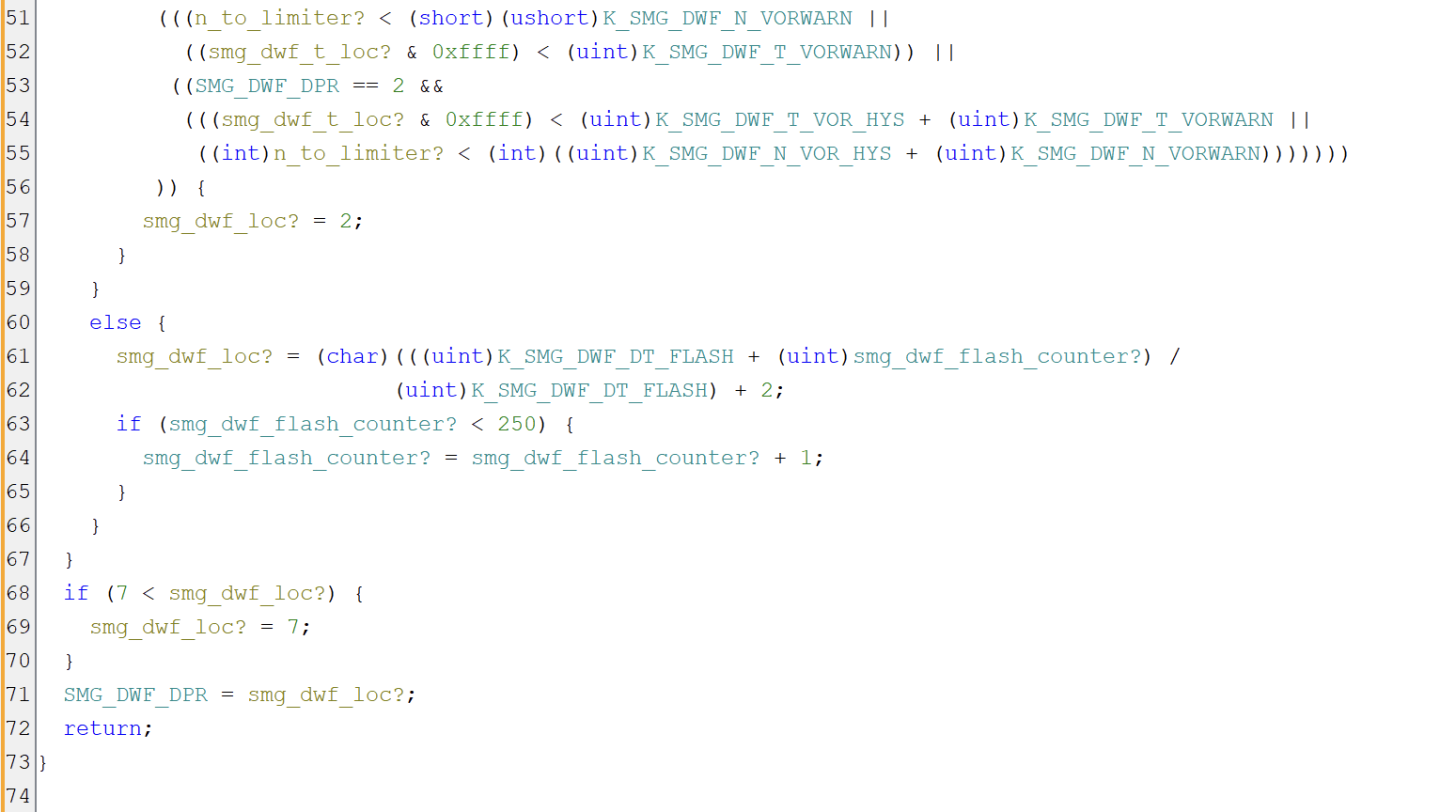

        I've got more work and cross validation to do before I share everything, but for now here's the function that handles the well-known "limiter shift lights". "K_SMG_DWF_CFG_HS" is the parameter that can be changed to enable shift lights for non-SMG vehicles.

          Appreciating this great work! Can't wait for the SMG to be finished so I can start on the 1st Gen DCT implementation: https://www.shop.rusefi.com/shop/p/ua-can-bridge

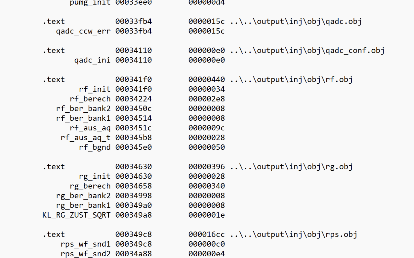

                There's a lot of information in those files - the MAP files have a listing of all the objects, in order, with function names.

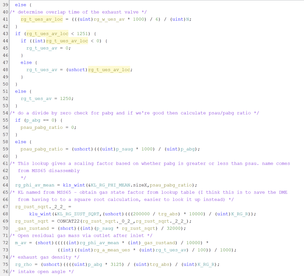

                    Here's the MSS65 rf_berech()
Name:	Screenshot 2026-01-18 at 2.35.50 PM.png
                      Okay - been having a bit of a look at this in more detail. It's extremely useful. As you suspect terra there are some fairly strong similarities between 0401 and this. They are far from identical, and the MSS65 code seems to be more advanced in some ways. But I've been doing a comparison on the residual gas mass functions. Good news is that my interpretation of them was correct. Secondly there's a bunch more parameter names I'm going to be able to confirm out of this.
                      Very cool.

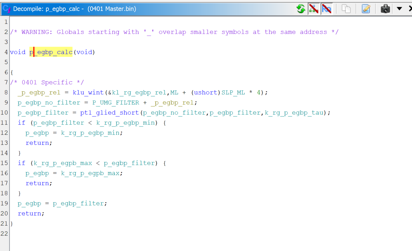

                        Calculation for exhaust gas back pressure is pretty much identical:
                        MSS54 (0401)
Name:	Screenshot 2026-01-18 at 4.39.32 PM.png
                        MSS65
Name:	Screenshot 2026-01-18 at 4.39.37 PM.png
                        MSS65 stores rg parameters in a struct which is why there are all of the pointer offsets

                            I feel relatively confident the psau object and associated naming convention is pretty close to what's in the CSL (minus bank1 / bank2 stuff probably) though I need to dust off my binaries and disassemblies and look closer. Reproduced relevant stuff below
                            Code:
                             .std_appl 000608c4 00000084 ..\..\output\inj\obj\psau.obj
                            K_PSAU_STEIGUNG 000608c4 00000002
                            K_PSAU_OFFSET 000608c6 00000002
                            K_PSAU_DIAG_MAX 000608c8 00000002
                            K_PSAU_DIAG_MIN 000608ca 00000002
                            K_PSAU_ERSATZ 000608cc 00000002
                            K_PSAU_ADAPT_MAX 000608ce 00000002
                            K_PSAU_ADAPT_MIN 000608d0 00000002
                            K_PSAU_TAU 000608d2 00000001
                            K_PSAU_MZYL_A 000608d4 00000002
                            K_PSAU_MZYL_E 000608d8 00000002
                            K_PSAU_MRG_A 000608dc 00000002
                            K_PSAU_MRG_E 000608e0 00000002
                            KL_PSAU_ZAHN_OFFSET 000608e2 0000002a
                            KL_PSAU_MZYL_DASP 0006090c 0000001e
                            KL_PSAU_WF_DASP 0006092a 0000001e[
                            .text 00033398 000009a8 ..\..\output\inj\obj\psau.obj
                            psau_diag 00033398 000000c8
                            psau_ausw_10ms 00033460 00000120
                            psau_init 00033580 00000128
                            psau_10ms 000336a8 00000054
                            psau_adaption 000336fc 00000080
                            get_qidx 0003377c 00000034
                            get_mw 000337b0 0000007c
                            psau_ausw 0003382c 00000504
                            psau_auf_bank1 00033d30 00000008
                            psau_auf_bank2 00033d38 00000008
                            psau                            .vars       .std_vars      ..\..\output\inj\obj\wf_fkt.obj
                                                                                              ..\..\output\inj\obj\ti_fkt.obj
                                                                                              ..\..\output\inj\obj\rps.obj
                                                                                              ..\..\output\inj\obj\rg.obj
                                                                                              ..\..\output\inj\obj\rf.obj
                                                                                            * ..\..\output\inj\obj\psau.obj
                                                                                              ..\..\output\inj\obj\mzyl.obj
                                                                                              ..\..\output\inj\obj\hfm.obj​

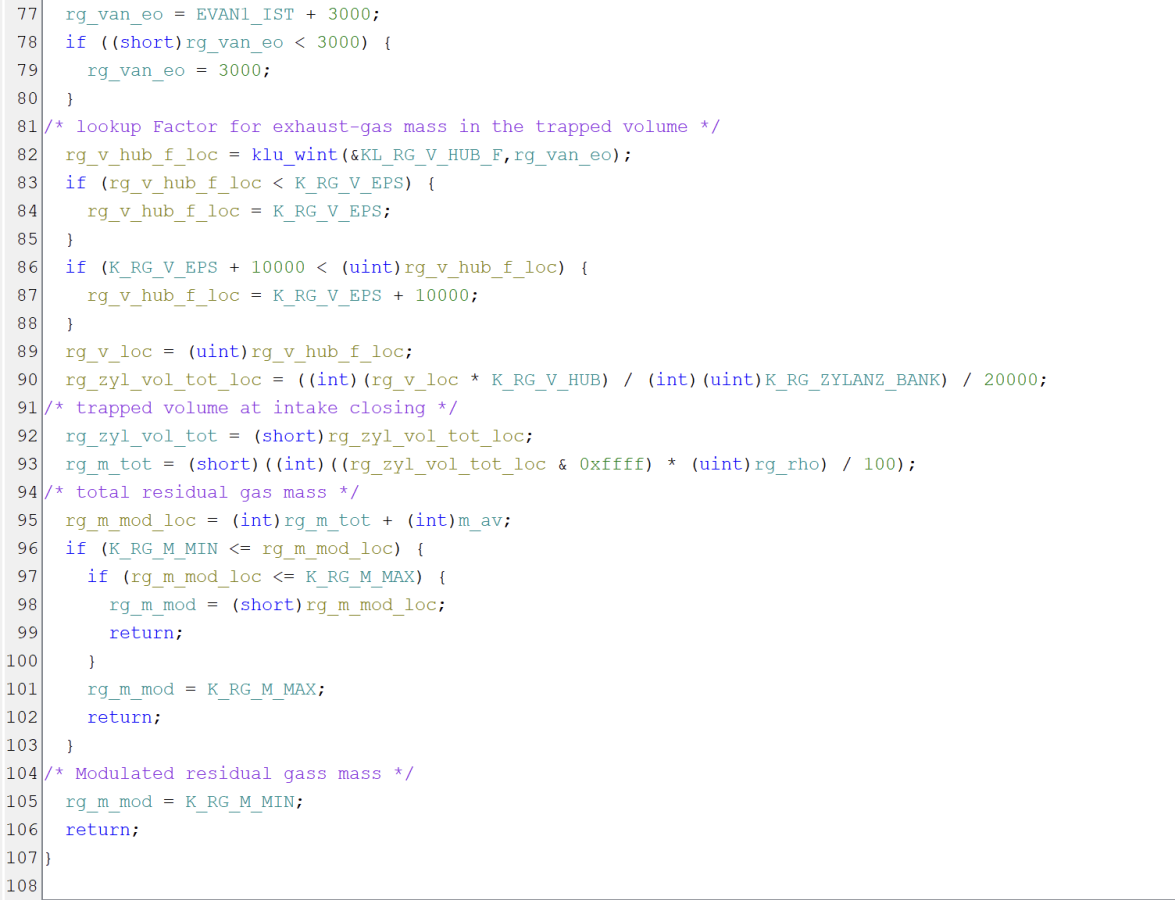

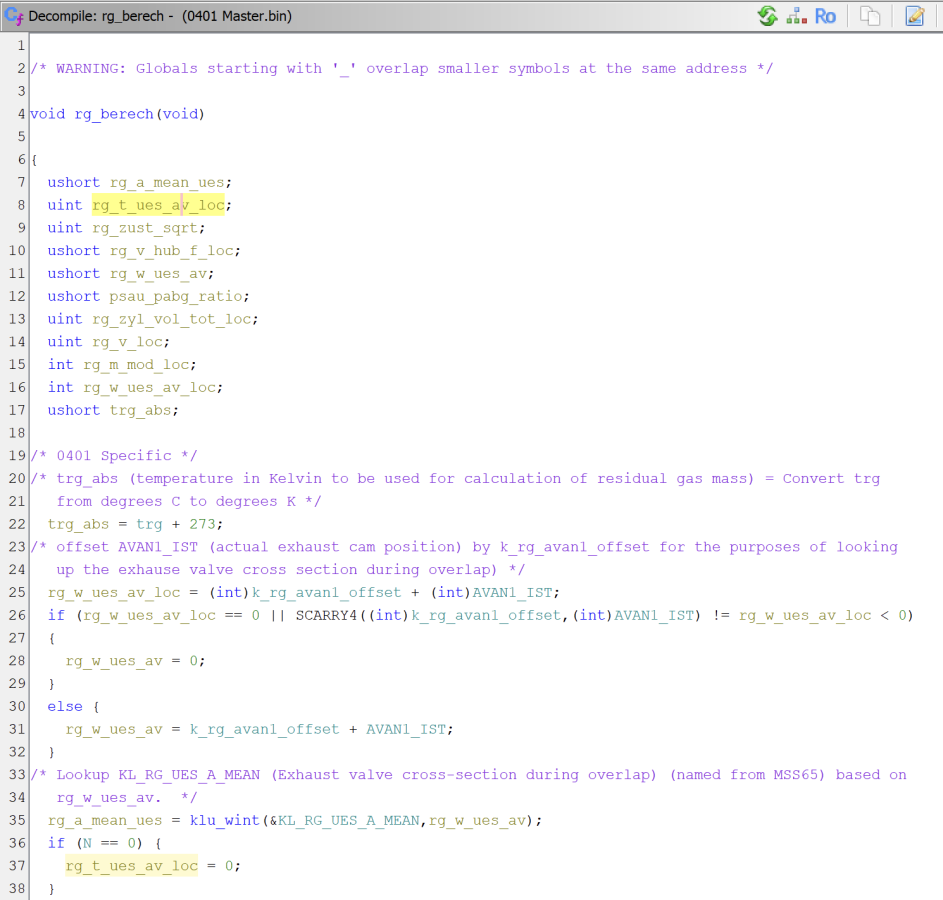

                                I've gone through rg_berech() (MSS65) and compared it to rg_m_calc() (my MSS54 disassembly) and the rg (rest-gas) calculation is effectively the same. I've been able to match everything up and identify the actual names for the maps and parameters. This confirms that my understanding of how it was working was pretty much on the money.
                                The only significant difference between the two (aside from MSS65's bank handling, and differences in base units) is that the MSS65 function includes a lookup to a table which gives a delta adjustment based on expected intake manifold pressure. This isn't included in the MSS54 function although I haven't yet figured out whether it's effectively accounted for elsewhere in the calculation path.
                                The other thing of note is that the MSS54 has an unused option to just lookup rg mass from a lookup (KF_RG_M) the equivalent lookup doesn't exist in the MSS65 code.
                                MSS54 rg_berech()
                                Click image for larger version  Name:	Screenshot 2026-01-20 at 8.10.18 PM.png Views:	32 Size:	179.9 KB ID:	340440
                                Click image for larger version  Name:	Screenshot 2026-01-20 at 8.10.25 PM.png Views:	33 Size:	221.5 KB ID:	340439
                                Click image for larger version  Name:	Screenshot 2026-01-20 at 8.10.31 PM.png Views:	33 Size:	189.6 KB ID:	340438
