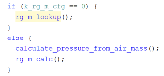

          Now the thing is, by default 0401 doesn't use this table. If we look at the segment task we see (in part):
Name:	Screenshot 2025-03-14 at 8.54.08 AM.png
          k_rg_m_cfg's (my name) value is 1 in 0401:
Name:	Screenshot 2025-03-14 at 8.55.03 AM.png
          So by default two functions are called. the second of these (what I've called rg_m_calc()) provides a calculated value for MpowerE36's m_720_3.
          And when I look through this function it is calculating a mass value based on things like intake and exhaust camshaft position, tabg (there are an entire separate set of tabg calculation functions solely for informing this function), etc.
          Now why would we need to know camshaft position and exhaust gas temperature? Because what m_720_3 is is the calculation of the mass of residual exhaust gas left in the cylinder (which varies, especially, based on cam overlap). Remember the DME intentionally recirculates some exhaust gas (particularly at certain RPM and loads) to reduce emissions and we can see this playing out in the table above (which isn't used by default, but gives us a representation of what the system is doing).
          Anyway - I have some more work to do to finish up documenting the interpretation of this function, but pleased to have figured this out and have a more concrete understanding of exactly what it is.
