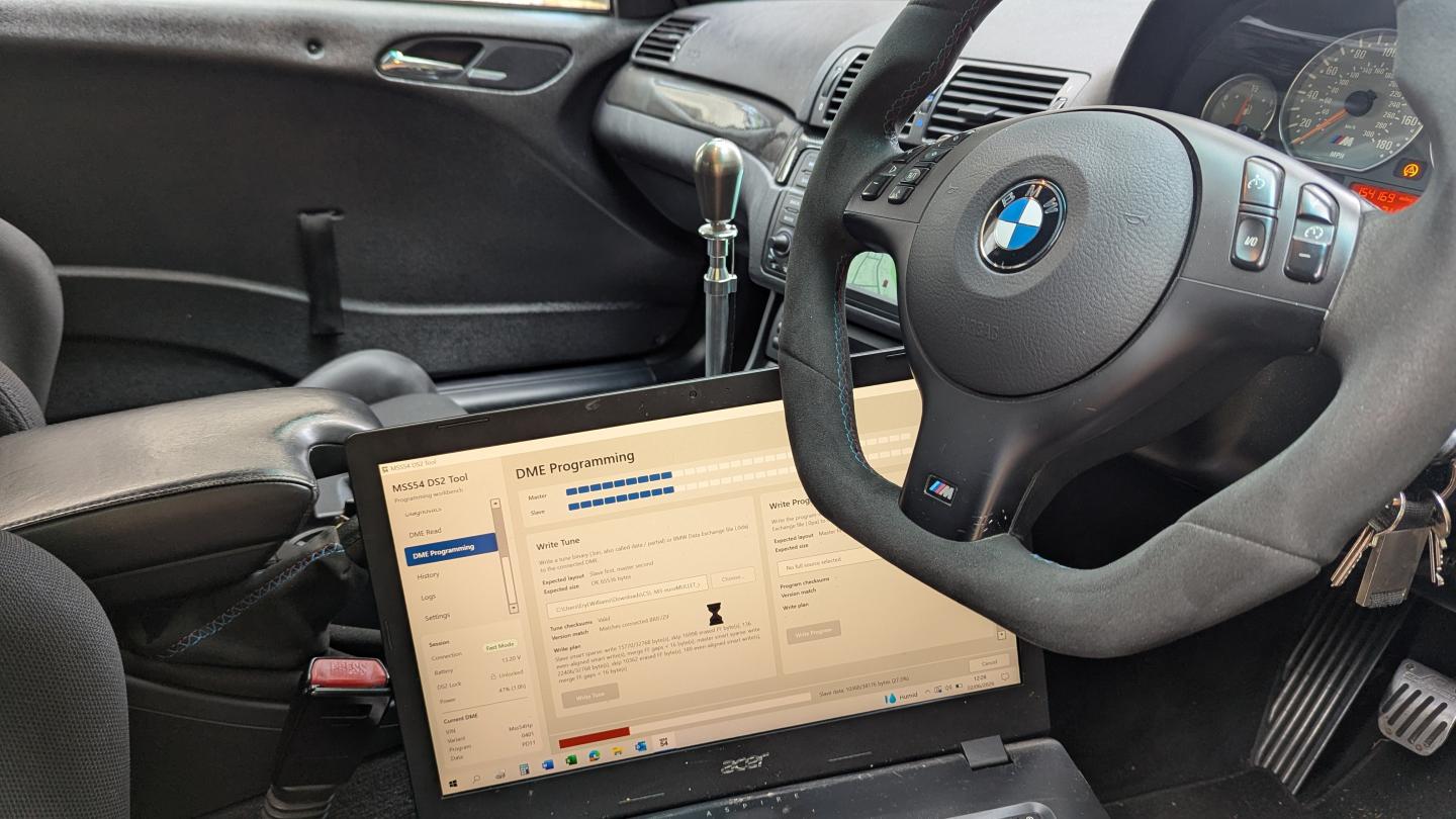

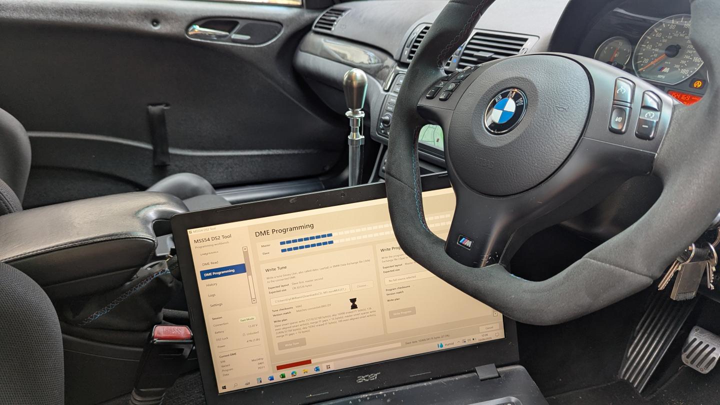

        I used your tool, which is great by the way, and Bry5on did a map for me to upload.
        Couldn't be happier, it feels like it used to and it's all working as it should.
