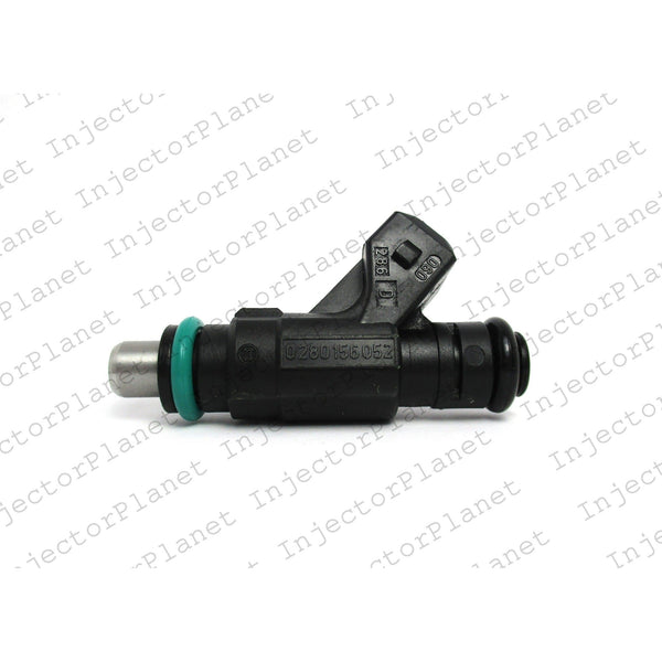

                      https://www.injectorplanet.com/produ...61b6cbd0&_ss=r. These?
                        These are the higher flow injectors I've seen recommended by other members here (I think it was EthanolTurbo?): https://polmaxracing.com/index.php/p...-m3-01-02-z3m/
                        As with any mods, will probably need to mess with stuff a bit, but for the most part, they should be plug and play.
