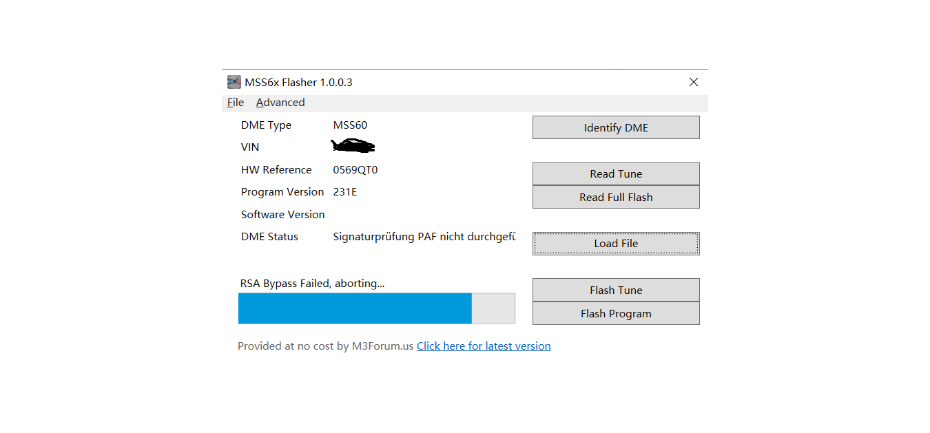

  • angli
    replied
    Can you help me analyze why I can't read the DME information?
    I read the DME info with winkfp, but I can't read the DME type with MSS 6X.
    Thanks

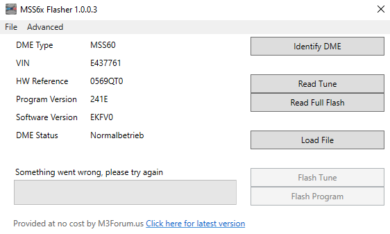

  • angli
    replied
    I need your help, I tried a lot of things but I can't recognize the DME with MSS 6X.
    My OS is windows 11, I installed Ediabus, INPA, NCS, imported MS_65.prg and 10flash.prg, INPA is working fine and I can read the AIF.
    I read the DME with MSS 6X and it says UNKNOWN! / unsuppported.
    I used inpa and winkpf to find out that my dme version is 241E.​
    Leave a comment:
