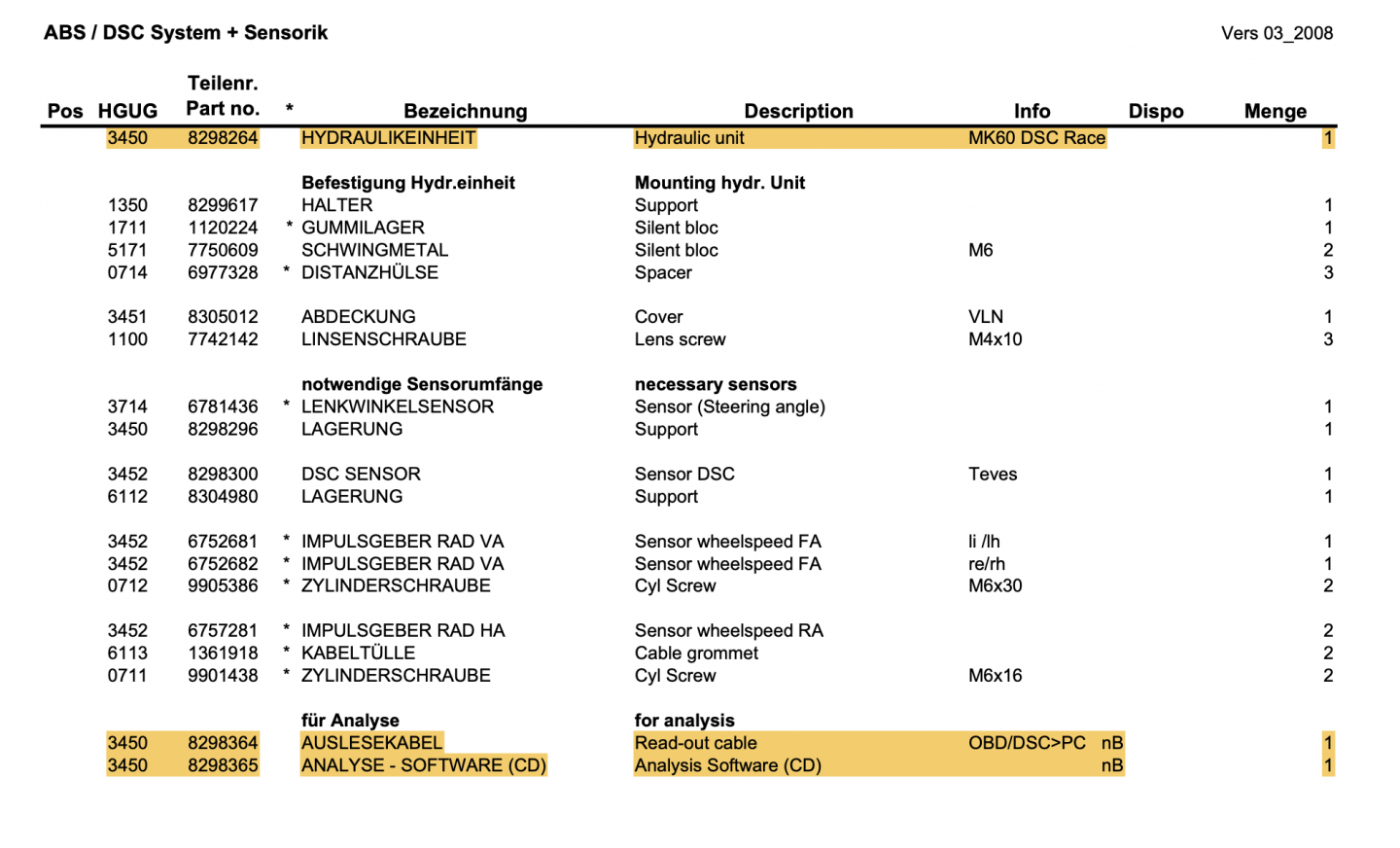

    The other thing I've always found interesting but could never find more info on is the Z4 2008 Motorsport catalog mentioning a race version of the MK60 as well as a readout cable and software

            Still unsure what “motorsport” ABS program gives you. Can you put a switch in the cabin and dial it up and down? Do you get the tuning software to make adjustments yourself?
            Spending that much money I would at least want the ability to change the program based on tires and track conditions.
              #36
              I don't know what the MK60 motorsport versions get you specifically, but the Bosch M4 Motorsport kit lets you do precisely that
              https://www.bosch-motorsport.com/med..._m4_ait_en.pdf
              Contintental has this: https://conti-engineering.com/domain...otorsport-abs/
              Apparently based on the "MK100" stability control modules. Perhaps in the past there was a listing for an MK60 variant, but I cannot find them now. Honestly at $7k for a full kit new with software support and tunability... I think that'd be well worth the expense over a $3-4k mk60 "race" kit if I were actually building a race car.
              Where things could get interesting is if the consumer variants of those newer modules can be flashed with the respecitve motorsport software without having to pay some guy in Germany a few grand to do it. Contintental RSX = MK100 (and various variants are like $60 on ebay), bosch M4 = bosch 8.1, bosch M5 = bosch 9.0. The bosch 8.1 apparently has an MPC555 CPU, so that might actually be feasible to flash even for us mere mortals if we can get the software dump.
