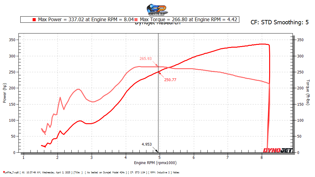

    Epic Alpha-N dyno tune
    Megan headers
    3.5" BW race
    Crappy Injen Intake
    JB Racing Flywheel
    337whp/267yq
    That is about 12 more hp! Randy fixed the dip between 4.5k to 5.5k and it feels a lot better from 3.5k to 5.5k.
    The dip between 2.5k to 4k...because of the BW race?

    This is promising, almost identical to my current build. BW race is the sections 1,2,3 correct? My only difference would be having the street/track which has a stock section 1. I'm curious where I'll fall and if I have that same low rpm dip.

      You won't have any dip with the Street/Track version that maintains section 1. Potentially, the full race version might have a touch more top end power 🙂

        to boost 2.5-4k you could experiment with exactly doubling (or close to it) the current merge distance (which would still be slightly shorter/less than the stock merge distance by looks of it) but it will likely soften 4-5k a bit as a compromise but shouldnt hurt anyting above 5k. its expensive doing custom exhausts and hard to undo , so it depends how much it bothers you for the type of use
        i am suprised nobody as brought something similar to market as a bit less of a compromise and the 6-2-1 is the superior power setup over 6-2-H/X-2 with other advantages to boot
          I am not worried about that region - track only. I might touch upper 3k a few times but usually it will be on purpose where I stay in a higher gear to deaden the torque because of a bump or tricky corner.
          The BW race is all about weight savings and top end power. I think if you move the merge back it will add unnecessary weight for those who would buy this. You certainly wouldn't put a BW race on for the sound.
            it will replace 2-3 feet of single 3.5" with 2-3 feet of dual 2.375" (or whatever it is) which will be maybe 2-3lb so doesnt sifnificantly affect the core weight saving benefit (claimed 62) as the saving is not from piping sizes but lack of cats and lack of big resonator / big muffler but i do know people would be avoiding because of the torque dip
              Yeah but 2-3lbs makes a difference in the big picture. A lb here, a lb there…it all ads up.
                1 part in a 1000 lol

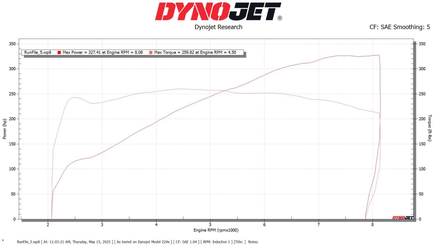

                    Build Thread:
                      EPIC Alpha N tune
                      SuperSprint Stepped headers
                      3.5" custom exhaust
                      4" custom intake with ITG filter
                      Tilton clutch/flywheel
                      Underdrive pullies
                      327WHP, 260WTRQ(#'s are SAE corrected), however this motor will end up detuned for classing purposes.

                              NIce! Swaintech coated headers?
