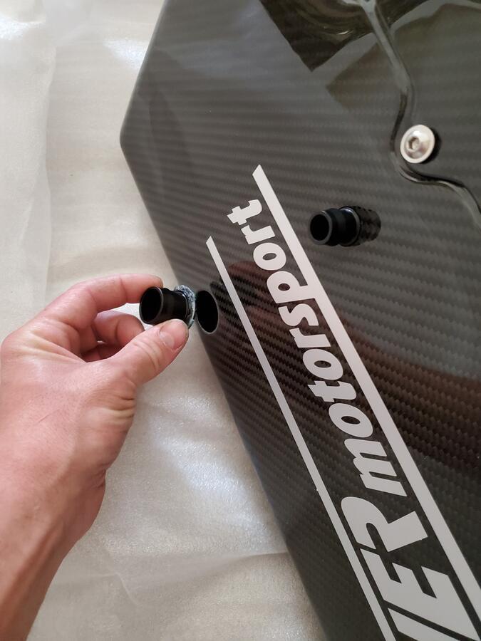

                          Mine came broken as well, gd, needed to sell this ASAP and get some $. Click image for larger version

                                Mine came broken as well, gd, needed to sell this ASAP and get some $. Click image for larger version  Name:	20200606_130655.jpg Views:	0 Size:	63.4 KB ID:	31812
                                That sucks man.
                                Same thing was happening with the Streamline airbox back when they first were coming out and they upgraded to a stronger glue. I’m guessing “you get what you pay for”. Pretty disappointing since I know you’re trying to get rid of it ASAP.
