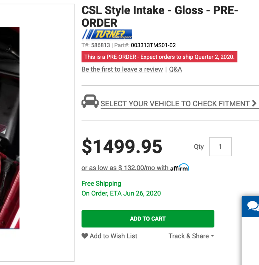

                            well, sure enough, Turner's now stating expected shipping on June 26. Hope to hear from Leighton about whether this is accurate to our orders, as it sounded like at least the first wave of boxes would ship by the end of May.
                            edit: spoke to someone at Turner through the "chat" feature in their store site. I asked if June 26 was reflective of the group buy boxes, and he said that they're shipping in batches and the first batches will hopefully ship soon. Would not comment on how soon. But he did tell me that they're coming in batches of 10-15 at a time, and mine would be 18th to ship overall. So, I'm hoping that there isn't long to wait between the first and second batches.
                            I would be really interested if someone who gets their hands on one would be able to somehow objectively compare its performance to a Karb box, but I realize that may not happen anytime soon. For all of the apparent shortcomings of the box that people are pointing out, Turner seems to claim that it flows better than the OE CSL airbox on all 6 cylinders.
