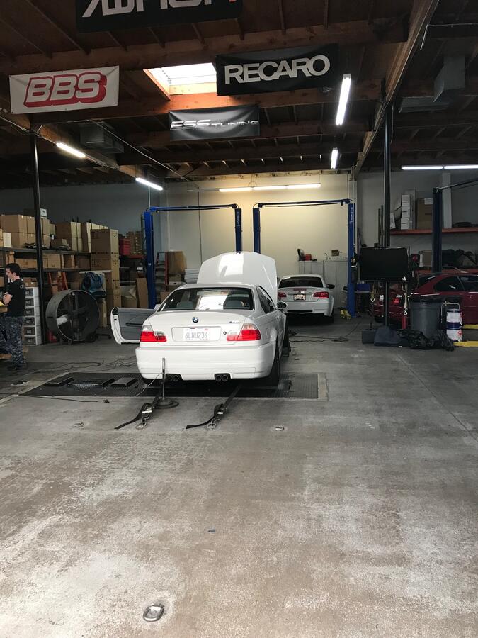

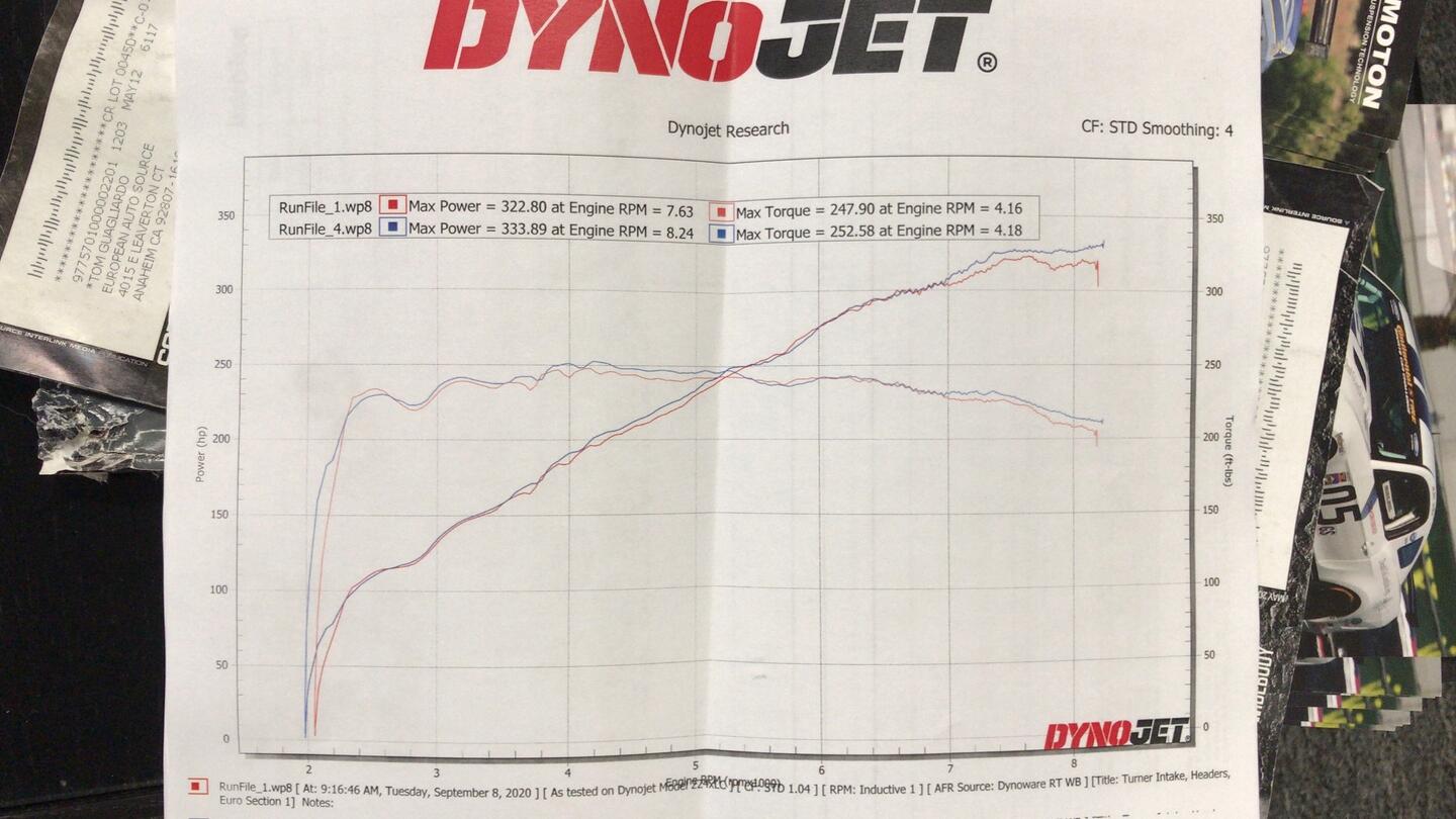

        I was able to get my car on the dyno today at EAS to have it tuned by Hassan. All I can say is WOW - it is a night and day difference from the first tune I had! I wish I could get a refund on the $340 I wasted on the first one; for anyone who is on the fence about going with HTE, do yourself a favor and bite the bullet. My initial tune netted 322whp; after Hassan got his hands on it, I'm now at 334whp!

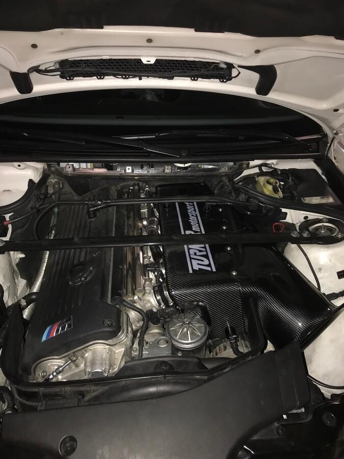

        While I'm still experiencing fitment issues with the airbox itself (hopefully Turner will present a solution soon as I still can't run the cabin filter housing even with their bracket), I am very pleased with the CSL airbox noises and performance overall. Time to open up the exhaust next!

          T-Rex Im also running the V1 of the box, and im assuming I have all the woes everyone has. I'll be diligently checking, I think the most worrisome is the cabin filter housing. If and when Turner provides a solution who do we get in contact with, is there someone I can reach out to now?
          BTW amazing numbers man and HTE is the truth, hopefully I dyno soon as well. Congrats.
            We have our V2 updated box's coming that will solve the cabin filter issue and the other issues that some people have had, if you have any fitment issues feel free to our customer service department and they can help you with a exchange once the V2's arrive.
