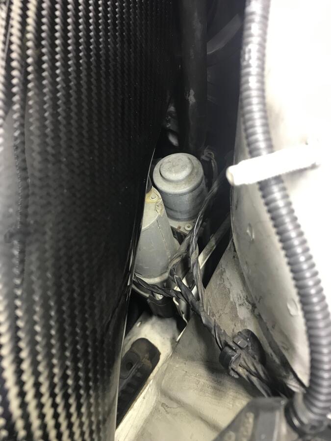

                            I'm also having clearance issues on the fender; can anyone tell me what the metal cylinders are in this photo that sit directly under the airbox? I'm considering relocating them to gain some clearance.

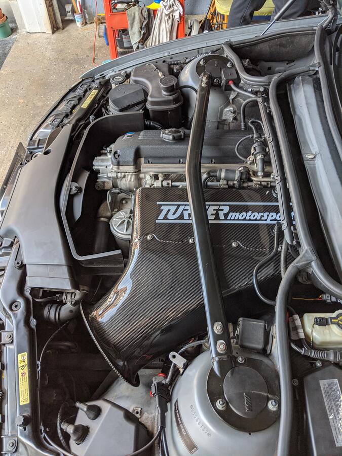

                              Finished the setup this past weekend. Wasn't easy for a novice wrencher like me. Had a lot of help from my local E46 M3 Gruppe in Toronto, especially with wiring.
                              Toughest part was all the small adjustments to make sure it fit well and not scratching anything. The hoses are super hard to get on. The plastic is very stiff on the connectors and it was worried using too much force would break the epoxy. Patience and using oil to soften the rubber washers helped a lot.
                              Forgot about the turner fix to lower the box so that it doesn't touch the strut bar or rub ever so slightly on the hood lining. I used washers for the strut bar to add a few more millimetres which is now more acceptable of a clearance.
                              Canned tune from HassanEido at HTE PERFORMANCE with CSL map and some tweaks. My car had an awful tune before which was slower than stock. It's night and day now, pulls all the way to redline, I've banged off the rev limiter which never happened before. I'll be at the Dyno this week for final tuning and tweaks. Long road to get here but getting this mod done was a bucket list thing. The car was always fun, now it's a whole new thing, easily the best mod for this car bar none IMO.
