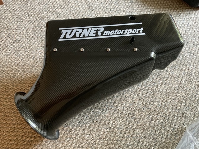

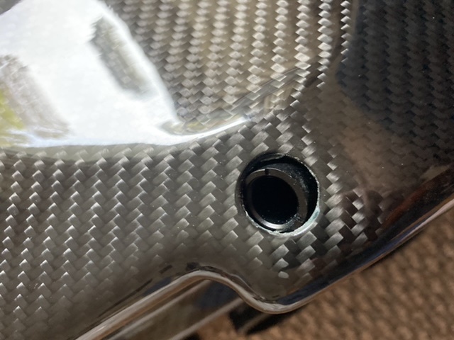

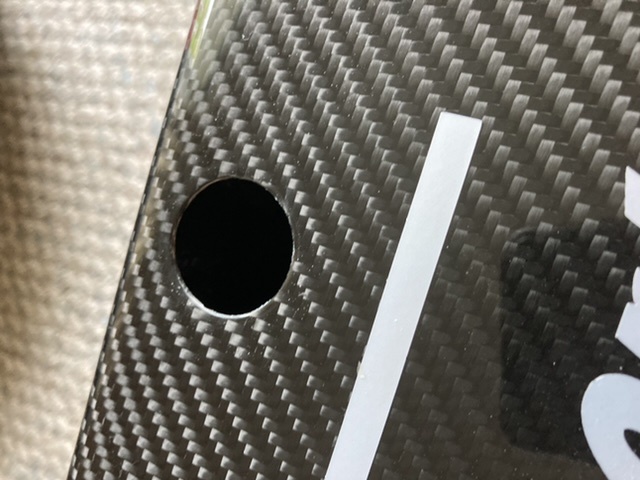

                          Ok I received my box and it looks like mine was damaged during shipping. I am super unlucky with this shit...
                          the packing was terrible with almost zero padding. Top breather connector and one in the bottom are pushed in.

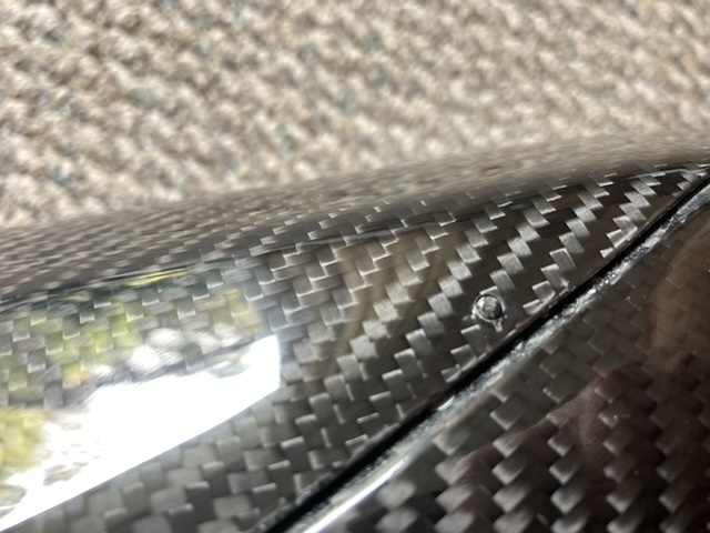

                          Also in the bottom those pins that hold two parts together are sticking out like they pushed through the carbon and made a tear

                            The previous one pictured on the last page had the bottom port knocked out of the box, too. You can call Turner and see what they suggest. I would think the two ports can be bonded back using a strong, two-part bonding epoxy or adhesive, perhaps something like JB-Weld. The small pin in the back is a locating pin and sticks out by design.

                              That sucks. What does the inside of the box look like where the connectors were pushed in?
                                Thank you. Well yep I know I can glue it back, but that is a 1k+ part we are talking about... turner... FCP packs an oil kit better than this.
