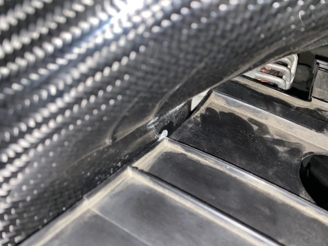

                  Got mine installed today! First things first: driving this thing at WOT with the top down through a mountain tunnel is f***ing bonks. 10/10 on that part.
                  Comments on fitment:
                  1. The fan shroud rubs against it at the front. I was very foolish and thought I could stick a few layers of shop towel pinned between the shroud and box at the contact point and go for my first drive and it'd be fine. I was wrong. Damage done. Is there anything I can do to repair this?

                      Problem # 3
                      I had on my Karb. box as well. I had to file down the locking tabs on the shutoff valve to get it to seat on the box properly.

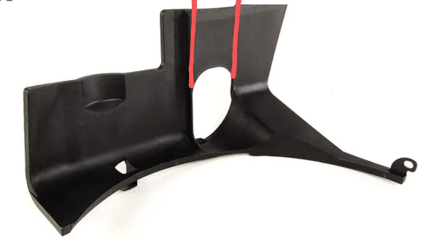

                      Problem # 1
                      Also you have to remove the driver's side splash shield for snorkel clearance on a Karb. box. Sounds like it also needs to come off for the
                      Turner box. You will either have to remove your top radiator hose or cut it off. I made one cut with a small handheld saw and it came off pretty easily and I didn't ruin the splash shield. But the correct way is to remove the top radiator hose.

                          Had a similar problem to 2 and 5 on my Karbonius box. Like Cubieman, I filed down my connectors until they snapped in like they did on the regular airbox
                          For 4, can you bend the bracket a bit to get the rubber grommet on?
                          And yeah, CSLs don't have the driver's side shroud because of clearance with the snorkel. I had cut mine along these lines a while back and could get it on and off without removing the top radiator hose.

                            Awesome, glad to hear that these aren't issues unique to the Turner box. Wish I'd realized ahead of time that the stupid shroud's not supposed to be there on a CSL, d'oh.
                            And yeah I did bend the bracket down to be able to hook the grommet on, but still not much space as the arm is pretty short. So I ziptied it lol.
