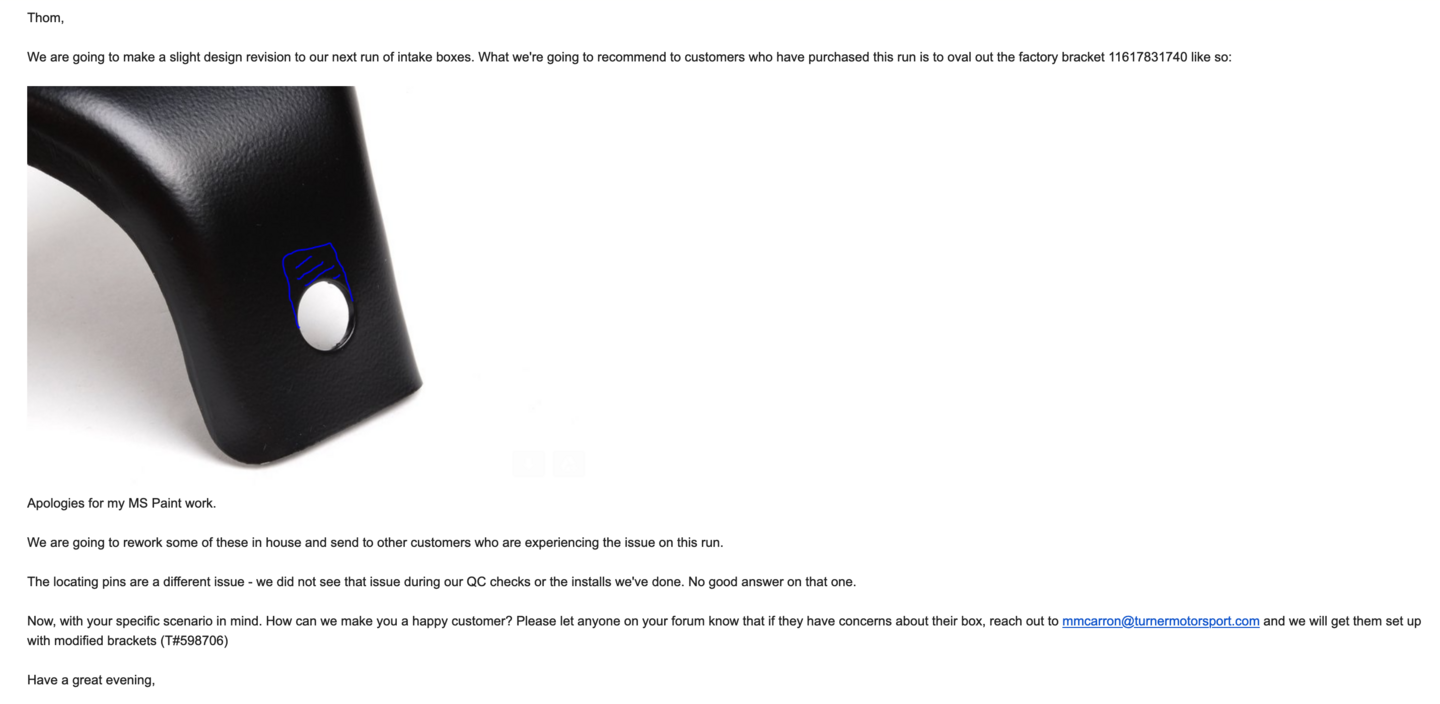

Fascinating news from TMS about the cabin air filter issue, see attached photo.
Glad we were able to help them catch this! I highly recommend that anyone who bought a TMS box get in touch with Matt McCarron to get the modified bracket, and to remove your cabin air filter housing until you get it.
I'm asking them to replace my airbox, since the cosmetic damage that's been done at this point is substantial. Will let you all know what happens.

Further update: they immediately agreed to replace my airbox with a new one. They'll be putting out a quick-installation pdf tomorrow describing how the mounting bracket should be modified, and will be distributing it to all who have already purchased the airbox. They're also willing to provide pre-modified brackets to all who have purchased.
Very happy with their customer service.
