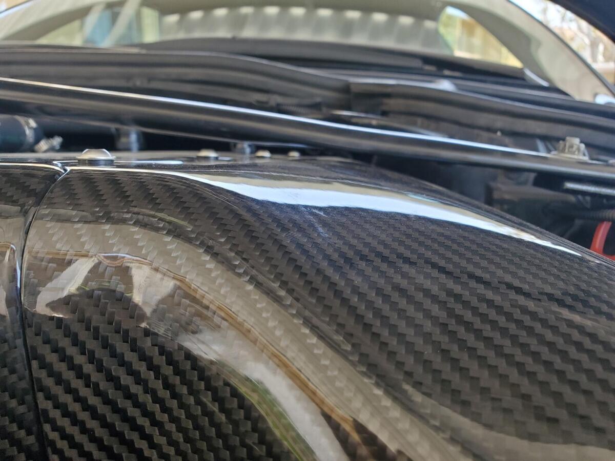

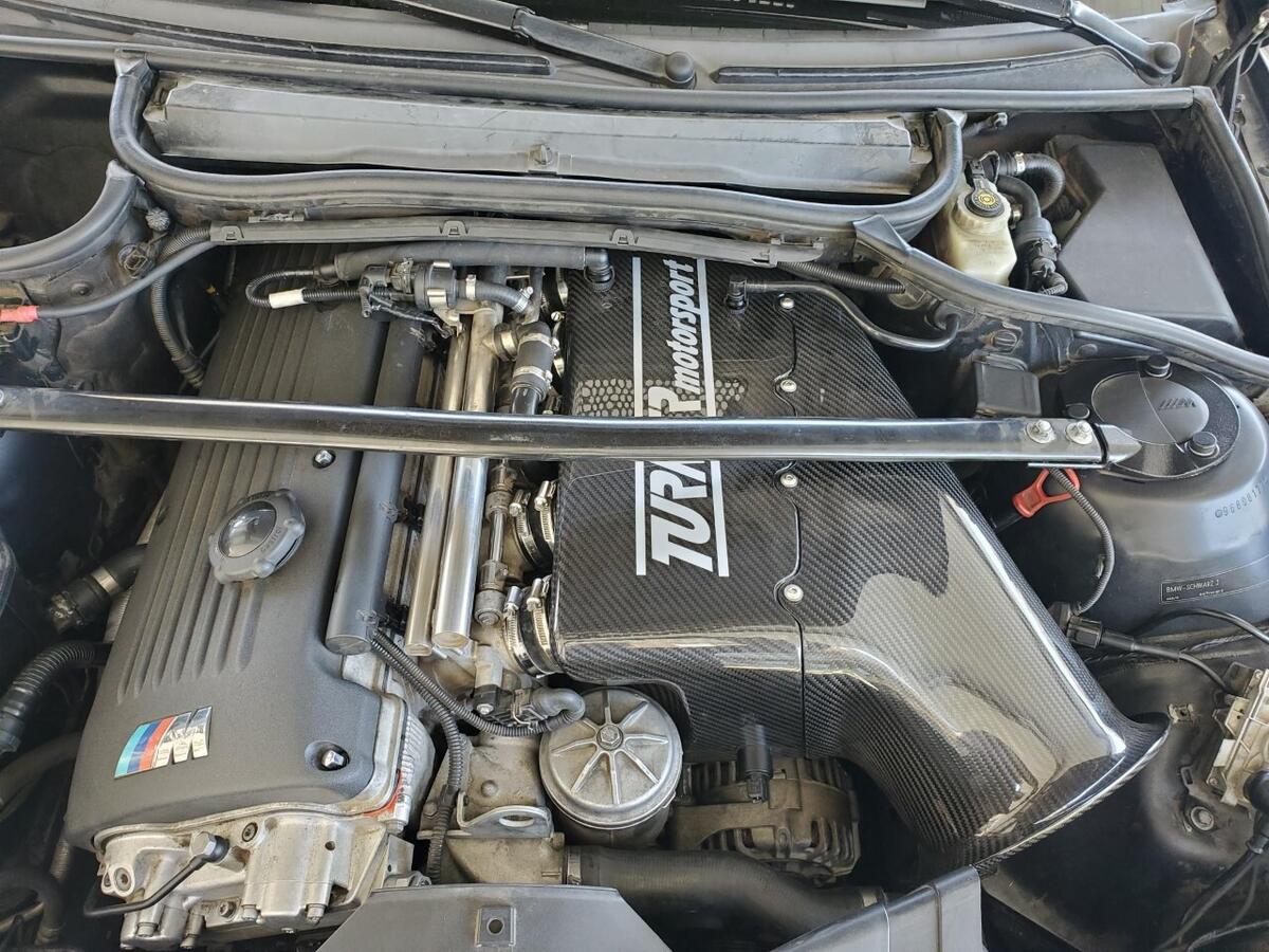

                        Using the stock one, (mine is a V2 box), good clearance. Dipstick was bent manually, tons of trial and error using 2 people to bend without kinking it. Overall, happy with the box, no issues (knock on wood).
