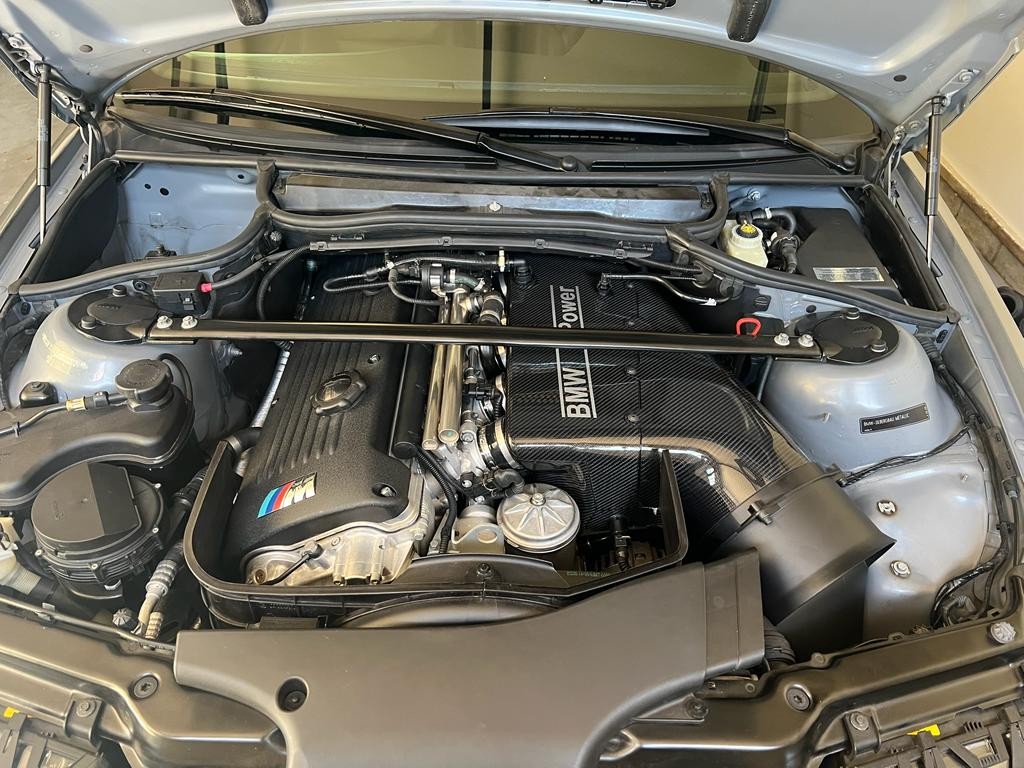

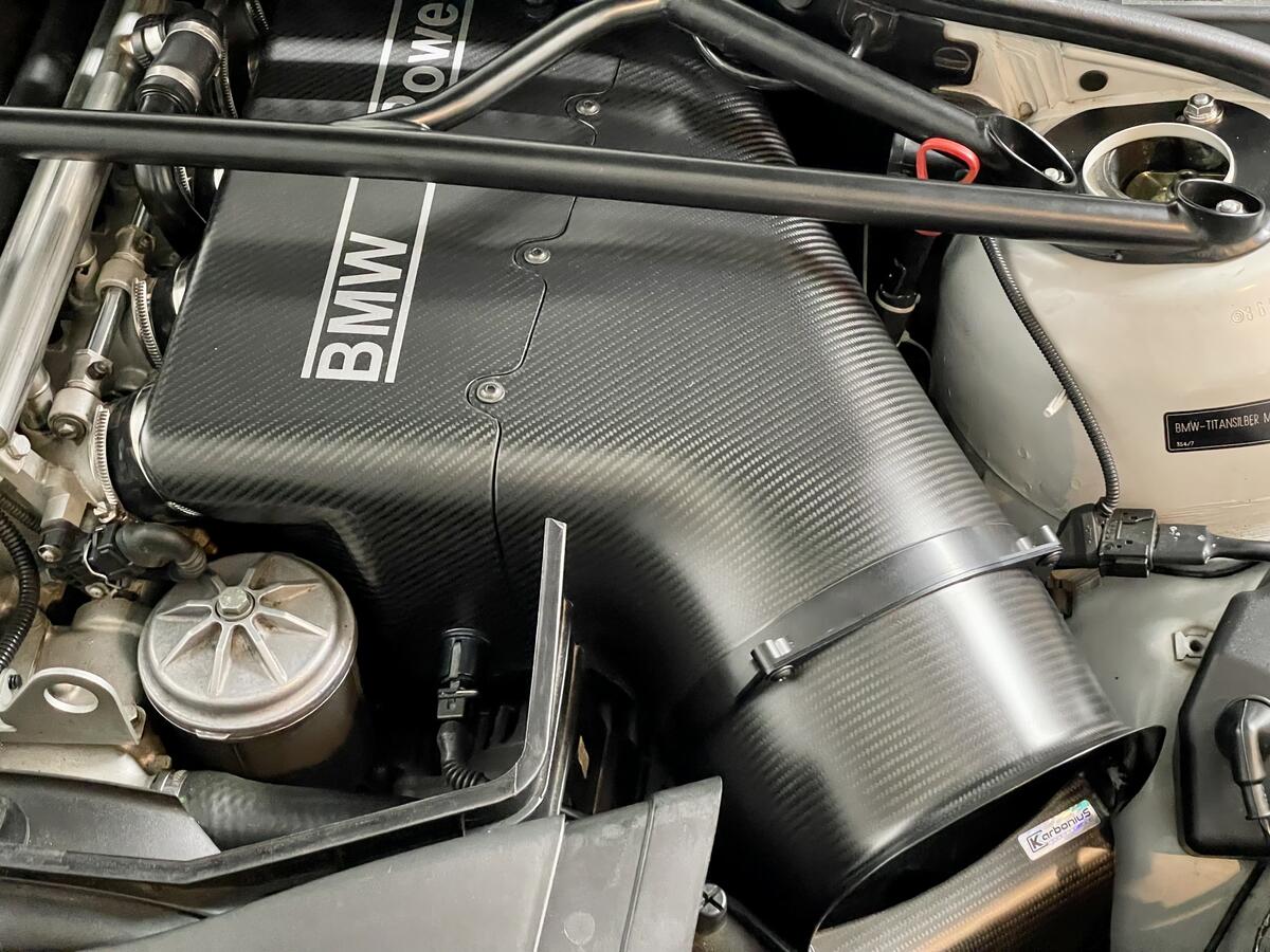

        Looks great! I hope the repairs hold up. I started down that road but decided to return the TMS box and spend the extra for a Karbonius box with the snorkel. Click image for larger version
        Exact same thing I ended up doing. That matte finish looks awesome!

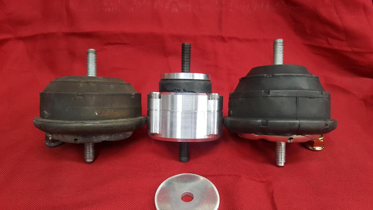

            Originally posted by Tbird88tbo View Post
Name:	m3 engine mounts.jpg
ID:	129810 I have had the TMS v2 box installed for about 6 months now on my daily M3. To say that I haven't had any issues with the box would be wrong. The biggest problem I have with mine is that once proper clearance is achieved between the box and the strut bar it becomes impossible to remove / install the trumpet without loosening the engine mounts and jacking up the engine. I've put roughly 6k miles on it and I haven't had any issues with the pins or the bungs that the various air tubes connect to. About 4 months ago I did new rod bearings and I decided to install some new mounts at the same time. I wanted something that would be oe plus so I went with the 034Motorsports mounts that ECS sells. Long story short they were way taller then stock and made the intake contact the hood liner. I ended up sending them back and getting a set of solid rubber street mounts from Morehead Speed Works. Granted they don't dampen vibration as much as a stock mount but its only a slightly noticeable difference (as a side note on the MSW mounts they come with a removable spacer to lower the mounting point by 5mm. Their smaller profile also adds extra space for future headers). Aesthetically I like the look of the TMS intake over the other intakes on the market. If they continue to improve their design I think it will be a great product for the price point but currently they still have a ways to go.
            Pictured from left to right are the sagged out stock mount, the msw mount with the 5mm spacer removed, and the new 034Motorsports mount.
            I had an issue with the box contacting my microfilter tray. Threw in some MSW mounts and problem solved. I did take their advice on trans mounts and switched those as well. NVH is significantly higher for the average person but it's not unbearable like a typical poly mount would be.
