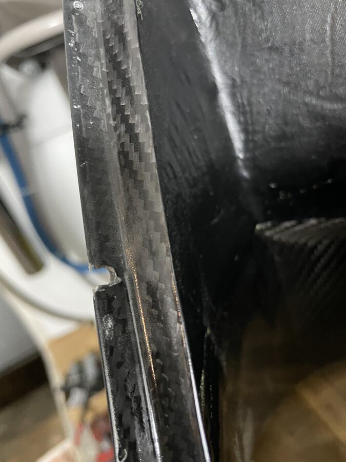

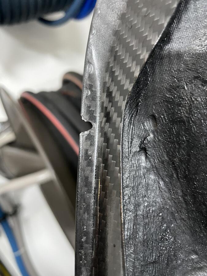

                        I know this was a long time ago but I repaired both the sheared out pin and the bell damage like this on a v1 box. Hasn't been installed so I don't know if the fixes will hold but I'll figure something else out if they don't hold.
                        For the pins, I found an appropriate sized allen key, and cut off a few pieces and epoxied them into the holes from the manufacturer.
                        For the broken bell tab, I chopped some cf weave and mixed it into jb weld. Taped the hole off from the glossy side and packed it in with cf and jb weld and then drilled the appropriate sized hole once it was cured.
                        Also reinforced all the ports with jb weld.

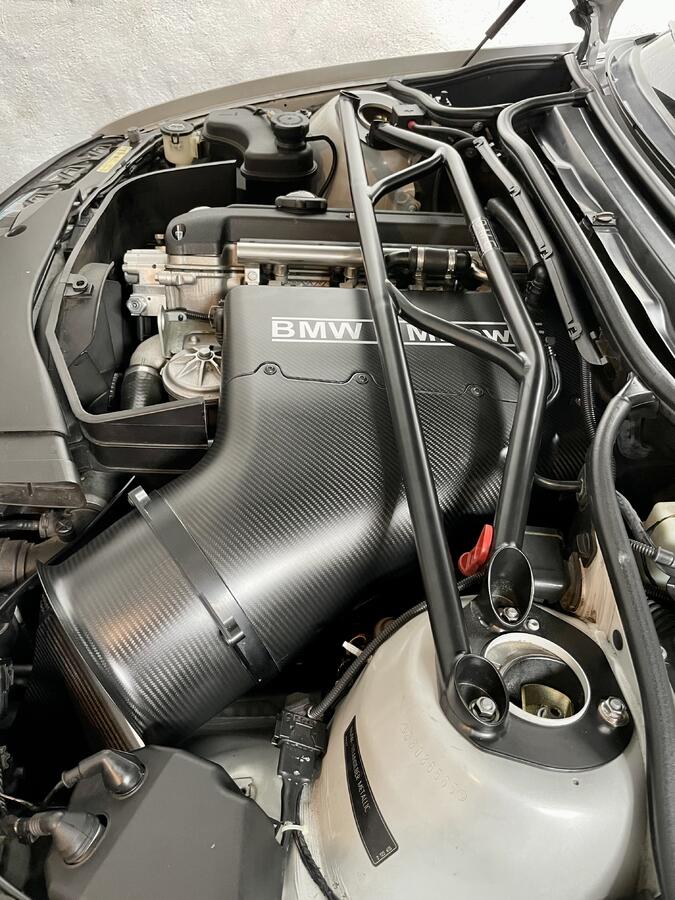

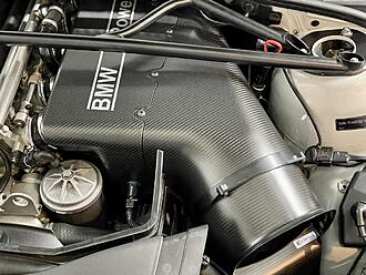

                          Looks great! I hope the repairs hold up. I started down that road but decided to return the TMS box and spend the extra for a Karbonius box with the snorkel. Click image for larger version
                            Nice, welcome to the matte karb club.
