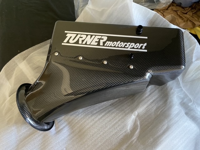

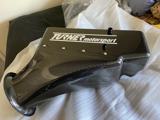

                It’s here, and it’s gorgeous! Mine came with the TMS sticker already on it, which is annoying. No defects as far as my eye can see.
                Can anyone suggest the best way to get the TMS sticker off without risking any scuffing/damage to the finish? I've never owned anything like this so I don't know what products/tools play nice with the finish.

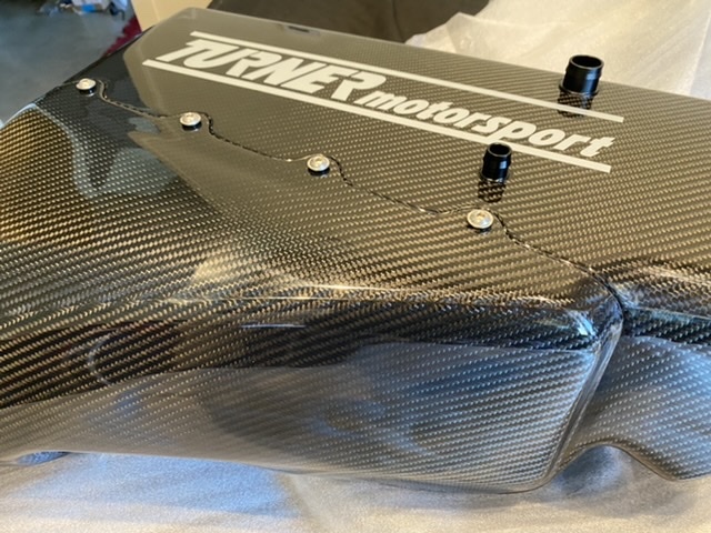

                  Also, noticing two extra threaded holes on the bottom of the box (see Turner's stock photo here: https://3a663eb0fef48c6d2d60-a88f8eb...4242_x800.webp)
                  There are the two threaded holes that are far a part which is where the mounting grommets thread in to attach the box to the support bracket underneath, like the stock airbox. But what are the other two little holes (the ones close together in the picture) for? Are they supposed to mount to something? They thread straight through into the box itself, so, they need to be used for something else you'll have a big vacuum leak...
                  I see that on stock photos of the Karb box there's a little bracket attached there (https://karbonius.net/wp-content/upl.../E46AD03_3.jpg)... but the Turner box just has the holes, and there were no other parts advertised as needed for installation other than CCV hose, throttle boots, shutoff valve, MAP solution and IAT. Am I missing something?

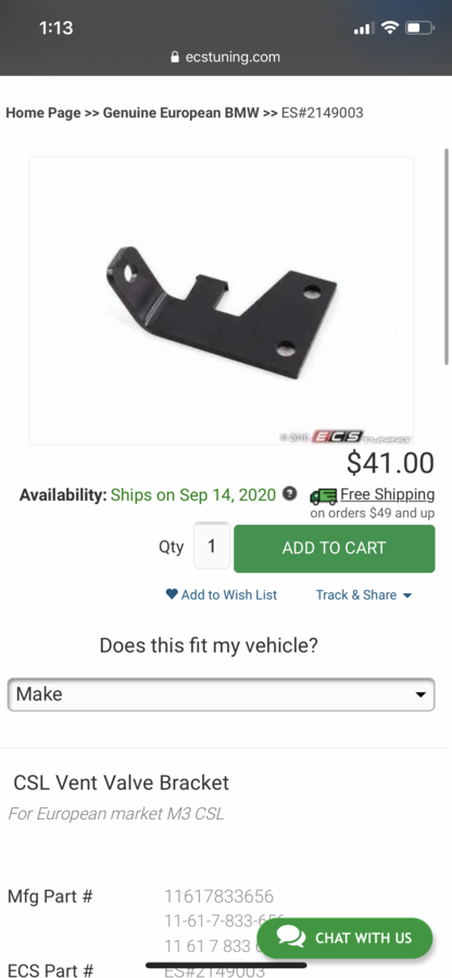

                    This?

                    Budget CSL MAP Conversion
                      #70
                      This?
                      Click image for larger version  Name:	6AAC11BD-F15D-4B54-9E4B-3F74A3D0510D.png Views:	0 Size:	111.8 KB ID:	28959
                      Ah nuts, yeah that's it. It's the thing that the valve attaches to underneath, makes sense. Wish it had been offered with the "installation package", since it's needed for installation. RIP lol ECS is sold out until September, but it looks like Schmiedmann might be able to get it quickly..
