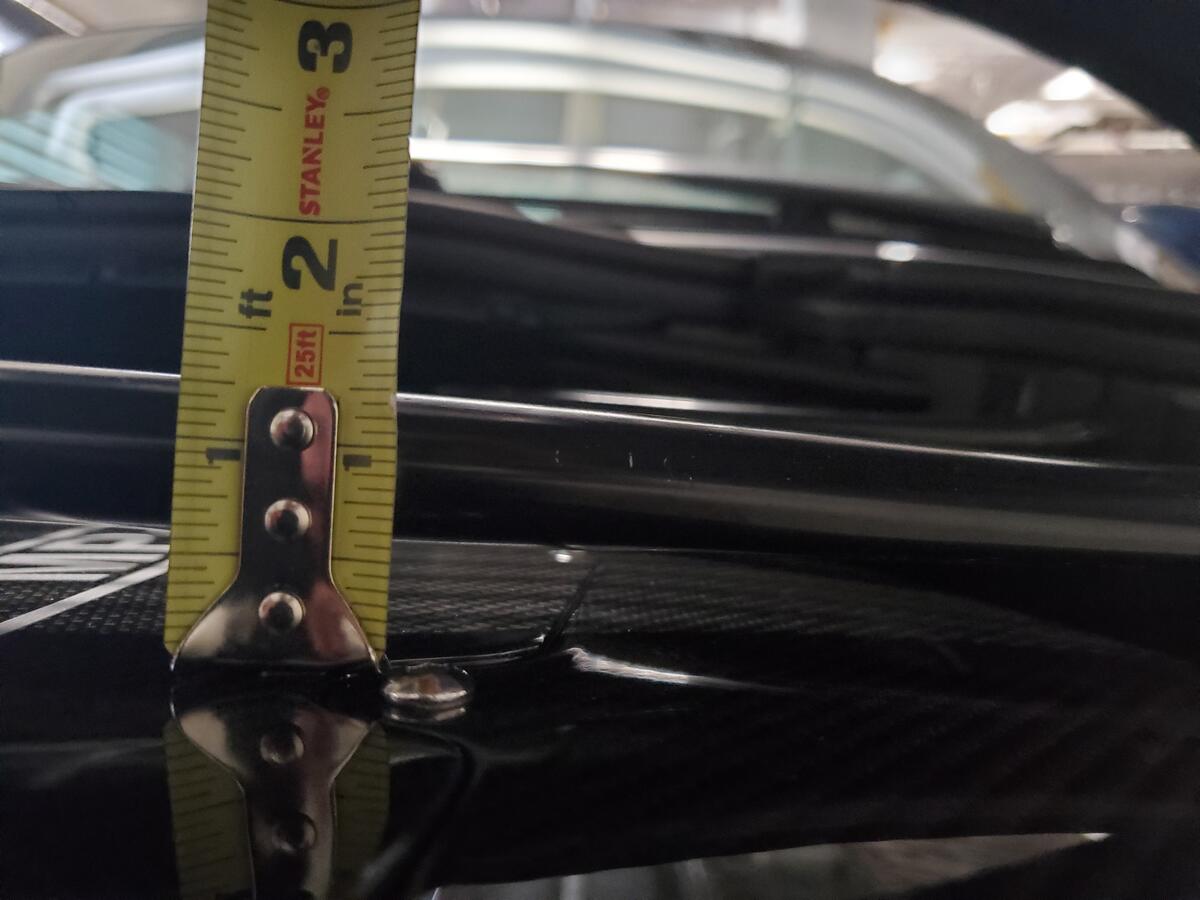

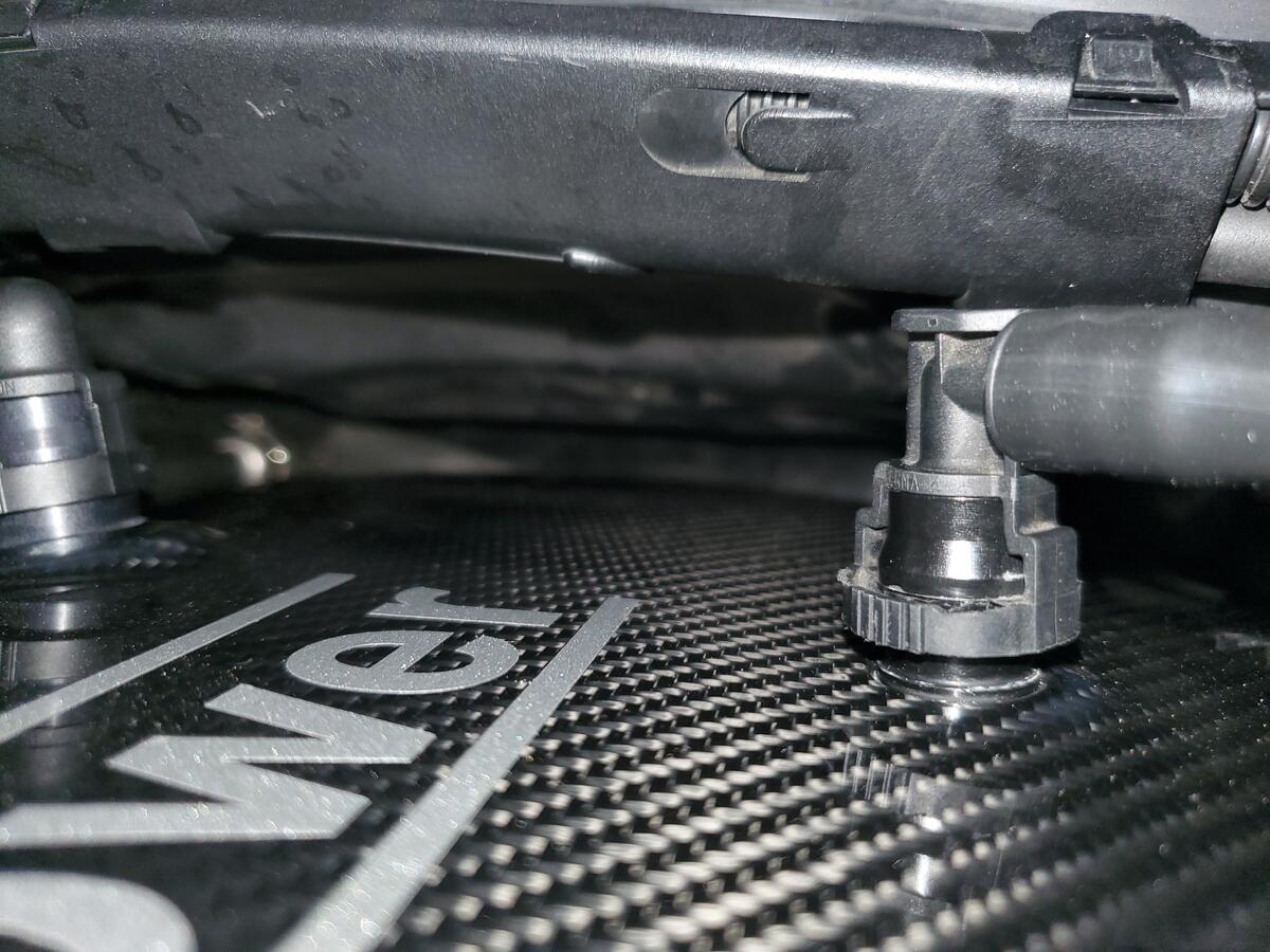

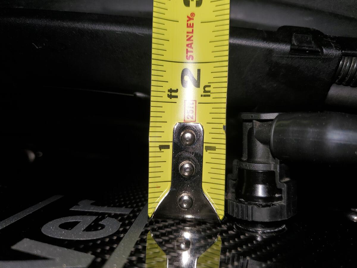

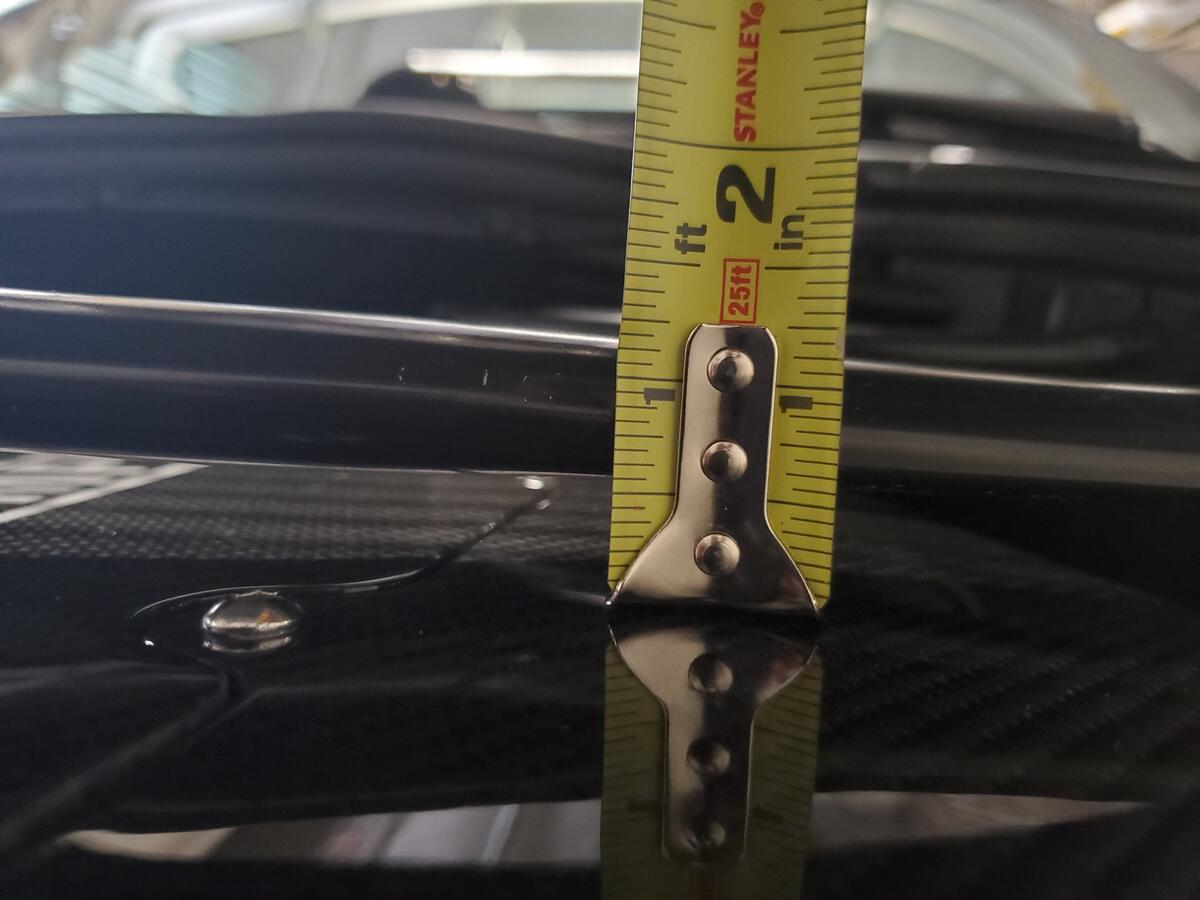

                          This is what the clearance looks like with my Karbonius box.

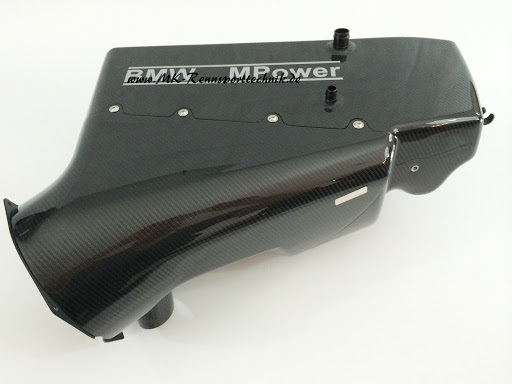

                            Seems like the original CSL design has a dip towards the rear of the box which would provide clearance for the cabin filter housing.
