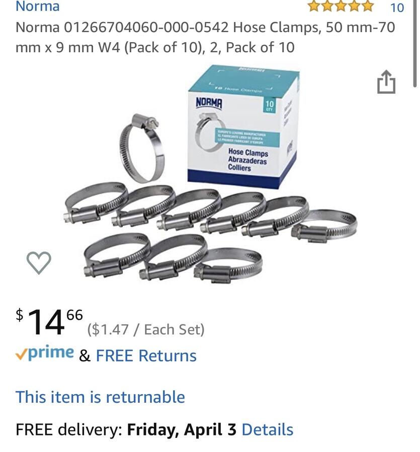

    HAHA dude.. I feel this. I had to replace the intake cam position sensor not too long ago. So the IM has to come off, and those fucking clamps ruined my life for like... Way longer than I'd like to admit.
    What's the hot ticket for aftermarket replacements?
    I got mine on amazon. I was going to get the ones from the e9x intake since some say they fit perfect. But a few of my friends had problems bc they barely catch (clamp had to be all the way open). I would just get a set for the tb side and oem on the manifold side since those usually don’t come off.
