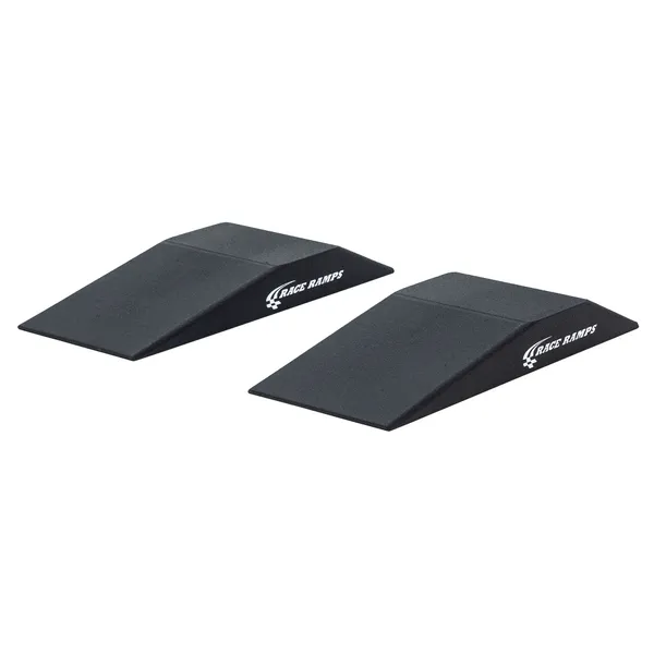

      A set of two Roll-Ups will give you additional clearance for working under your low-to-the-ground car. Additionally, Roll-Ups can raise the front or rear of your car enough to slide in most standard floor jacks where they otherwise could not fit.

        Similar to the last post, I bought two pairs of these inexpensive ramps and can reach both front & rear center jack points with a 2.5T low profile jack. My ride height is around 13.5"f/13.2"r. The front is very tight, but I can get it with just this.
            Sorry but plastic (or carbon fiber) ramps make me nervous not to trust them.
                      Been using various versions of plastic ramps for...20 years? They're a lot cheaper now, so that's nice. Never seen a single set fail. Probably half the field uses them when I did the drift thing for about 10yrs. Not much risk involved.

                          I would not get under a car with plastic ramps but I would have no issue using them to lift the car onto jack stands.
