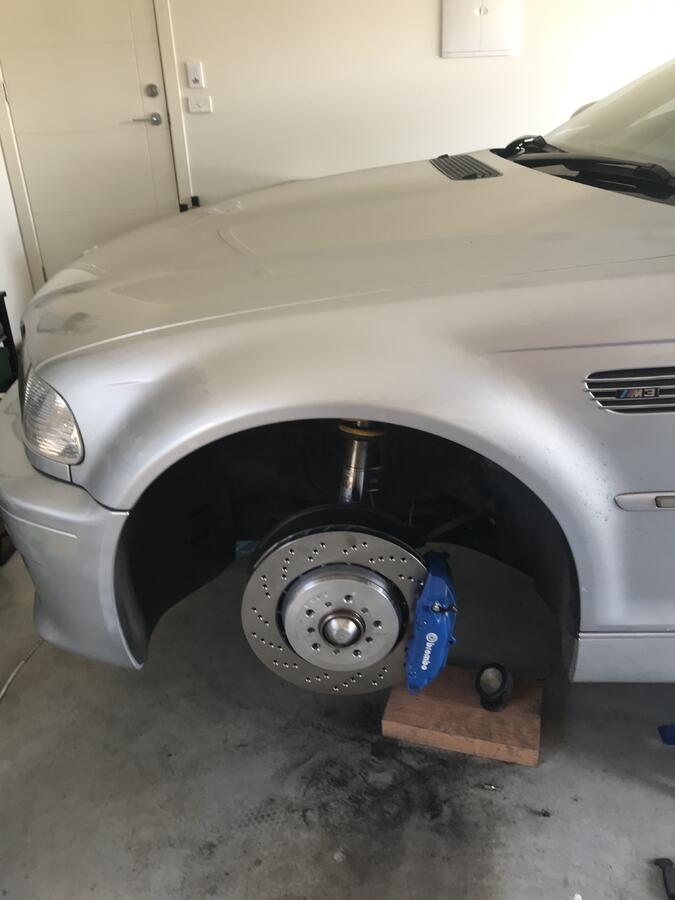

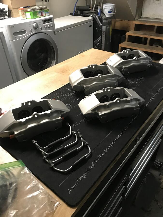

            Are those new calipers? Where did you source them from?
              No sir, got them from DC porsche recyclers.. They were black, that was just about an hour a piece in the blast cabinet w/ glass beads.

                    Do yall suggest rebuilding calipers before paint?? I am leaning towards yes to avoid any and all possibilities of brake fluid on the new paint.. I am slightly concerned about cutting the tape around brand new seals when taping them off..
