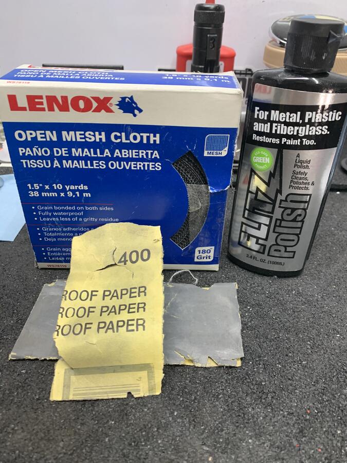

          If you are talking about these metal pins just use a knife and scratch most of it off then use some sand cloth to sand them down. You can use some 400 grit sand paper and some polish to make them shine like chrome if you want to go that route.

          Thanks! I try a razor blade and some sand cloth...maybe even a wire brush on the Dremel. Acetone was another option, but not sure I want to risk it getting on any other part of the caliper.
            #95
            Razor blades and sand cloth worked great for removing the factory powder coating. I did try using a Dremel with the wire wheel bits but it ate them up fast and it was hard to get them in there.

                    Best method and tool to get is a sand blaster tool with aluminum oxide media. While sandpaper may work, it fails in several areas. It doesn't give the substrate the proper 'tooth' to bite into and you can't get into all the nooks and crannies with sandpaper.
                    There are lots of affordable blasting options out there - even from Harbor Freight - that provide excellent results. Of course if you have the money to spend, a proper blast cabinet is the ideal solution.
                      It was in reference to this question. The pad pins not the entire caliper, that would take forever and not be very efficient. See post #89.
                      Anybody know the best way to remove powder coat? My metal pins weren’t masked off and I want to remove it before installing.
                      Evolve Eventuri
                        Sorry, my mistake! Sandpaper would be more than OK for that.
