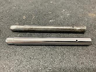

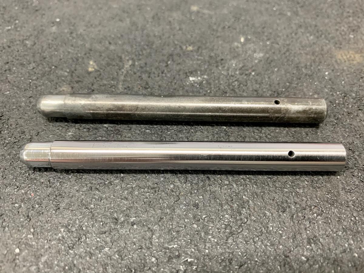

              Yeah, I wondered about paint on the pins, but they had plenty of red on them when I bought the calipers, so I figured it would not cause a problem. We shall see.
              Jesse
              We have now seen. Best to heed Tyler's warning about the pins. Do not paint them. Best to go with bare metal and lubricated, as he advised.
              It is also a good idea to lube the top of the pad where the spring clip rides...

                  We have now seen. Best to heed Tyler's warning about the pins. Do not paint them. Best to go with bare metal and lubricated, as he advised. It is also a good idea to lube the top of the pad where the spring clip rides.
                  I agree, just polish them up a bit then use some lube when installing.

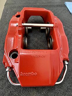

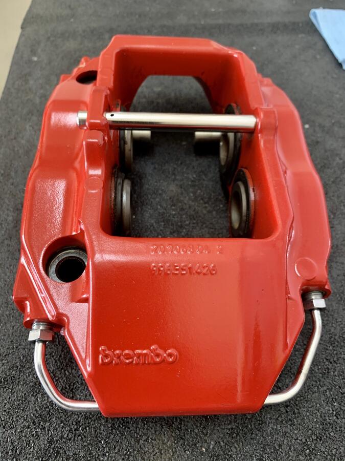

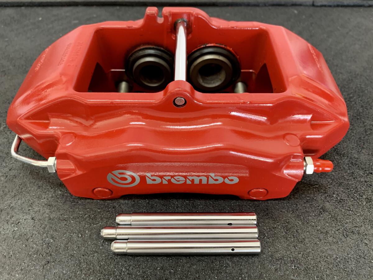

                    Yes, I lube those pins where the spring clip meets it, but we were actually talking about the little pins that the pads sit and ride on. See the picture i inserted into the DIY in post 1 about prepping for paint.

                            Anybody know the best way to remove powder coat? My metal pins weren’t masked off and I want to remove it before installing.
                              #89
                              If you are talking about these metal pins just use a knife and scratch most of it off then use some sand cloth to sand them down. You can use some 400 grit sand paper and some polish to make them shine like chrome if you want to go that route.

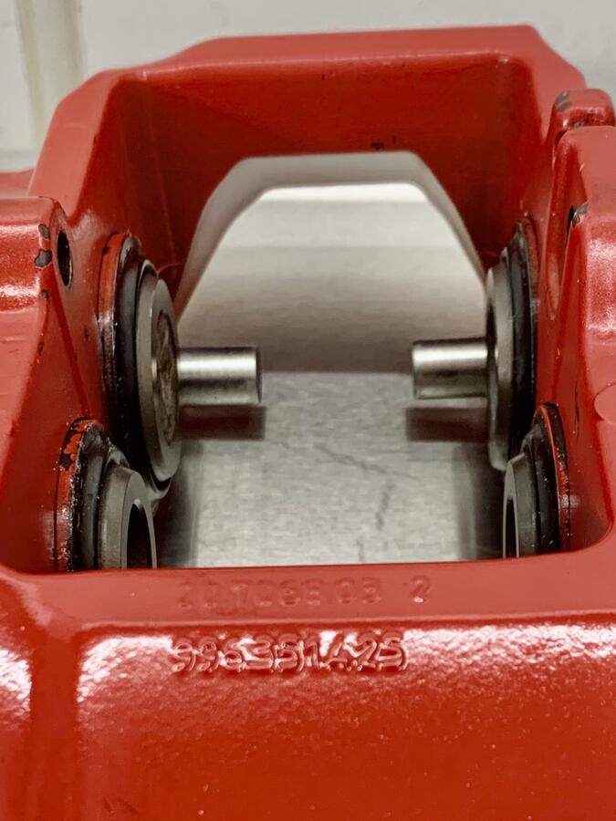

                                I finally got around to install the rear Porsche calipers using the CM brackets. Here was my take on them.
                                a). The dowel pins that hold the pads in place (they're about 10mm wide) were ridiculously close to the rotor - like less than a millimeter. So after scratching my head for a bit making sure I did everything right I ended up getting advice from Tbonem3 to grind them down. Which is exactly what I did. After about a minute or two with a grinder, they fit perfectly.
